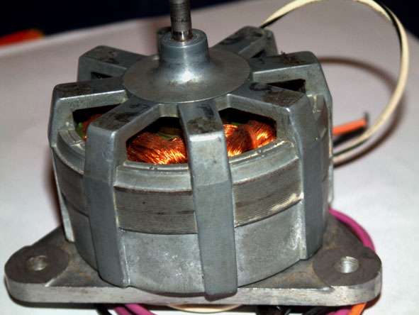

I got one that run with 720RPM with 50V AC but the torque is a bit low to be used as a turntable motor.
Mikewong said:... but the torque is a bit low to be used as a turntable motor.
So long as it can keep the platter going round you don't need really much torque. Nottingham Analogue use such weedy motors that you have to start the platter moving by hand - the motor can't start it. That motor looks good to me.

Mikewong said:I got one that run with 720RPM with 50V AC but the torque is a bit low to be used as a turntable motor.
And here is the attached photo.
Mikewong...
if I recall, as motor speed drops, torque increases in a linear fashion (almost). Feed that motor with a different frequency, and drop the voltage. Speed will be reduced and torque will increase, perhaps making it suitable for a turntable. Or do some math, calculate the required platter speed, then make an intermediate pulley (2 stepped) to be driven by the motor and to drive the platter.
stew

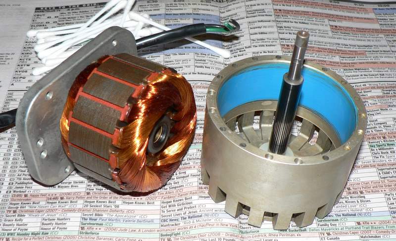

Great find!
For interest, here's a link to photos of my Dyna Empire 208/Papst set on Flickr.
http://www.flickr.com/photos/worldwidephotographic/sets/72157603524842069/
Is yours a 3-phase EC motor like the Papst??? I'm still looking for a digital-analogue controller for mine.
