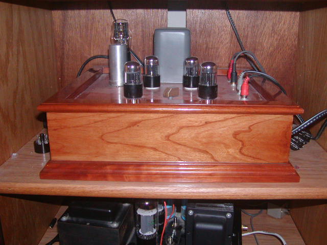

I've built several of the 6SN7/6SN7 Aikido linestages. I used what I had on hand for power transformers and thus was not able to roll any 12volt 12SN7's. If it were me and I was planning another Aikido I would simply add a double pole double throw switch and a suitable 12 volt heater transformer. I never had to supply the heaters with DC and my linestage is 100% quiet. I can appreciate wanting to use a 5Ar4 and to possibly roll the rectifier tubes. In my case I use 5Y3's, 5Ar4's, 5U4's, # 80 and number 83 for rectifiers. The number 80 and number 83 require a hand made adapter to go from a 4 pin base to a octal socket. My favorite tube is either the number 80 or the Mercury number 83. Good luck on your build.
