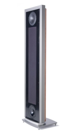

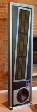

I just noticed one of the pictures on the Janzen website for the Model One looks quite different than the pictures in the Whitepaper and those I'd seen elsewhere on the web and in magazines.
In particular:
1) the ESL panels now seem to be aligned vertically rather than being canted over an angle which had been done to minimize diffraction effects. The ESL is still looks to be a monopole rather than a dipole as is typical for an ESL
2) the one large woofer at the bottom has been replaced with two 8" woofers...one top, one bottom. The two woofers appear to be different, the one on the bottom having a phase plug, the one on top a regular dust cap.
I've seen W-ESL-W arrangements before, but usually the woofers are the same.

Two woofers
There are two woofers, one above and one below the ESL line, to better match the cylindrical shape of the ESL's sound front, to reduce excitation of room modes, and so that sound arriving from the woofers is in phase with itself and with the sound from the ESL's when one is seated. It also gives us the opportunity to use dissimilar woofers, so that the inevitable cone coloration is reduced, not that there is much when the upper cutoff is set at 225 Hz.
The woofers are not powered in the standard version, and the case is sealed, yet the in-room response extends to 30 Hz.
I do not believe that exceptional bass authority is what warrants a high price, but exceptionally clean, clear and natural sound reproduction combined with striking industrial design does. If someone wants more bass, subwoofers are widely available, and even we will have one available pretty soon, too.
The tilt on the ESL module in the original, fully powered version was to distribute the diffraction interference frequencies so that none dominates. In fact, there is very little diffraction interference in this design to begin with, and the small improvement was far outweighed by audience aversion.

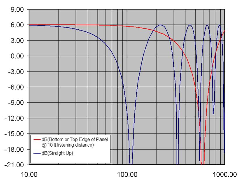

Hi Davidjanszen,
certainly you put some right thougts on the design of this speaker.
My experience tells me that the upper woofer will put a lot of movement in the construction when playing 30 Hz with extended excursion. The distance to the bottom is long and the standing area just limited.
The only way to handle this waste of stability is to set a second woofer on the back side in order to compensate the impulsenergy of both woofers to zero. But this doesnt work with crossover frequency at 225 Hz.
On the other hand a calcuation ot wavelength at 225 Hz indicates that the distance between the lower and upper woofer is too long. As a result the woofers are not working as a common source but will interfere frequency response depending on listening distance

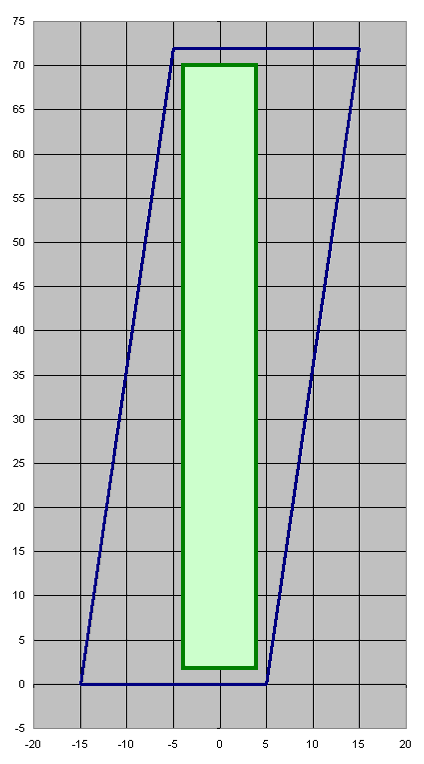

I had tried a similar diffraction distributing baffle technique last year with good results...tilting the baffle instead of the panel.
However, even with the wings made of plexiglass so as to be less obtrusive, the whole affair was still a bit offsetting to most people.
Personally I thought it looked rather...purposeful, and modern.
I can't seem to find any pics I took of it, but here is a graphical representation.

Looks cool to me. I was urged by an industrial designer to make our panels parallelograms, only after it was too late. It would not have made the best use of the panel area, anyway, but I suppose it might have elicited less resistance.
The first question from every single man who saw the original Model One was, "Why are the ESL's tilted?", often with an undertone of, "What kind of ** is this?". A majority of women seemed to like it visually, though, and didn't seem to care much about the purpose.

I had the same thought about the woofers being too far apart to sum properly. Obviously they won't sum properly from floor to ceiling, but I wondered how well they would sum at a typical listening postion of 10 ft away with your ears no lower or higher than the bottom and top edges of the ESL. Assuming I did my summation calculations properly, things look to work out quite will for a 225hz crossover. Not perfect, but I could be convinced this works out better acoustically than just a lone woofer on the floor. I did a summation straight up at 90 degrees as a check to make sure I got a null at 1/2 wavelength of the distance between the drivers( I estimated 5 ft).
Now the shaking of the cabinet due to the upper woofer mass being so far from the base of the cabinet...that could be an issue. Any shaking of the cabinet would shake the ESL panels as well. Not a good thing. Perhaps the cabinets are extremely heavy in comparison to the 8" woofer cone to make this not a big problem. I could not find a specification for the weight of the cabinets. Perhaps David can provide that information.

Same distribution pattern and symmetrical crossover response.
Just two bass drivers on top and below a panel don´t create the same cylindrical pattern as the panel´s, especially not if crossed over too high.
jauu
Calvin
Hello Calvin,
I understand the need for symmetrical crossover response and similar distribution pattern.
Other than building a line source with a stack of 6 to 8 woofers set up in a column (separated from the ESL) I don't know a way to match the cylindrical pattern of the ESL. I am trying to avoid this approach for a variety of reasons.
You say that solutions to the integration problem have been posted in the forum for a long time. I haven't been able to locate them with the search tool. Could you point me to this information? Thanks.
