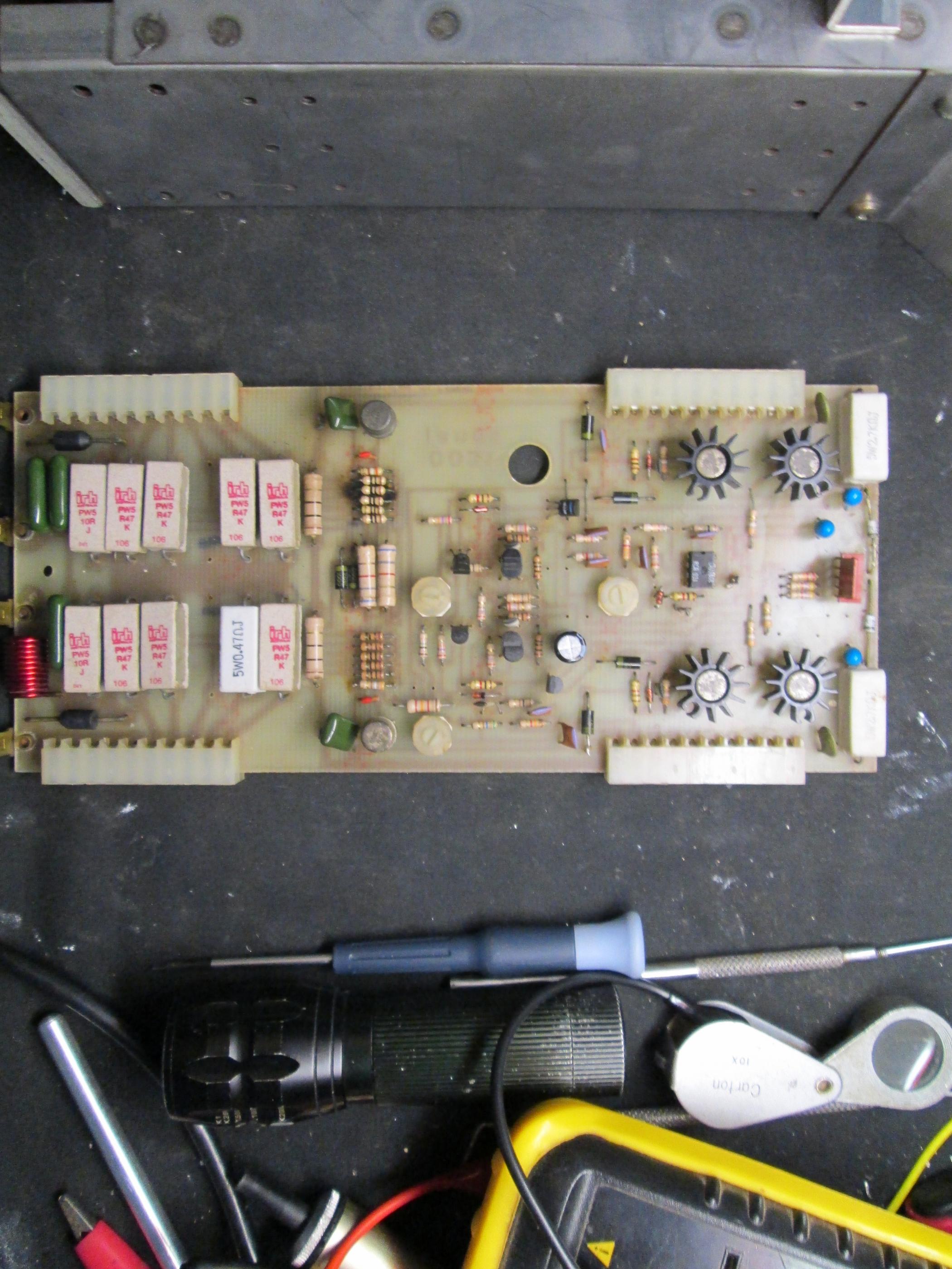

I'm looking for a Jands J-700 amplifier service manual,if anyone has a copy? I tried Jands of course, I sent them an email saying I'm doing the repair myself,they replied that they don't send them out to the general public? Then asked me where I lived so he could send me to a repairer Grrrr

I got onto Dallas Clarke from Clarke Audio,he said Jands don't have a service manual for that model or a schematic that he is aware of? Oh well Ill have to try and figure it out myself.This amp looks like it was put together by a drunken monkey with good soldering skills.Ha!
Sorry that he wasn't able to assist, Ross, and yes, tho Jands stuff back when was pretty basic
Maybe, just maybe it might be a variation of the Leo Simpson circuits that were all the rage back then - those amplifier circuits were also pretty basic but a lot of guys did manage to get them to function at higher power okay - the name they were called escapes my leaky memory - "playmaster" and all that stuff in the forerunner to Silicon Chip mag?

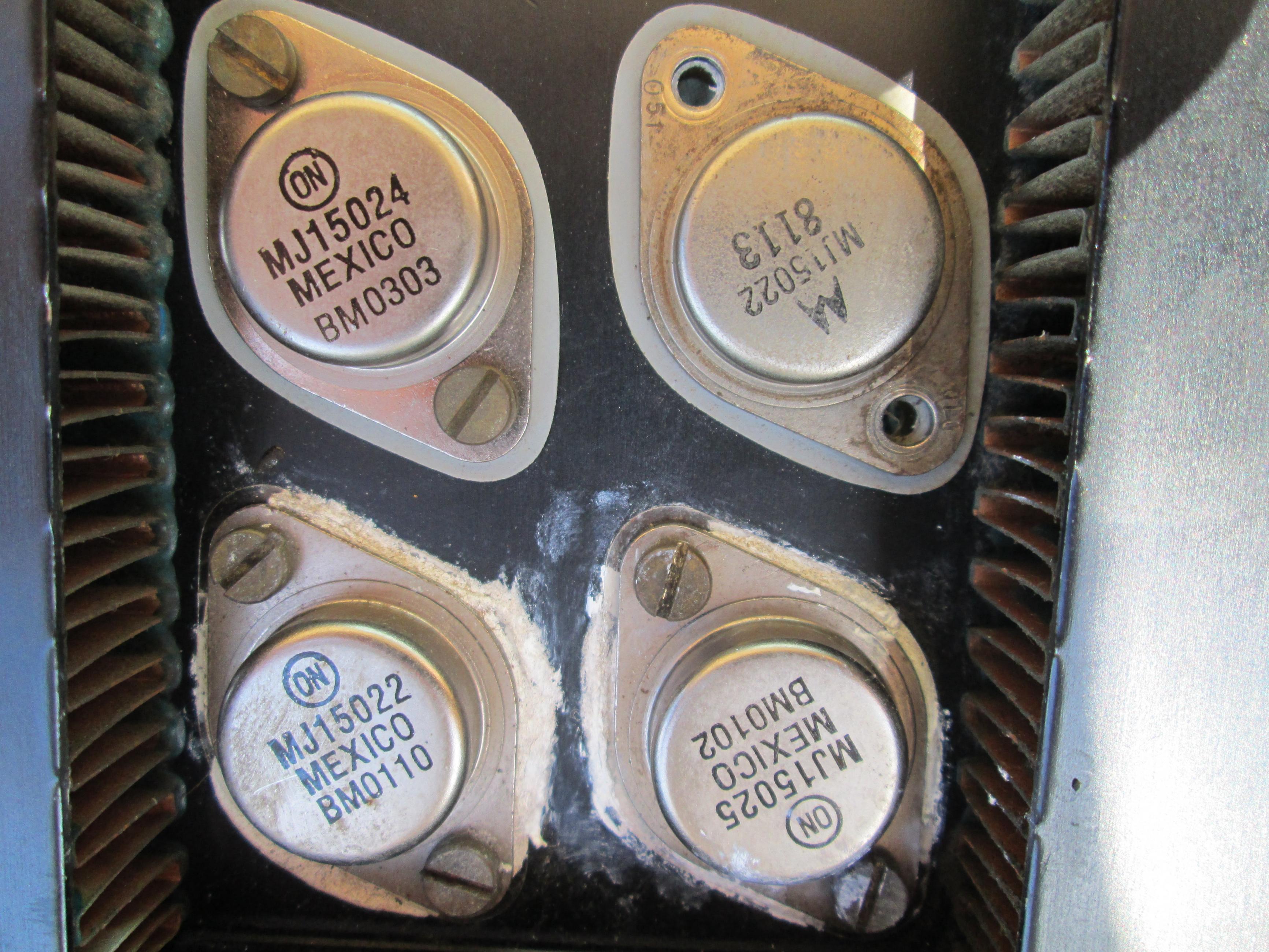

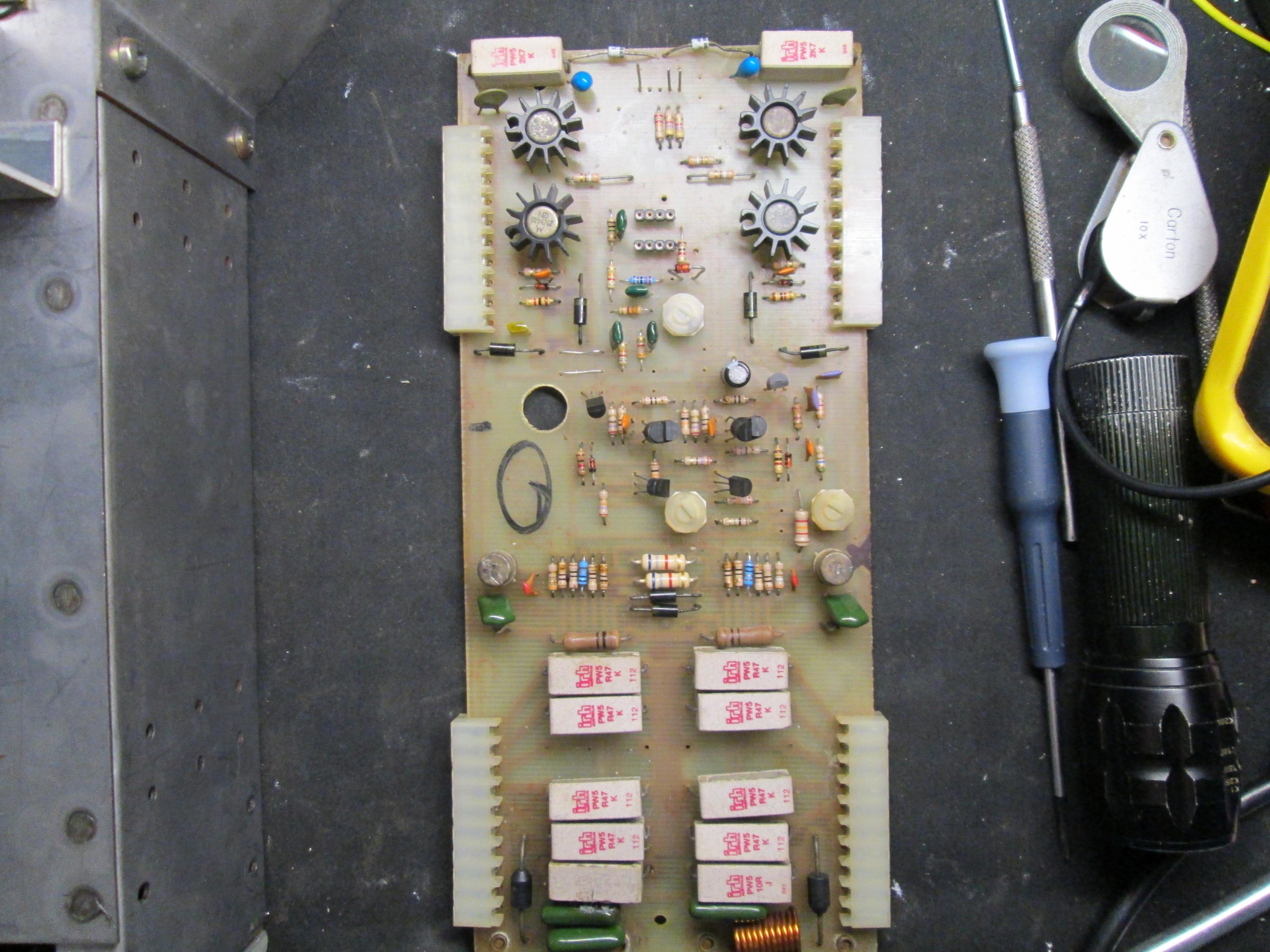

The trouble is Ian that someone has been at it before me, both driver boards are from different models,one board didn't have a DC offset circuit so I built one on it and changed everything around to be the same as the other board.There were three different outputs used without thermal grease on one of the heatsinks? MJ15022,MJ15023. MJ15024,MJ15025. ED204,EB204. some parts had been installed without rhyme or reason,electro caps installed backwards etc..? The thing is and this fairly freaked me out. The soldering was professionally done? I think Ive got it sorted though,I'm waiting on some input transistors then the old dim bulb tester will tell the story? Ive decided to let Jands have the benefit of the doubt so Ive put the voodoo dolls away LOL Thanks for the advice for putting me onto that Tina-TI program Ian its exactly what I need and for SMPS as well, much appreciated.
Well, I wouldn't have touched it in that state, where someone really desperate has mauled it badly and probably many times. I would pull the whole mess and DIY build a known design, 350W amp from the forum or other old schematics, perhaps even from Crown, who have old manuals for download. When you say "didn't have a DC offset circuit" do you mean bias controller or limiter circuit by any chance? Offset is not normally adjustable but it only requires a pot. to substitute for a resistor or 2 in the input stage.
OTOH, I recall that over the years, road amps did get badly treated and badly fixed with whatever spares were available in the crew's toolbox or parts bins. The MJ150XX power transistors only differ in their Vceo, Vbeo figures though, and this means you could, in theory, substitute any types that simply had the same or higher ratings. Mixed parts may not be quite as bad as it looks but then again - if the workmanship sucks too, and no sign of Hfe matching at moderate current, perhaps it is just the work of a desperate person with little knowledge and not enough cash to get the repair done properly.
Unfortunately, unless all the parallel sets of NPN and PNP output transistors are matched properly among each gender for Hfe so they current share, large amps will soon blow when used as they should be - at full power, right on the limiter. These details have been written up in countless PA and big amp repair threads here since the forum began and it is quite expensive to overhaul the stuff properly, even if you DIY.

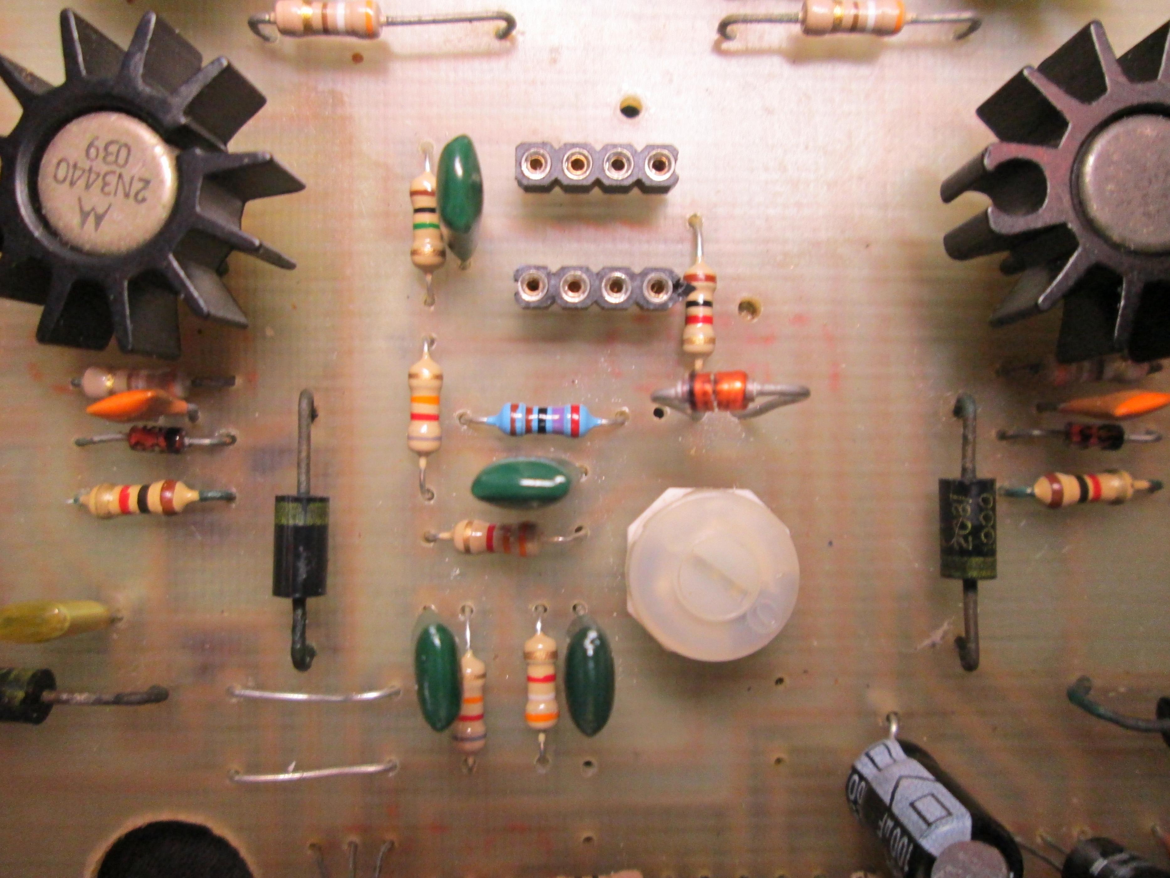

This is as many photos that I can upload or otherwise it wont work? I assume that the circuit I added is for DC Offset because that's what the op-amp datasheet says its used for? The central VR is 10k ohms and seems to be the bias controller the other 500 ohm VR is connected to what looks like the temperature transistor. That's why I wanted a service manual so I could work out what was what and and how much to set the bias and temp at? I haven't had time to study the Tina TI yet but it looks like its exactly what I need.
The pics show a lot of replaced components but the matter you mentioned about grease not being used with the T03 washers - Grease is used with mica washers but not with silicone rubber which eliminates grease since its said to conform to the metal surfaces, shown as the 2 upper transistors in the last pic. Typical silicone rubber is not as effective in heat transfer yet while this makes little difference in home audio that may typically output less than a few watts, high power PA is often at maximum and every skerrick of cooling is likely needed, just for reliability. Perhaps it's an availability problem but the original, thinnest possible mica with best quality grease is the way to go.
BTW - The temperature sense transistor or VBE multiplier regulates bias voltage according to the setting of bias adjust pot. located in its base circuit and permitting adjustment of the DC bias of the transistor itself. That's how you identify it. For an illustration, you can just make out the details around VR2 and the small central transistor on the heatsink in this layout diagram of the Silicon Chip Studio 350 amplifier.

Is there a tutorial or some way I can find out what to adjust V1 and V2 too? I know how to set the bias on some amps using milliamps or millivolts.
'Not sure what V1 & V2 you mean. The 500 ohm value connected to the thermal sensing (Vbe multiplier) transistor will be the bias controller though. Look at the location in your amplifier's circuit to find out what the other controller does, though likely it was originally intended to adjust DC offset as there isn't much else that needs tweaking.
FWIW, and as you have experience of bias setting, a preview of the texts will show that for a given output stage design (usually Emitter follower in double or triple cascade in PA) there is a specific optimal current that ensures least THD. That is measured in mV drop across any of the output pair emitter resistors. As there are 4 pairs, they should all have equal current which means that for a 0.47R resistor where 100mA/output pair is required, within parts tolerance limits, you should read 0.47*0.1 V = 47mV across each and every of the 8 emitter resistors. Total bias current is then 400mA. However, experience tells me that as these are not hi-fi amps, bias will be set a lot lower - perhaps 30 mA ea. only. When setting up, there is no obligation to have bias anyway - just enough is applied to banish noticeable crossover distortion in use.
