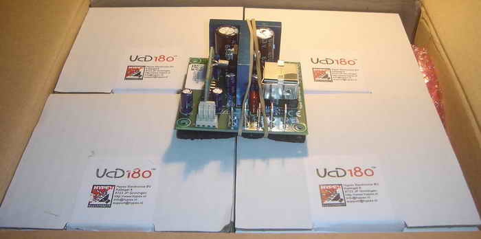

4 modules of UCD180 has arrived here. I wanted to make 4 channel car amp using these modules.
The smps will be unregulated, switching about 30khz pushpull, output from diodes is only C (not L-C). Input = 12V (car supply), output will be asked to you first.
My question is :
1. Since car speakers are most commonly 4ohms, what supply voltage rail you suggest for these 4 modules?
2. Can I make just 1 SMPS to power all these 4 modules, or I must make 4 independent SMPS for each module?
If I can use just 1 smps, can they be connected directly or there is a certain method for using single power supply for powering several UCD modules?

If you can make a suitable supply to power multiple modules, do so.
You'd probably be taking a hit in audiophileness, but we're talking car audio anyway right? Imaging and soundstage in car audio is best done with digital delays.
So what it amounts to is what kind of supply can you build.
As per the power output, you'll find the supply voltage in the data sheet of course. What you need to be concerned with is the current capability of your power supply I would think.
You can connect multiple supplies directly, but you can also experiment with certain methods of isolating one amp from the other. Feel free to email me if you don't know what I mean by that.

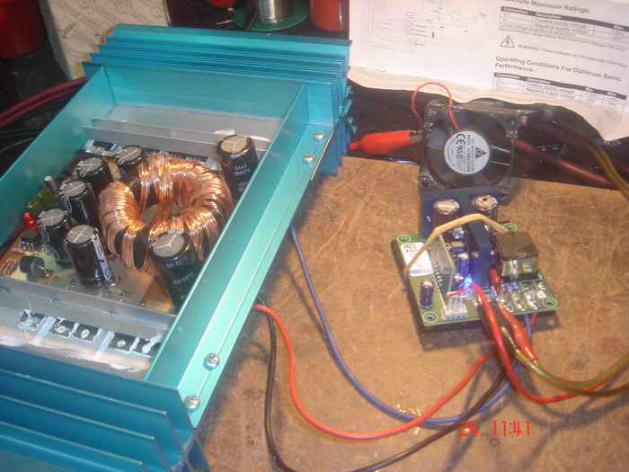

lumanauw said:Testing 1 module on smps. It works, and sounds good even on primitive setup 😀
Is there a trick to get more bass from UCD?
Nice work on the SMPS !! 😀
big ferrite toriod too...... maybe 10A output capacity? I only got 1 here... outer diameter of 1.5 inches.... 🙂
cool!!!
Maybe you can tell a ittle more about the power supply? I'm plannin also an UcD for car audio appplication...l😎

You can download the pcb files free in my website. Open it with protel.Maybe you can tell a ittle more about the power supply? I'm plannin also an UcD for car audio appplication...l
The only weakness of de UcD180 (in this case) are the power fets. These are 100V devices so stay under 50V rail voltage. Power fets usually do not tolerate much over voltage and I have seen many fade away with just under 5% over voltage.
To get most out of the UcD’s in a car, use an inverter with stabilised output to keep rail voltage safe under worst case battery voltage.

They're 120V devices. (even the 100V ones).
You keep them safe by ensuring that under worst case conditions, overvoltage isn't exceeded, that's 52V, and you still have a proper margin.
