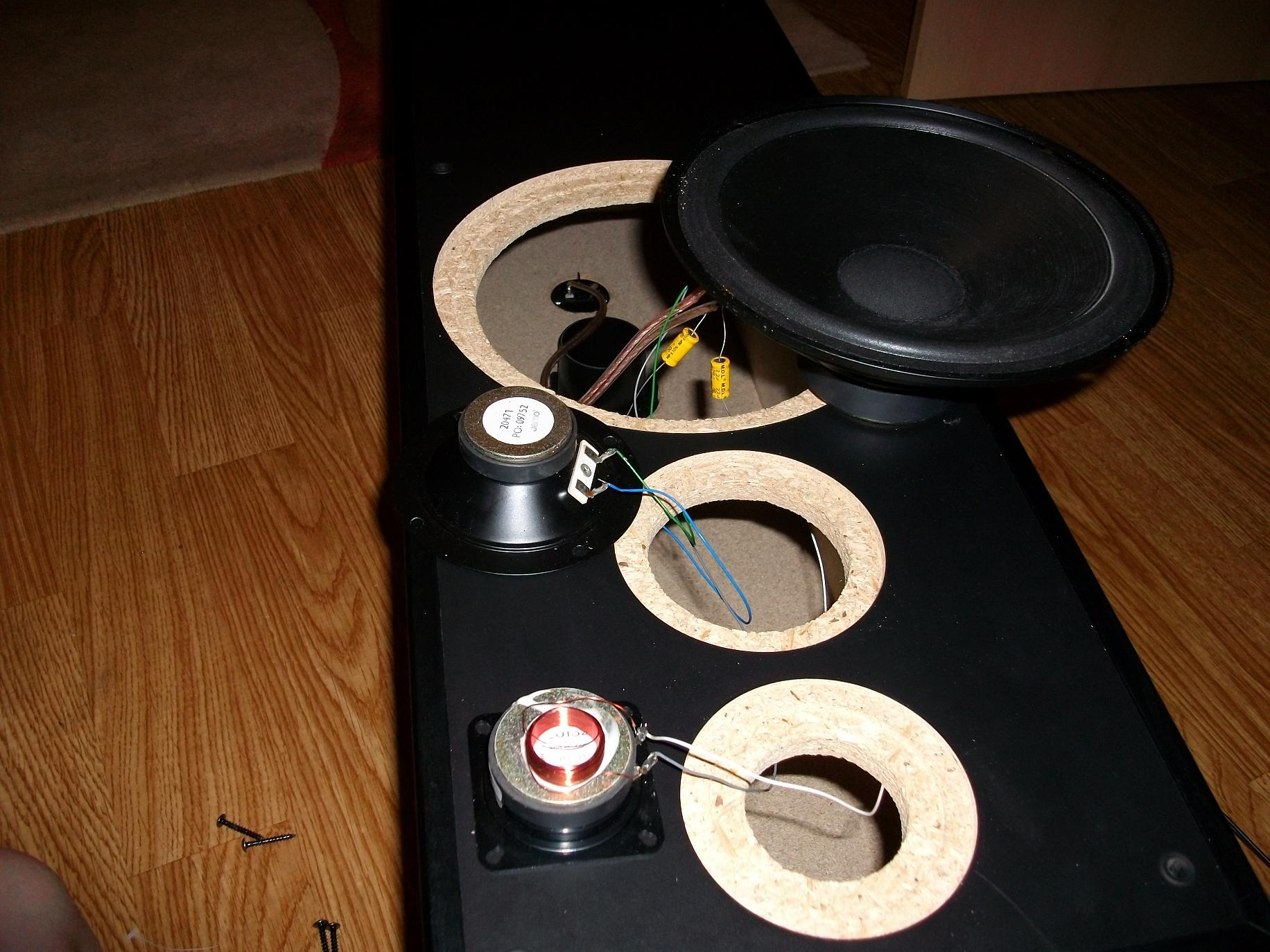

I've found a picture!
Each of the two capacitors comes straight off the woofer's positive terminal and the tweeter's coil is glued directly to the tweeter magnet assembly.
I'd leave the crossover until you find the current problems. You'll probably want to check the resistance of the existing drivers which would call for a meter. If any are damaged you'll want to make a decision about all of that type.

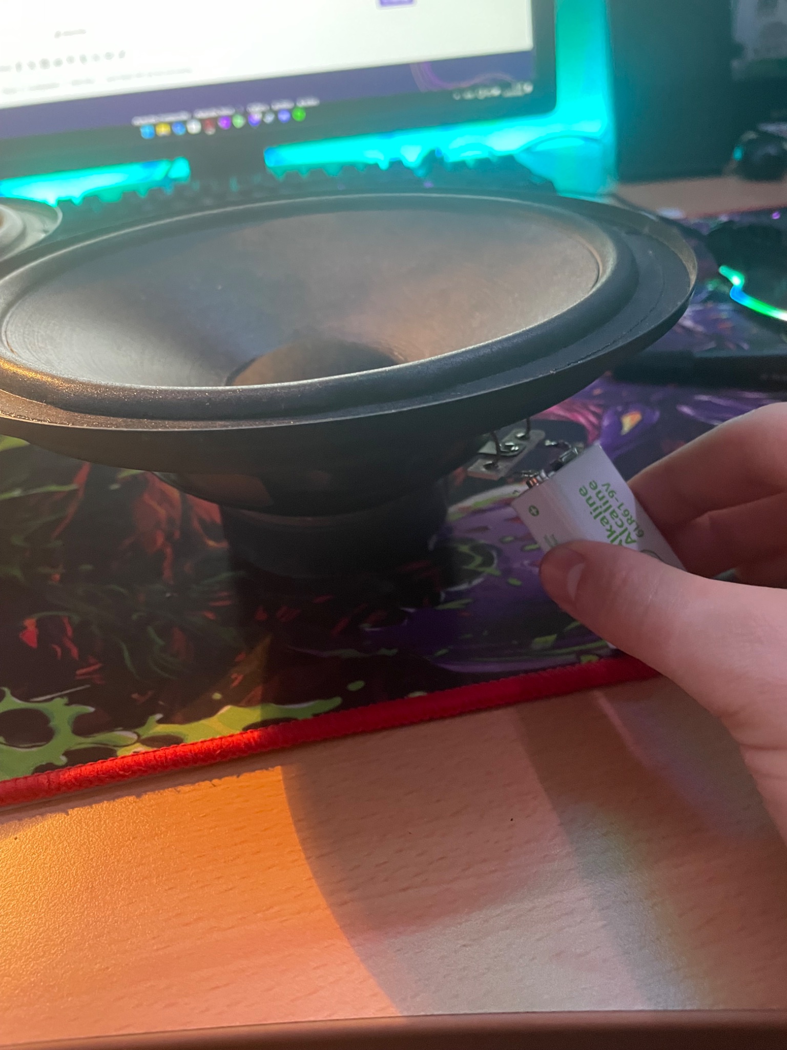

Unfortunately there was no problem with the wiring and connections, but with the speakers itself.
I didn’t have a multimeter so I used a 9v battery to test If the speakers are still working and the middles are working and the subs are not, Its so funny because none of them the two subs are working. On the subs the membranes are damaged but they don’t make any sound, the tweeters are okay but they don’t make any sound when they are all wired up just when I tested separately.
Should I hand it to a service or I have to buy a new pair of subs? Or can I fix my self?
Handing the speakers in for professional servicing is unlikely to be a financially viable option. The servicing time involved would result in high charges.
The rubber/foam surrounds of the woofers could be repaired/replaced by you, but the battery test would indicate that the woofer voice coils are burned out and beyond the ability of an amateur to repair.

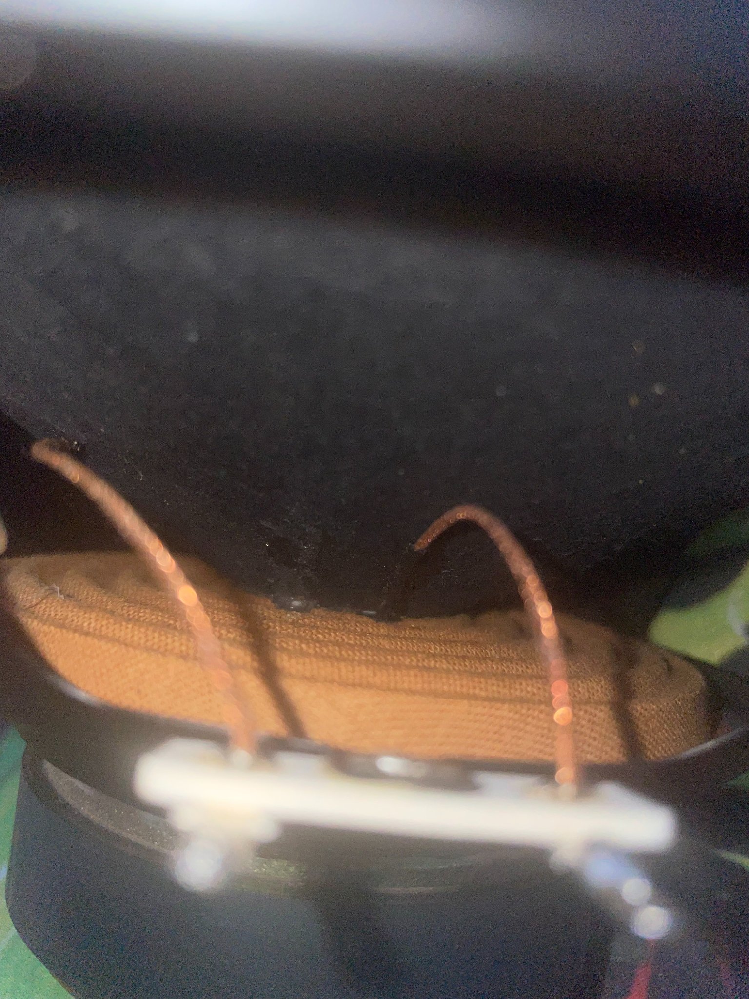

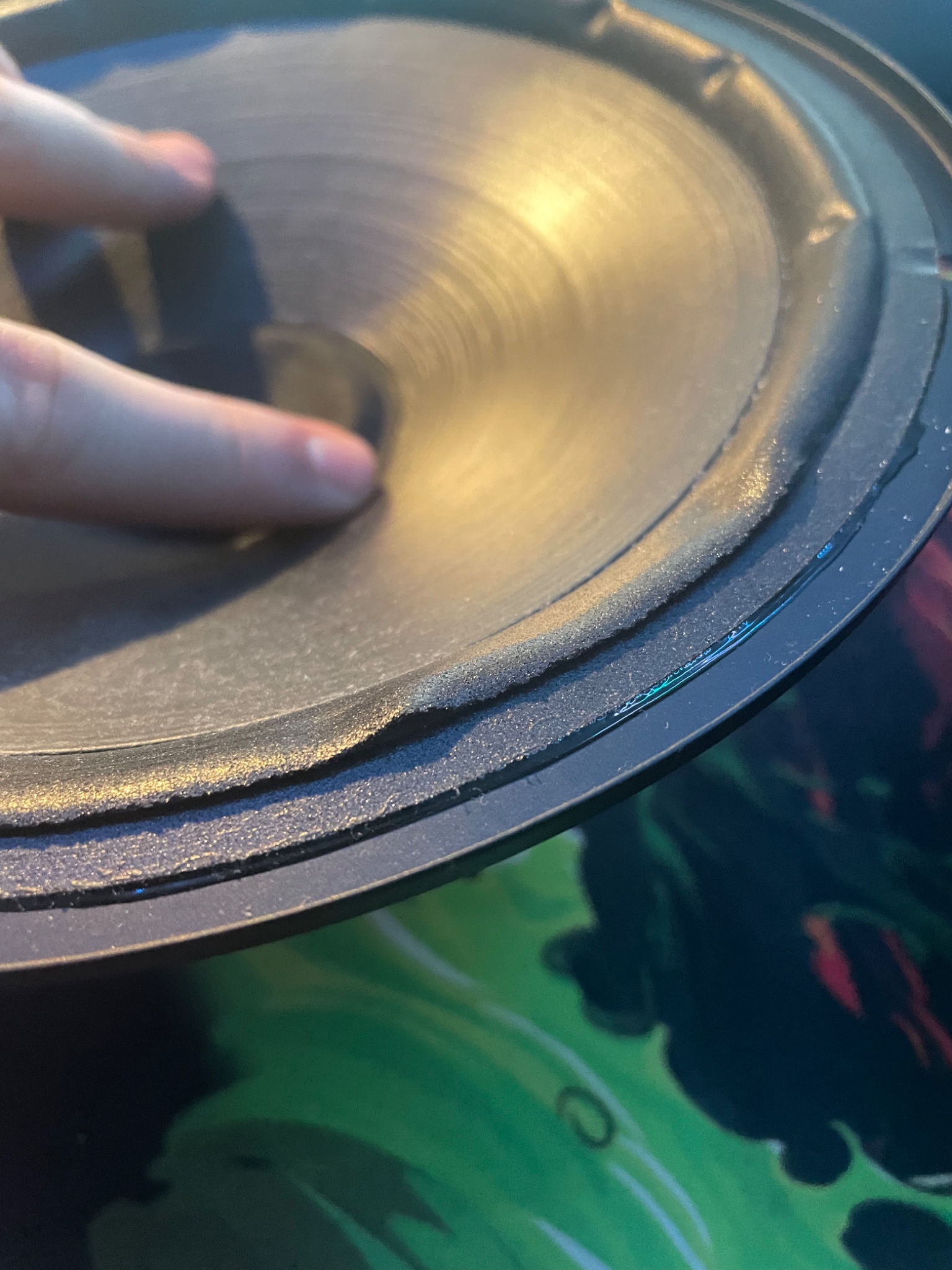

The photo is out of focus, but it looks like the right hand flexible tinsel lead has become detached from the thin voice coil wire.
If I have got that wrong please tell me and/or post a clearer image.
An external tinsel wire may pass through the driver's paper cone (as the left hand tinsel wire appears to do) where it is soldered to the internal voice coil wire.
The dust cap often has to be removed to expose the internal junction with the voice coil wire in order that resoldering may take place.
There are videos of the procedure on YouTube.
In this video the speaker has an additional whizzer cone instead of a covering dust cap, but the principle of repair is the same:
P.S. There is likely a broken connection at a similar point in the other woofer that you cannot see, but can investigate.

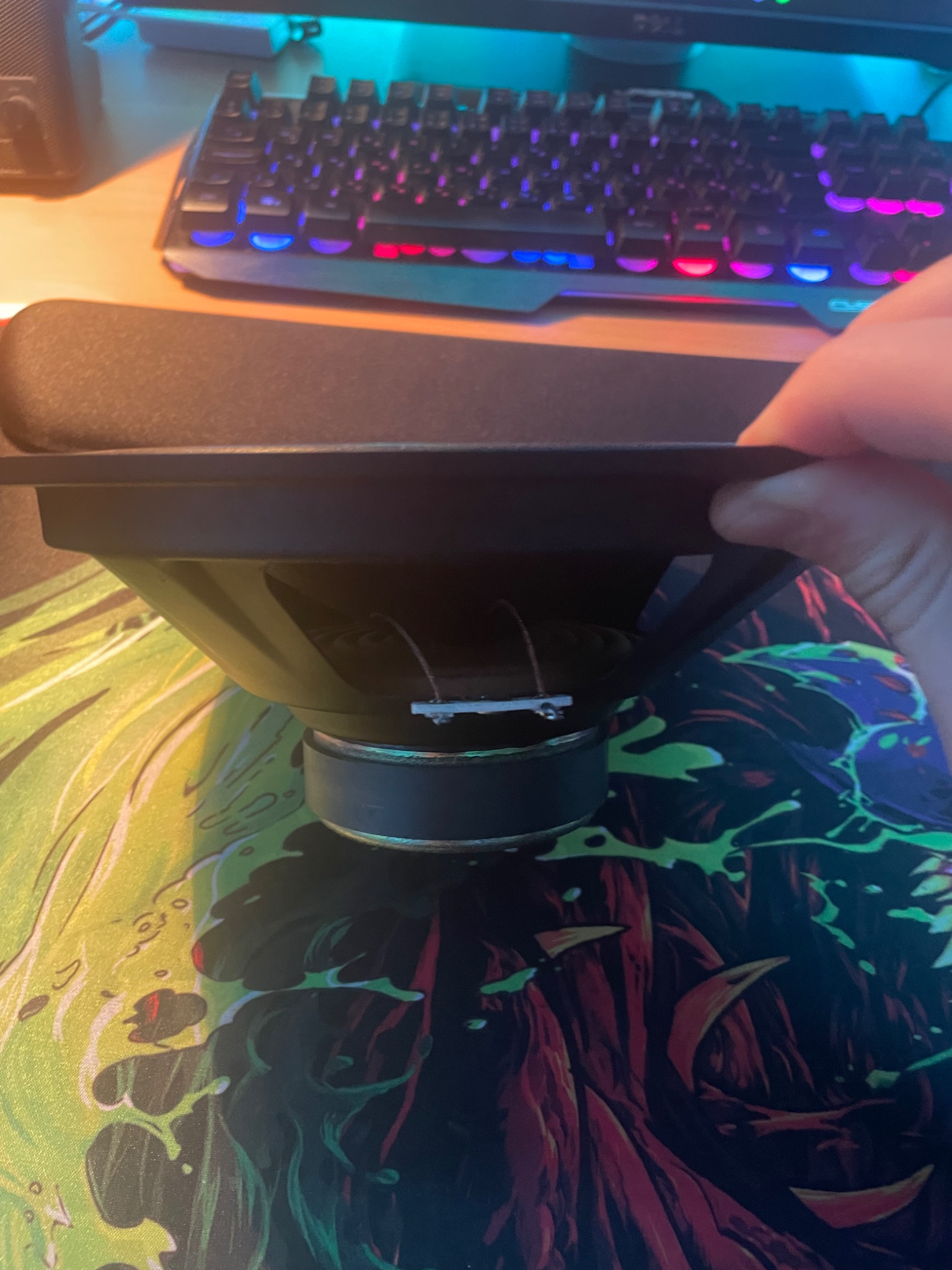

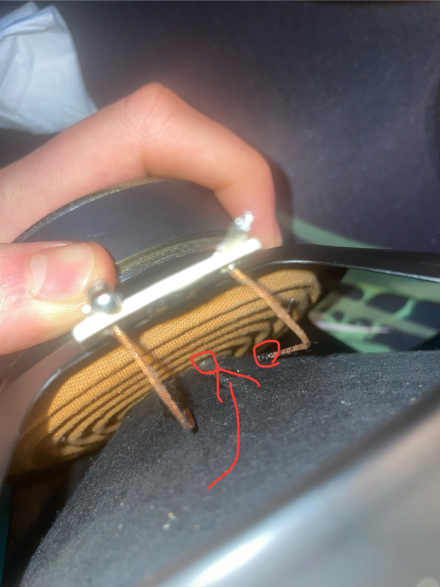

Sorry for the blurry picture the left flexible tinsel is broken, the right is correct it has the black glue on the bottom.
The flexible tinsel is connected under the paper membrane in the middle of the spider paper or idk what it called the yellow wavy paper. I can’t reach into it deep enough, do I need to cut of the too membrane?
Yes, I see it now. The left hand tinsel wire in the original photo is disconnected from where it should pass through the cone.

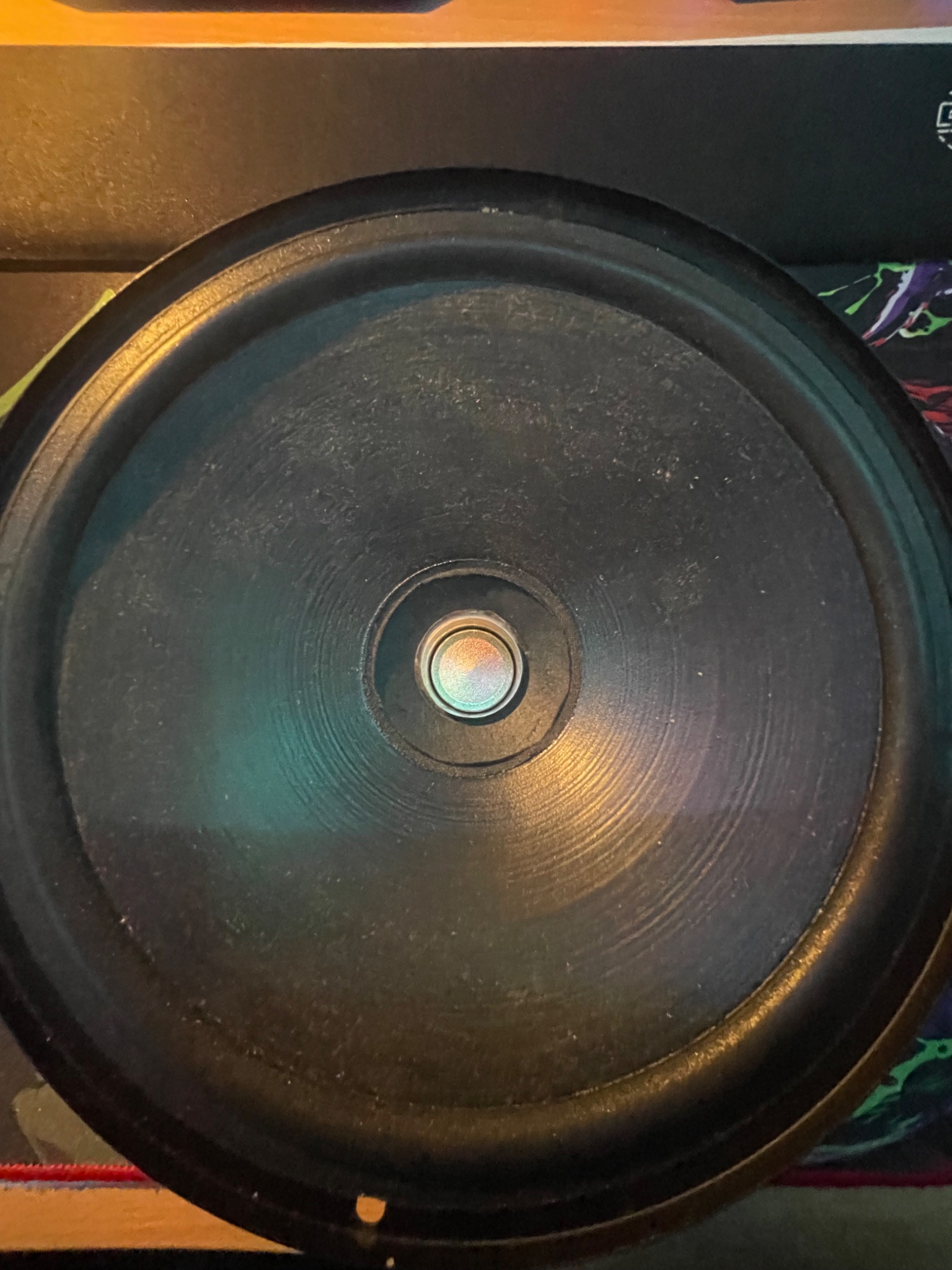

You need to carefully slice off the front dust cap with a sharp modelling knife in order to expose the tinsel wire/voice coil wire junction hidden underneath.
Do this neatly so that the dust cap can be glued back on later.

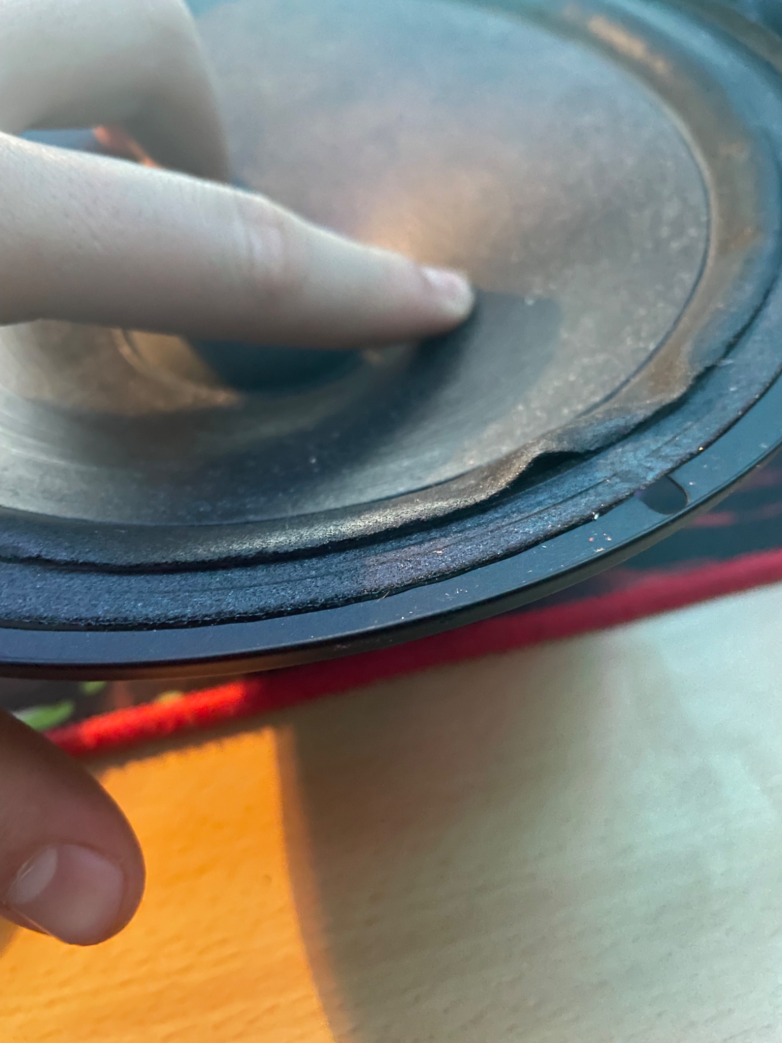

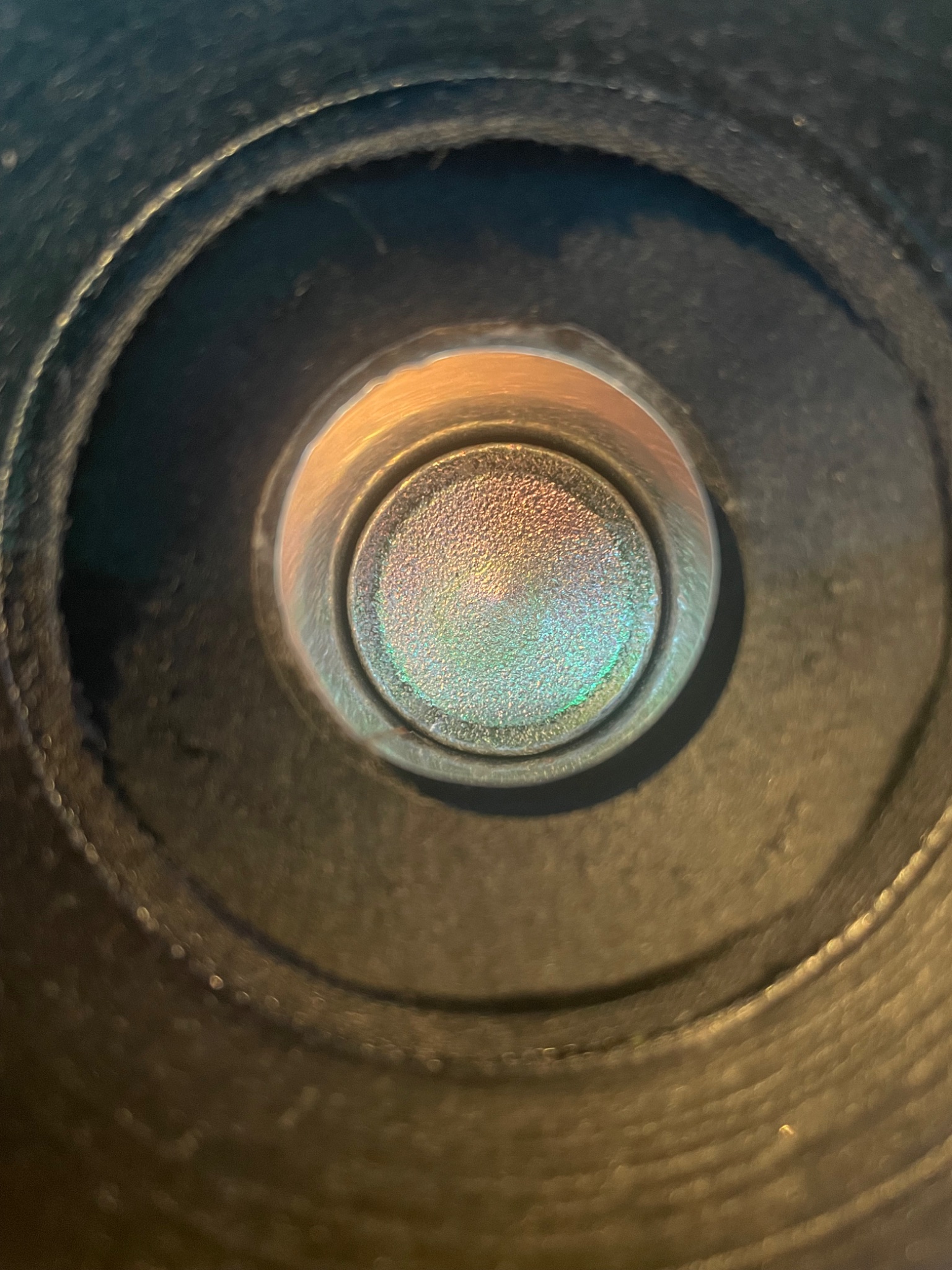

I already took of the dust cap because it had a hole on it, but I can’t see anything inside. I think it might connects to the bottom of the cone and not inside. But I can’t reach in.
Should the cone be cut off?
I had to go out and have now returned, but not with good news I'm afraid!
The tinsel wire meets the paper cone at an awkward position close to or beneath the corrugated rear suspension or spider.
Unfortunately, removing the dust cap does not expose a junction with the voice coil wire.
All I can suggest is using a sharp blade to gently scrape off the black adhesive covering the outer junction next to the spider to see if the voice coil wire or remaining section of tinsel wire is revealed. Perhaps then you could resolder the joint.
Not that it helps, but the broken tinsel wire joint is likely a consequence of the cone having exceeded its to and fro excursion limit. In other words, the speakers may have been played too loudly by the previous owner, probably during a house party.
Woofer replacement would appear to be the only option. If you can't obtain the correct Jamo 22503 woofers at a reasonable price you may wish to take a chance on a pair of inexpensive generic 8" woofers. You would have to be prepared to write off the cost if they did not produce a decent result.
