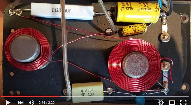

Just opened my Jamo E650 was doing some mods to my Jamo E6 center i will post the mods later here so i was wondering what kind of mods can you do to the crossover on the E650.
Here is a full video of every component.

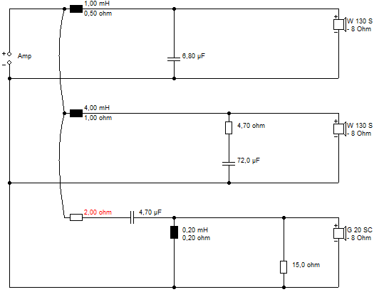

You could change it to 3.3uF and 0.3mH, or 4.7uF and 0.2mH. Then lose the protection device.
Interesting but i think instead of the protection i would put 2ohm resistor because the part itself have 2ohm when cold. The capasitor is already 3.3uf do you think it will be better to put new MKP 400V capasitor?

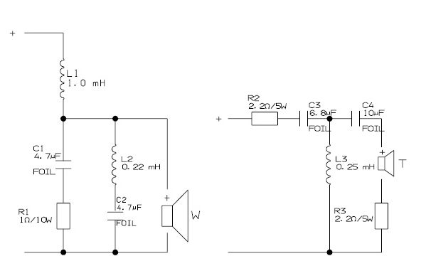

The schematics you provided is not correct. There is no coil on the tweeter. The coils are for the bass and middle speaker. Tomorrow i will draw the exact schematics so we can draw modifications on the base image.

The modification i have made on the center speaker E6 Cent, is cut down the coils for the middle tone from 1.2ohm to +- 0.8ohm. Removed half of the wire and that made massive difference in middle to high tones. It liven up the speaker. The tweeter was dried up so i removed the ferrofluid and now it sounds like new.
So, removing the protection and 2ohm resistor in the place of it. Adding a coil (the stock crossover doesnt have a coil on the tweeter) and a resistor. Btw the speakers are 4ohm not 8 so... Another thing, any thought for the middle speaker. The sound is like middle to low there is a lack of guitar volume and crispness 😛 (if that is a word...im from macedonia so english not my native laguage )

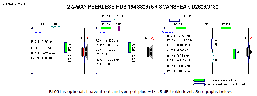

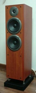

To be serious, the Jamo E650 seems to be your regular 2.5 way speaker with 165mm paper bass drivers. Not my cup of tea, as it goes.
PEERLESS-NOMEX-164
Obviously simplified for commercial reasons. But nevertheless demanding a second-order tweeter. 4.7uF and 0.2mH ought to do it. 😀
PEERLESS-NOMEX-164

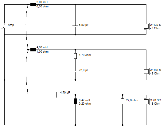

The above circuit is almost exactly same target response as the single 3.3uF and 2R circuit fuse. The 15R or 22R gives the amp a better load at high frequency. So it sounds smoother, you follow? In fact I was using 22R in modelling it this morning.
This one gives you 2dB more treble and midrange at crossover, whilst keeping impedance comfortably above 4 ohms.
Both have much better phase alignment than the single 3.3uF.
You can, of course, add a 1.5uF MKP to the 3.3uF to get to the same place.
If you are undecided about treble level at this stage, a 0.3mH air coil could be a good compromise. Hardly a critical circuit.

These values aren't very critical. If you are keeping the fuse, use 22R 7W shunt on the tweeter. I really just pulled 15R out of the air the other day. Then 4.7uF and 0.2mH (or 0.22mH). The fuse also helps keep impedance up, which is safer for the amp.
2R or 2.2R will make no difference either. I am assuming a regular 8 ohm tweeter with a DCR around 5-6 ohms. A 4 ohm (DCR around 3 ohms) tweeter is a slightly different animal, but should be fine with 4.7uF and 0.2mH anyway.
