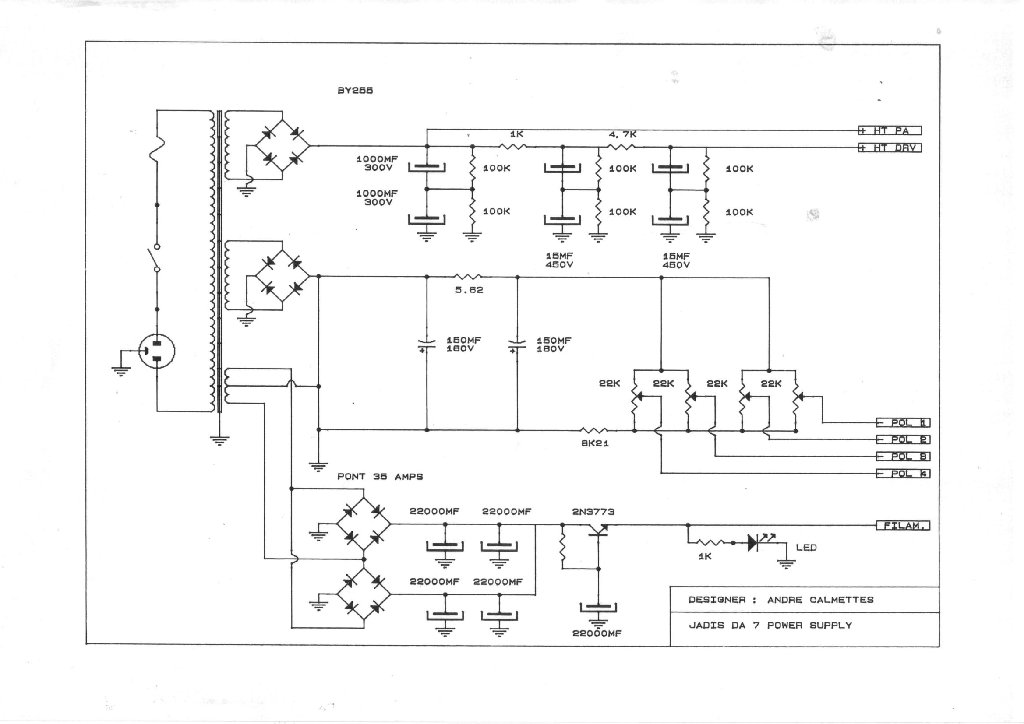

Hi, I have a DA7 DELUXE stage and I would like to set a delay when turning on the stage at high voltage.
Where could I put it?

This model does not use a switch for the standby function, there are powered time delay modules that could be put, but in this amplifier I do not know where to cut the high voltage. I can put the scheme of the source, but I do not know if the relay supports that voltage, it it occurs to me to quote the negative.

Is this the schematic you're looking at?
Ah, thanks! That one is more understandable. The one I was looking at is titled Jadis JA-80, that was linked to an earlier post.
