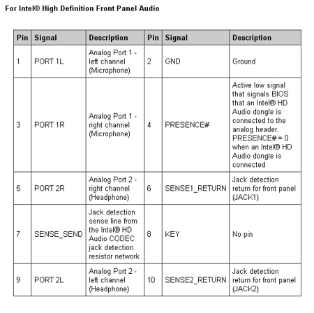

There's a front panel audio header on my Intel system, and it seems like whatever signal tells the mobo a mike or headset is connected is not getting through. When I plug in the headset, the rear-connected speakers do not mute. When I plug in a mike, I get nothing. Everything works fine through the rear panel connectors.
The cable connecting the front panel audio header to the mobo has a pinout diagram showing "sense1" and "sense2" conductors that somehow let the mobo know when a mike or headset jack is plugged in.
Question: How can I test if sense1 and sense2 are working properly? I would assume they just go to ground when a jack is inserted. That would help me eliminate the possibility of a software issue. But when I perform that test, I get no continuity to ground. Am I testing this correctly?

Might be, but when I put my meter between that pin and ground, it stays open circuit whether or not a jack is inserted. Seems like there should be a change one way or another.

Which MB do you have exactly? Jack sense in Intel HDA is not mechanical, but codecs measure impedance of the input/output pins and make conclusion about the connected device (line-in, microphone, headphones, etc.). Codec datasheet specifies respective impedance ranges.
The mobo is an Intel DP35DP, and it does indeed use HDA. What I plugged into the front panel audio header jacks was a "dummy" 3.5 mm stereo minijack with bare wires attached. I wanted to test L/R channel continuity from those jacks through the cable to the mobo. That continuity was fine.
As per your suggestion, I went to the Intel site and searched their tech documents. It seems you're correct about the mobo looking for an impendance range, rather than a simple open/closed to ground like I assumed, but could not find any range values.
Given the symptoms described in my first post, I'm now starting to suspect it could be either a bad audio chip or a faulty front panel audio header. The headset and mike work fine on other machines, and in the rear panel jacks of the Intel machine.

The Intel HDA controller is a part of the southern bridge ICH9. You need to consult datasheet of the HDA codec STAC9271D, which communicates with the controller using the HDA protocol. See page 21 of

Thanks for the tips. You were correct about the audio drivers. I may have just solved the problem. The original drivers (v1.0)were from SigmaTel. I linked to the IDT website through Intel and got new drivers (v1.22) from IDT. Everything now works as it should.
