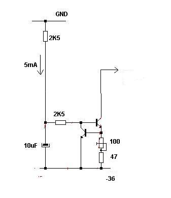

Can you explain how I use J-Fet and trim pot instead that 2 legged IC .
I have 2SK264BL or 103BL or 2SJ74BL,GR or 2SK170BL,GR.

look at picture - taken from Papa's Diy-opamp article ; just use adequate multiturn pot instead of resistor
regarding regulator - on which one you exactly think ?
btw - 2x25V will hardly give you +/-36V after reg ; you need more volts ...... but I can't tell you how much more without knowing exact topology you are planning

use any decent little bjt from your drawer

see :

Hello Choky
Do I use PNP or NPN .
I have both .
MPSA42 or MPSA92 ???
Which one would be better .Sorry if is a stupid question but I do not want to damage the $13/PC 2SK389V Jet . I'd rather be safe than after sorry .

you must look at schmtc
both are NPN

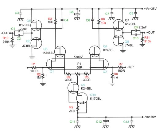

HI Dodo
Thanks for the schematic ! What do you mean the right 2SK246BL pair for cascoding .
I just planing to use a matched pair that is all .
Do I need something special matching here ?
I think if I match them to 0.01V that will be OK or not???
I have some mathed pair at home . I really hope that will do the job.

Hello Dodo
I just printed out your schematic and com pared your schematic with the original , you left out 1pair resister 1M close to the output .
Do I have to use all those capacitors in your schematic ??
Mr Borbely schematic only has capacitors on the output . What is the purpose all those caps ? An what type of capacitors do you think electrolytic ?
What about values 100uf any advise ?
I'd like the original schematic posted by Mr Borbely because only 4 capacitors and no electrolytic .But may be your schematic is the comp let verision ?
Would you please comment those capacitors I'm getting a bit confused .
Mr Borbely only wrote about the 50R trimmer pot to balance the two side of the 2SK389V . But after he write may be it is possible I do not need that all .
He does not write nothing at all special matching for the cascode 2SK246BL.
Greetings and thanks for your help .

Hello Dodo
I'm sorry being so stupid I just see you use one electrolytic each side the rest foil caps or pp or what ever .
Can you give some hint what value do I use , of course please let me know what if I don't use any of those capacitors at all?
Can you comment those capacitors necessary in here, and why .
I do hate capacitors but when there is a need for them of course I use the to .I'd rather say I try to avoid them when is possible .
