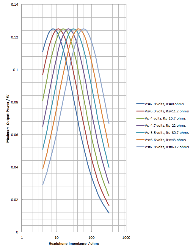

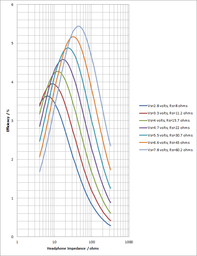

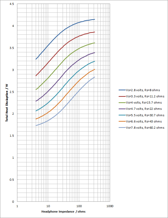

A digression from LT Spice to Excel for a moment.
It's not too hard to plot up a quick and dirty model for the circuit behavior, and the results give a nice visual indication of what's going on.
The output power of this circuit is typically determined by the source voltage, the source resistance, and the load resistance (headphone impedance). For the rest it's just a matter of setting the voltage rail (V+) high enough to avoid clipping before the maximum output current is reached.
So then it comes down to what output power into what headphone load is desired, and what level of heat dissipation will be tolerated.
As an aside, this circuit will work very nicely with high impedance headphones, but will not work very nicely with both high and low impedance headphones. The circuit values can be optimized for one or the other, but sadly not both.
I am concentrating here on low impedance phones, 16 ohms especially as these seem very common these days.
The design center values (i.e. what I'm hoping to obtain in the real circuit) are >100 mW output into 16 and 32 ohm headphones and about 2-3 watts of heat. I'd also like to avoid voltage clipping even for 300 ohm headphones, the maximum possible output power is obtained there, too.
The worksheet is pointing to Rs 33 ohms, Vs 5.5 V, V+ 20 V, and a standing power dissipation of 2.8 W per channel.
The V+ is higher than I originally planned, but the heat is within budget. I will refine the circuit gain to match these new operating points and feed it back into LT Spice.

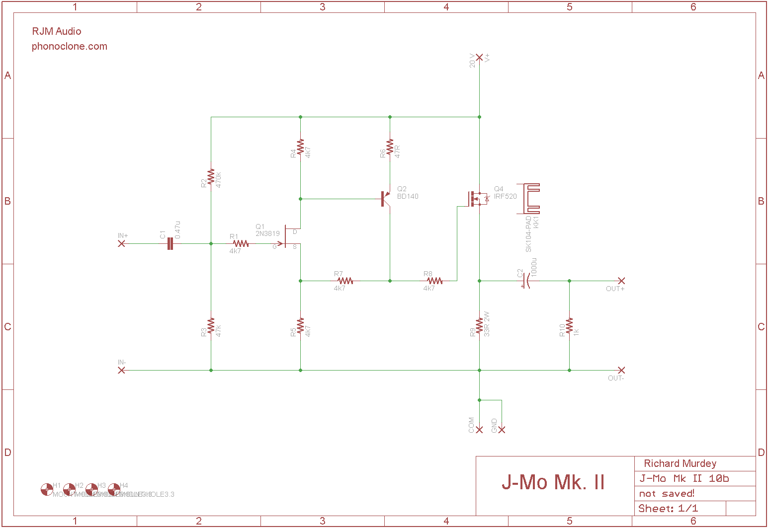

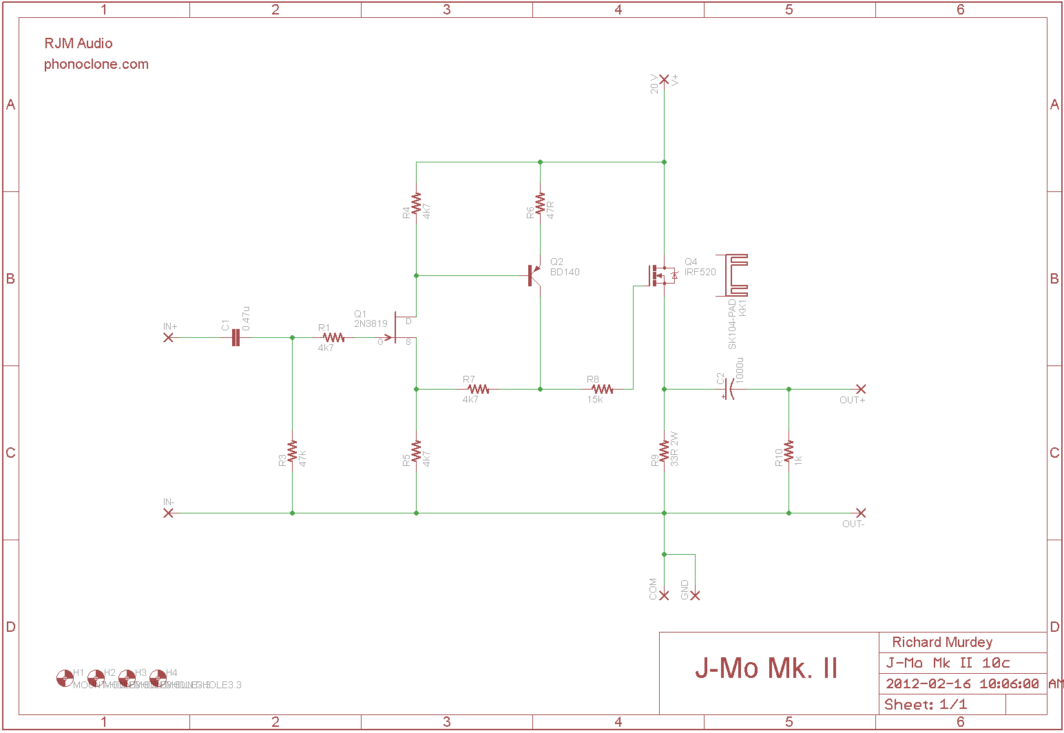

Working through it, I realized that it might be possible to get rid of the voltage divider on the input: if the gain is increased a little, to about 12 dB, the natural source resistor bias of the JEFT puts the MOSFET gate at the right voltage.
That puts you at the mercy of the jfet to set the operating points however.

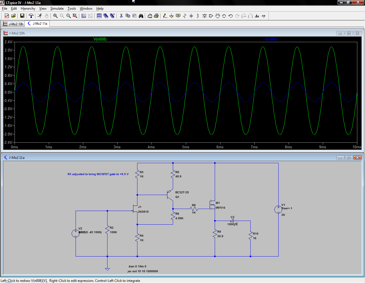

Been using LTSpice to get a better handle on how the front end of the circuit works.
Given a JFET-PNP pair, I can configure the desired gain. There is a lot of inter-dependency though, as a result of the feedback and the complication that here the AC gain sets the DC operating points. (!) There doesn't seem to be a need for an input bias, as long as the gain needed to correctly set the operating point also happens to be one you can live with for the audio signal gain, too. Fortunately this is largely true, as long as the JFET model can be chosen freely to match the desired signal gain.
So I need to settle what JFET would be best to use, and, of lesser importance, which transistor. Or to put it another way, how much current do I really need to send down the input stage, and how should I split the currents between JFET and PNP devices?
By the way, I rather like this JFET-PNP compound device. The gain is highly configurable between 1-10 (100?), and the bandwidth in excess of 1 MHz. I could imagine using it in a phono stage, with a second JFET replacing the output MOSFET.

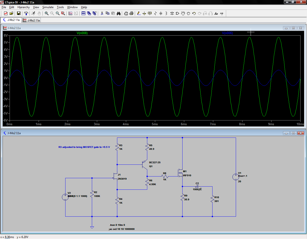

Up and running under simulation.
Gain 5.5x (15 dB), bandwidth ~1 Mhz, pushing just over 4 V p-p into a 16 ohm load, or over 11 V p-p into 300 ohms.
This is just before the onset of hard current clipping, the negative waveform is already heavily distorted (2nd harmonic) in both cases.
R3 adjusts the current through the JFET and hence the bias voltage across R4 which in turn fixes the MOSFET operating point. It can be made a 10k trim pot to allow full adjustment and channel matching.
P.S. Everything is ticking over quite smoothly. My only concern at this point that for low circuit gains of 3x or 4x the JFET gate-source voltage has to be fairly high, about 2 V, to lift the MOSFET gate up to the 9.5 V required. This generally means operating the JFET at an atypically low I_ds.
P.P.S. PSRR is 40 dB at 120 Hz, still 34 dB at 20 kHz. Not bad, considering it's a simple single supply circuit. Some sort of RC or LC filter stage or voltage regulation will be required. V+ ripple will need to be under 100 mV to avoid audible hum.

This circuit isn't quite "build-and-go", the circuit values are worked out as follows. The main issue is that multiple resistance values have to be optimized for a particular JFET. A near substitution of JFET model can probably be cleared just by trimming R3, but there is a risk of inadvertently choking off the current to the pnp transistor if R3 is set too small without changing R4 and R6 to compensate.
1. Choose the output stage operating bias and V+, defined by Vs and Rs, depending on the desired output power, headphone load, and thermal budget.
-> Vs 5.5 V, Rs 30 ohms, and ~~ 3W for V+ 20V.
2. Mosfet gate is Vs + 4 V = 9.5 V. The input stage gain x the JFET source bias voltage must equal 9.5 V.
-> JFET source bias can be from 0-Vturnoff. Choose a highish current JFET like the J111 with a high Vturnoff, so that he gain doesn't have to be to high to bring the output up to 9.5 V.
3. The J111 (and similar with Vturnoff 2.5 V - 3 V) seem to run about 1 mA at a source bias of about 1.8 V - 2 V. The current through the pnp transistor Q2 should be 2 mA or higher or more to make sure there it has enough control to keep everything working as designed.
-> This means that R3 is about X, and, to keep the gain and transistor currents in the right ballpark, R4 should also about X and R6 is about 5X. First roughtly estimate X based on the JPEG used, for the J111 it's about 680-950 ohms. After setting R4 and R6 from this estimate, the final tuning of the operating points can be done by trimming R3.
The J111 seems like a widely available model, so we'll run with that. Any n-channel JFET with Vturnoff of around 3 V should be able to be substituted. Using a smaller Vturnoff JFET is possible but R4,R6 will have to be adjusted to increase the gain since the JFET bias is not going to go much above 1 V.

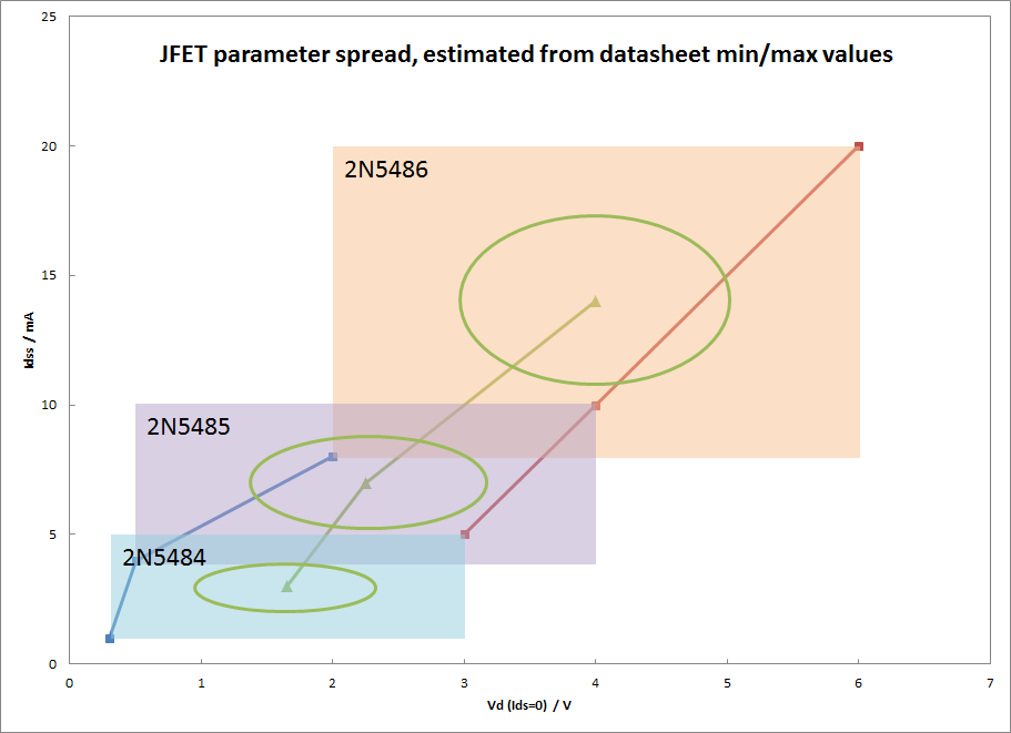

Matching JFETs
So, short story is this circuit is going to need well-matched pairs of JFETs. Which means buying 10 and picking the best 2.
Attached is a visualization for what to expect when buying 2N5484-5-6 series of parts. These are all the same JFET, just binned by the manufacturer depending on how they test.
Green circles indicate roughly the "most likely the part will measure somewhere in here" area.
Now, for the desired gain of 5-6x, and MOSFET gate of 9.5 V, the Vgs operating point should be about 1.5-1.8 V, and we are hoping for about 1 mA, so the target specifications are a Vd of 3-3.5 V and Idss of 5 mA. This is unliklely to be found for either the 2N5484 or 2N5485 parts. So either I compromise or look for another JFET.
Right now I'm thinking the 2N5485 looks pretty good, chances good of finding a couple around Vd = 2.5 V and Idss = 8 mA. That should be workable.

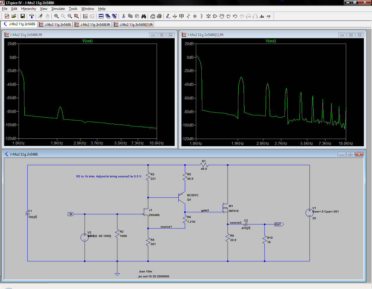

Latest LTspice results appended. This is the version optimized around the 4V Vp 2N5486. It's a relatively chunky FET and all the currents are increased accordingly. As far as the distortion calculations go, however, the results are identical with the 2N5485 optimized circuit: what I considered the point just before the onset of hard clipping, output 3dB (2V pp) into 16 ohms, gives -26 dB 2nd harmonic (~~5% THD). That's 120 mW or so output power. The harmonic progression is textbook simple, as expected for a single ended circuit.
Once slighty away from hard clipping, the distortion spectrum cleans up significantly with a falling progression of 2nd, 3rd and 4th harmonics, each peak -25 dB below the last.
At 1/10th the output voltage (1 mW output power) the 2nd harmonic is under -73 dB, so even though the simulation doesn't compute it, the 3rd harmonic is about -100 dB and everything else is in forget-about-it territory.
Simulations like this are pretty useless except to show problems. The conclusion from the above is that it's basically sound.
A fairer, and more correct assessment of the performance away from clipping is the 2nd harmonic is always about -50 dB lower than the fundamental, so the THD is 0.3 %, pretty much independent of output power. 90% of that is second harmonic. 3rd order and higher harmonics total about 0.03%.
The 0.3% 2nd harmonic is relatively high and probably colors the sound. This is most likely a characteristic of the MOSFET + source resistor single-ended output topology, and explains the mellow, distinctive sound of headphone amplifiers based on it.

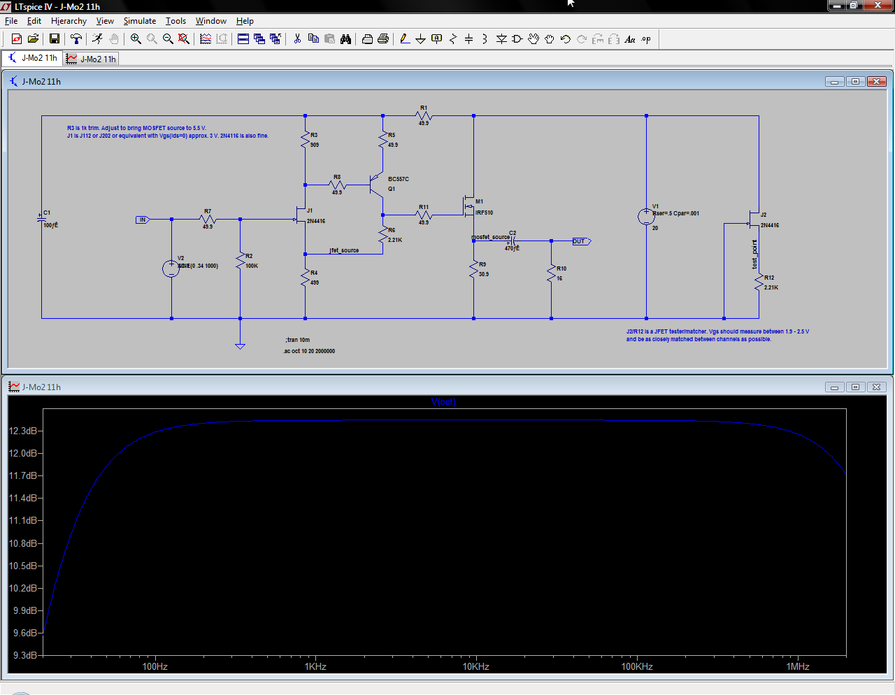

Updated ltspice file attached.
Spent some time figuring out how much tolerance I have in the JFET parameters, and which model JFETs can be used.
The restriction is I want a particular gain, I want the trim resistor R3 to be within range, and I want about 5 mA total current running through the input circuit (i.e. R4).
The other point is the JFET has to be a current, widely available model.
In the end I chose the J112. The J202 is a perfectly good substitute, and, in a nod to the original circuit, a 2N4416 can be also be used also if one takes into account the old school TO-18 package. All those should yield a decent proportion of useable devices.
The circuit shows a test jig that can be used when matching and testing JFETs. Bias the FET with a 2.2k source resistor and the source should autobias up to a voltage that is some statistical scatter. Anything in the range of 1.9-2.5 V (optimal is 2.1 V) should work in the main circuit just relying on R3 to make the final adjustement. The closer the JFETs can be matched between channels, the better.
The final word for now is: this is a nice update to the original, adding full 12 dB of gain and optimizing (as best as possible) for the full range of headphone impedances at the cost of only one additional transistor and - this is important - no loss of performance. The noise and distortion of both circuits are determined almost entirely by the MOSFET stage, and, just like the Szekeres they are based on, are not great. It's intrinsic to way this circuit works that there is a lot of 2nd harmonic distortion. These headphone amps are about achieving a nice, pleasant tone rather than the last word in transparency.

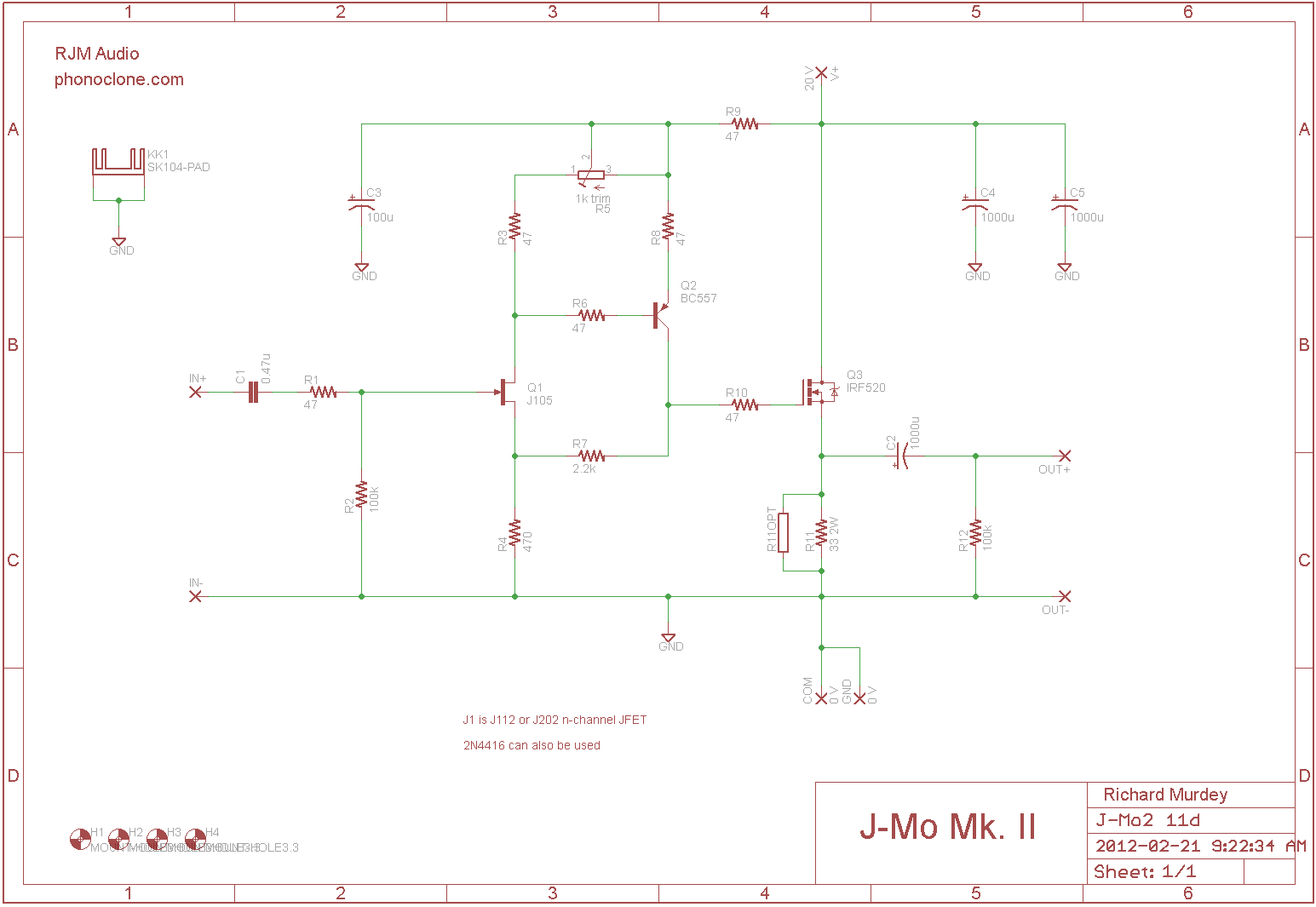

Eagle .sch file attached. No .brd file yet, you are one your own there...
Schematic has some extra resistors added, some are for safety and some are for stability, some like R1 and R6 are probably not needed, but don't hurt.
R11OPT provides an optional set of pads when using a TO-247 package resistor for R11. Replace as needed if you want to use those Vishay RTO-20 power resistors or similar.

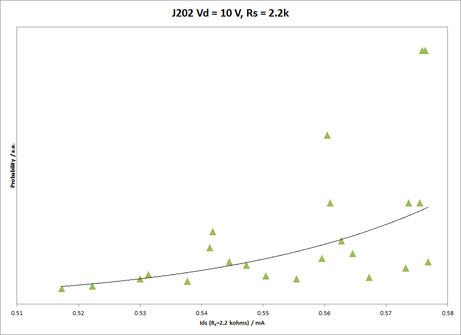

Note on JFET matching
J202, 10V, Rs=2.2k, 25 samples
Bias current was found to range from 0.507 mA to 0.582 mA. The average is 0.55 mA, std. dev. is 0.02 mA.
From 25 samples, it is possible to obtain 7 pairs matched within 0.5%, or 11 pairs matched within 1%. Clear sailing.
The distribution is a truncated shape, clearly the parts have been "binned". Lower and higher current parts have been removed to end up as J201 or J203, respectively. The J202 parts tend to cluster towards the high current end, which helps when it comes to finding closely matched pairs.
