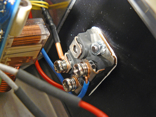

I known SOT-227 MOSFET
Used in Gamut D200I SOT-227 case manufactued from Microsemi but I think it's look like IXYS, too

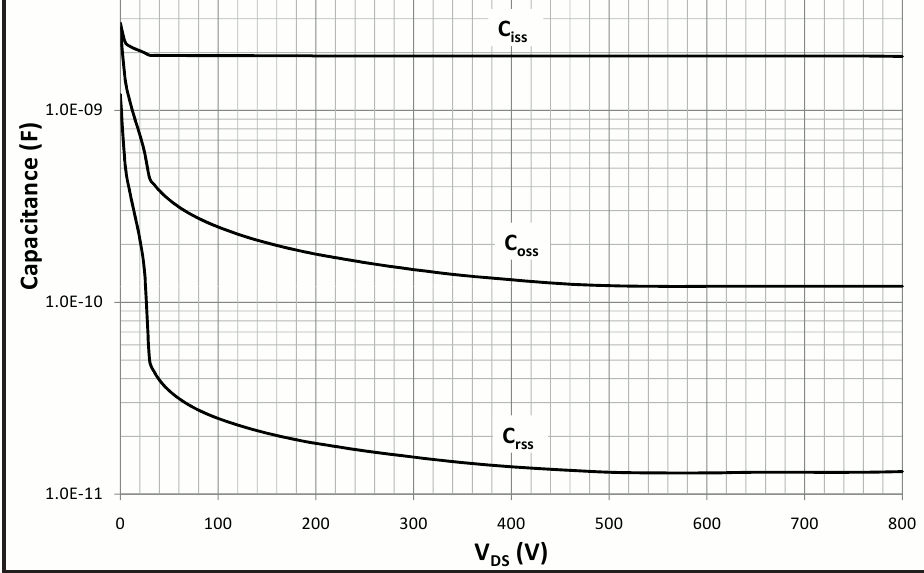

Like those SemiSouth SiC JFETs, this looks like another device that's going to have to run at higher than usual voltages (attached). You could run 'em as source followers operating into an OPT at 600Vdc.
The SiC JFETs looked to be very linear. Not too sure these are so much better than Si MOSFETs operating at more convenient voltages.
