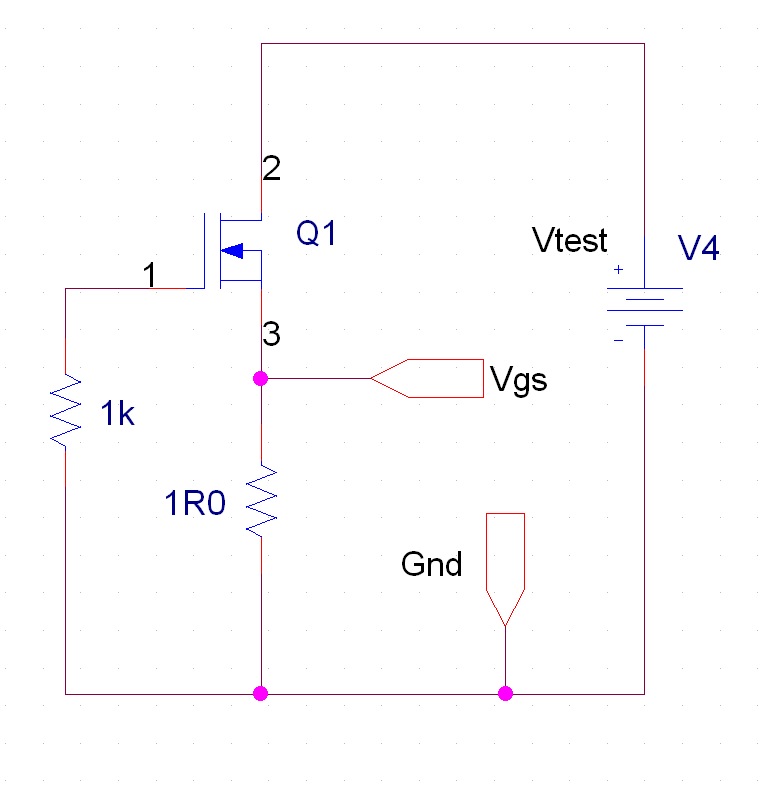

I will say this, though. I just took one of the devices I got got from Mouser and loaded it on to a heat sink with a 1 ohm source resistor and a 1k stopper resistor from gate to ground. The drain current is constant at 2A with a 1 ohm source resistor, so this means -2V Vgs for 2A Id. A person with a somewhat nominal amount of savvy can use these values for starting points and forge on.
It also means that these devices are real-deal depletion mode mosfets and not re-marked fakes, as a normal enhancement mode fet or other piece of random junk would display absolutely no drain current (or maybe a dead short for an extreme piece of bilge) under the conditions described.

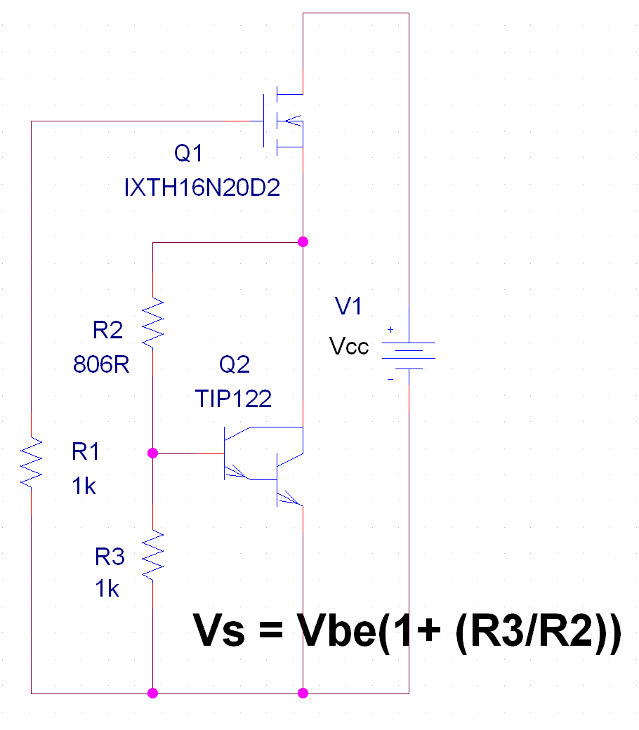

Another dodge would be to replace part of the resistive drop in the source with a semiconductor junction that has a low incremental impedance. This would allow the Ixys fet to bias up with a desired current level but with higher gain, since there is less impedance in series with the source. Assuming I want to keep the same drain current as cited in the above example (2A), one choice would be to use a power Darlington with base connected to drain (~1.1V, a TIP121 or similar would work just fine) in series with a 0.47 ohm resistor. The slightly varying voltage drop with current of the Darlington may provide distortion cancellation (or distortion augmentation, who knows?).
Of course, one could also make a Vbe multiplier using the Darlinton and a voltage divider connected from collector to base to emitter, so that it provides all the bias necessary to park the Ixys fet at a given drain current.
Here's an example of a Darlington Vbe multiplier used in the source of a depletion mode fet for bias. With the values shown, the bias voltage in series with the fet source is ~2V.
In the end, it's often easier to come up with a negative voltage reference to
bias the device. With the SIT-1 and 2 I simply put the power supply RC
filter on the negative side and use the voltage drop across the R - filtered, of
course
Sticking your choke in the ground leg, eh? That's a nifty dodge for a small negative supply. As always, I'm looking for perverse solutions, being that kinda guy. I haven't had the occasion to use a negative supply to bias any of my fake SIT designs as of yet, though it's been in the back of my mind as a possible option should I need to.
The negative supply would definitely be a possible option for the Depletion mode fet mentioned here in a "Delite" kind of application.
My first use of these fets will likely be as a topside current source load for one of my fake SIT amps. Using the combination of Darlington dropper and resistor may make it possible to have greater freedom in tailoring the gain of the topside current source should I choose to modulate it. This might be usable for tailoring the distortion characteristics of the amp. If I could figure out how to get external libraries added into my PSpice, I'd give it a go in simulation. So far PSpice doesn't recognize the downloadable Ixys libraries for some reason.
Yes, you did wait a long time. I have a possible app using these fets that is a variation of some classic Zen and First Watt schematics. It looks as if the design may be equally applicable for a single supply capacitor coupled or dual supply DC coupled approach. More details when I hone my simulation better.
