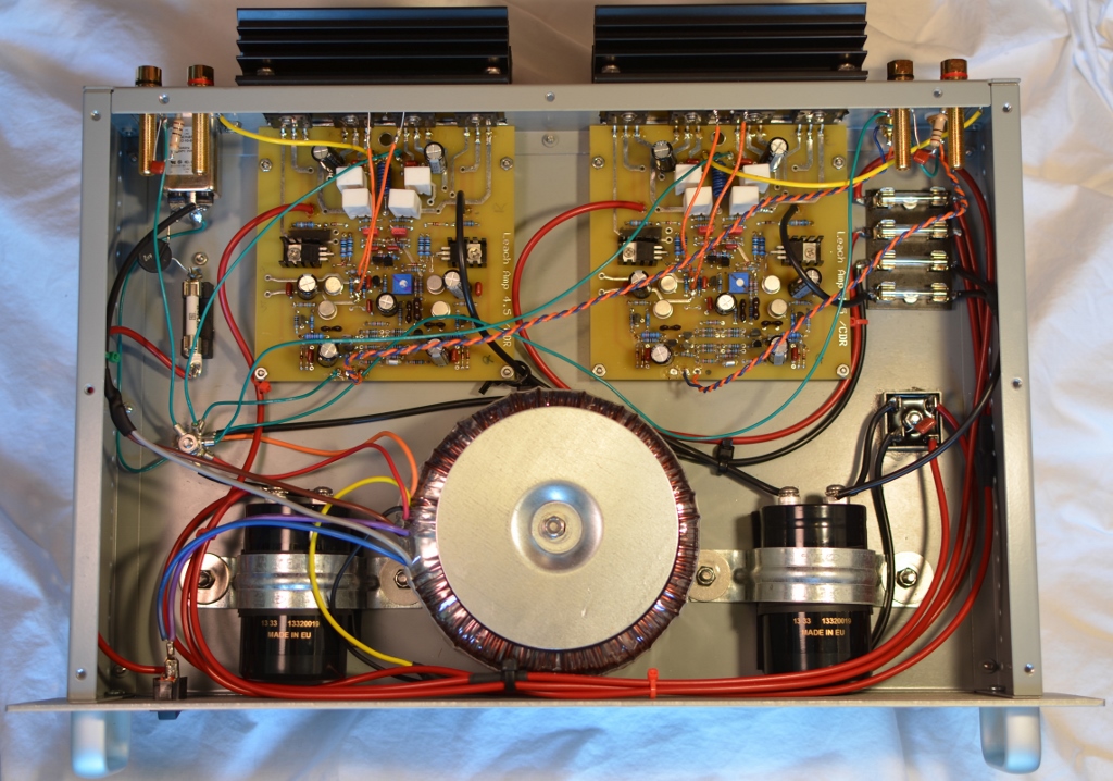

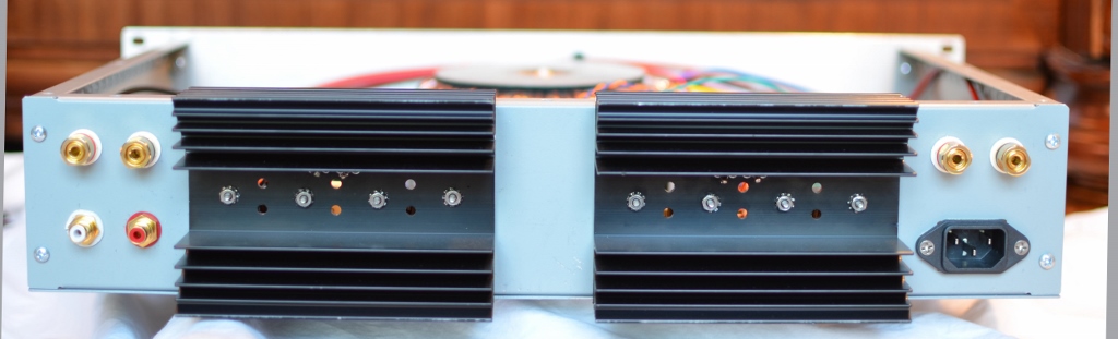

I have written a 37 page step by step guide with tons of supporting pictures, layouts, BOMs and hints to building your own Leach amp similar to the pictures you see attached. The guide will give you one click links to order every part needed. It provides prices for each component. You will find the the guide only in this thread and supporting documents in the next message and on Google Drive in the link below...
I couldn't upload everything to this thread due to the 1Mbyte size limit so I've provided a link to my Google Drive share below.

Neville, I'm not entirely familiar with the Pass F4 or Aleph J but i've reviewed the output stage and in my opinion the Leach amp is a much higher end amp than these. Pass F4 is a class A amp running 50 watts into 4 ohm with two output transistors. Alepha J is running 25 watts (probably into 4 ohms). According to Dr. Leach, if you increase the bias current to run in a similar class A mode, this amp would be 1200Watts into 4 ohms but is not recommended as it cannot dissipate that much heat with the heatsinks in this design (The Leach Amp - Output Stage). The leach amp is an extremely robust and beautiful sounding class AB 200Watt amplifier with 4 output transistors (double the Pass 4 per channel).
As for the PCB cost... well unfortunately i have not found a cheaper option unless you are willing to build with friends or find others on this forum to divide the cost. It is cheaper per board to build 10 at a time than just 2.

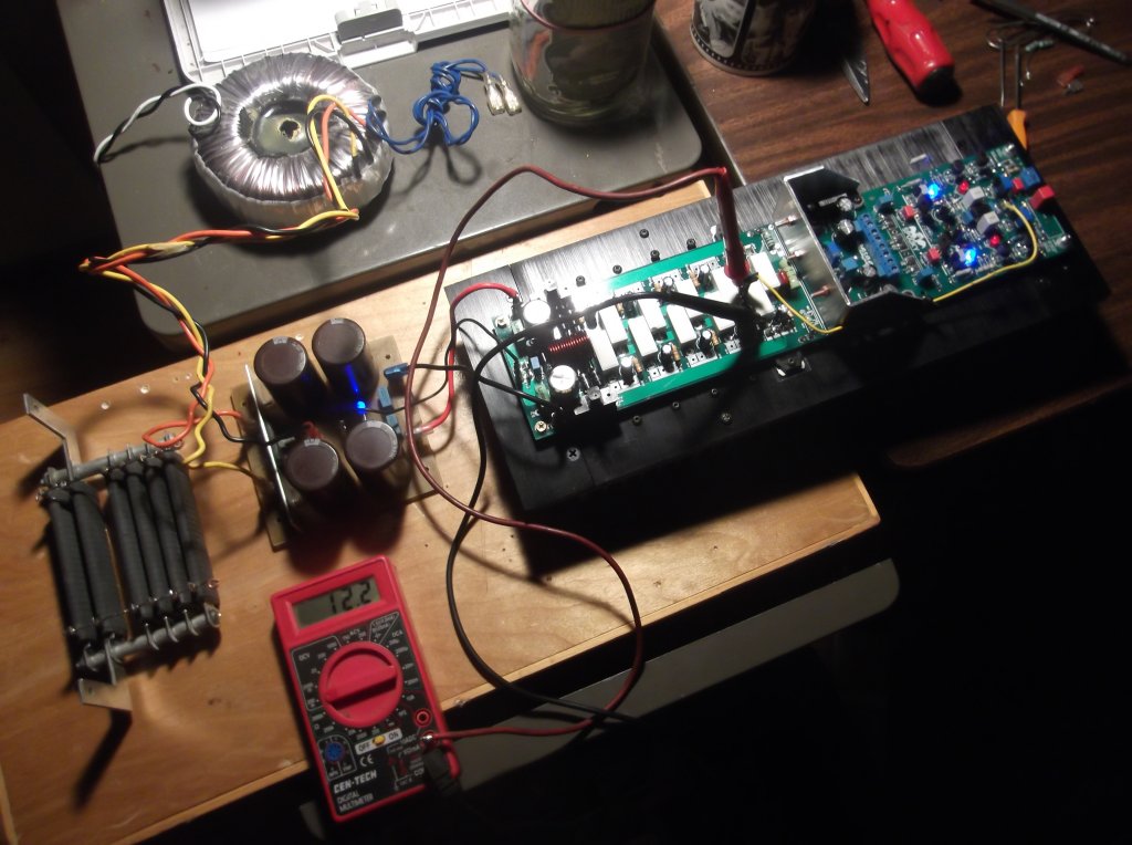

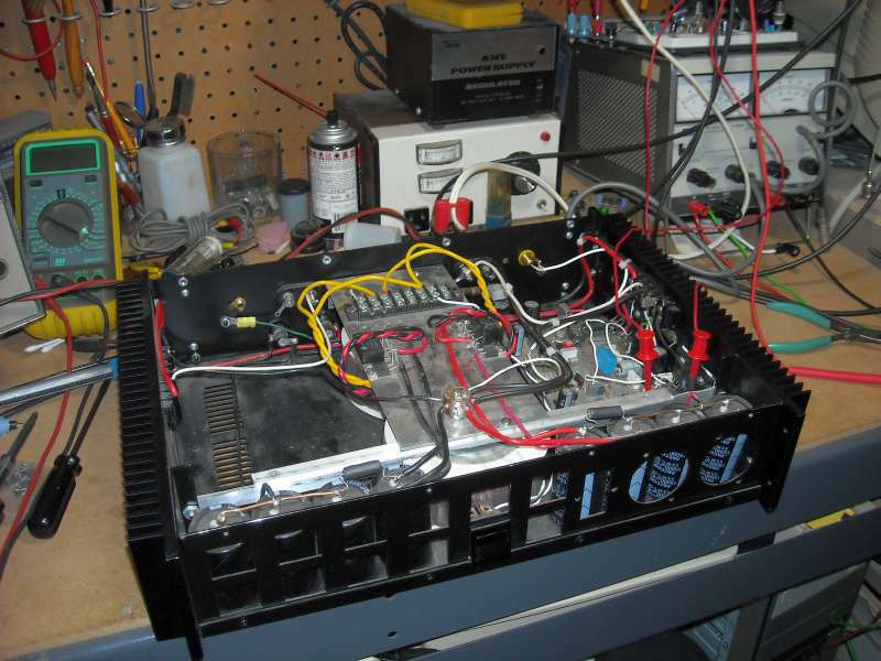

Here's a version of Leach's amplifier using ThermalTrak NJL3281/1302 perforated emitter (fast and linear) output transistors I've only just gotten to the listening stage. First one I've built with plastic case devices and toroids. Rails are 54 vdc and about 60,000 uF of capacitors. I wanted a much smaller chassis than my original amplifier and I think this one looks better.
I've been building Leach's design since the 70's and can attest to the good quality of the sound and reliability. Well, mostly; I had a major failure that cooked a woofer thanks to some bad judgement on my part; I had the bias turned up for minimum distortion and I think the bias diode string went open circuit after years of being toasted. I'll use the recommended fuses and less bias in the future.
I typically measure THD at .005% at one to ten watts over most of the audio range, typically rising with power and frequency.

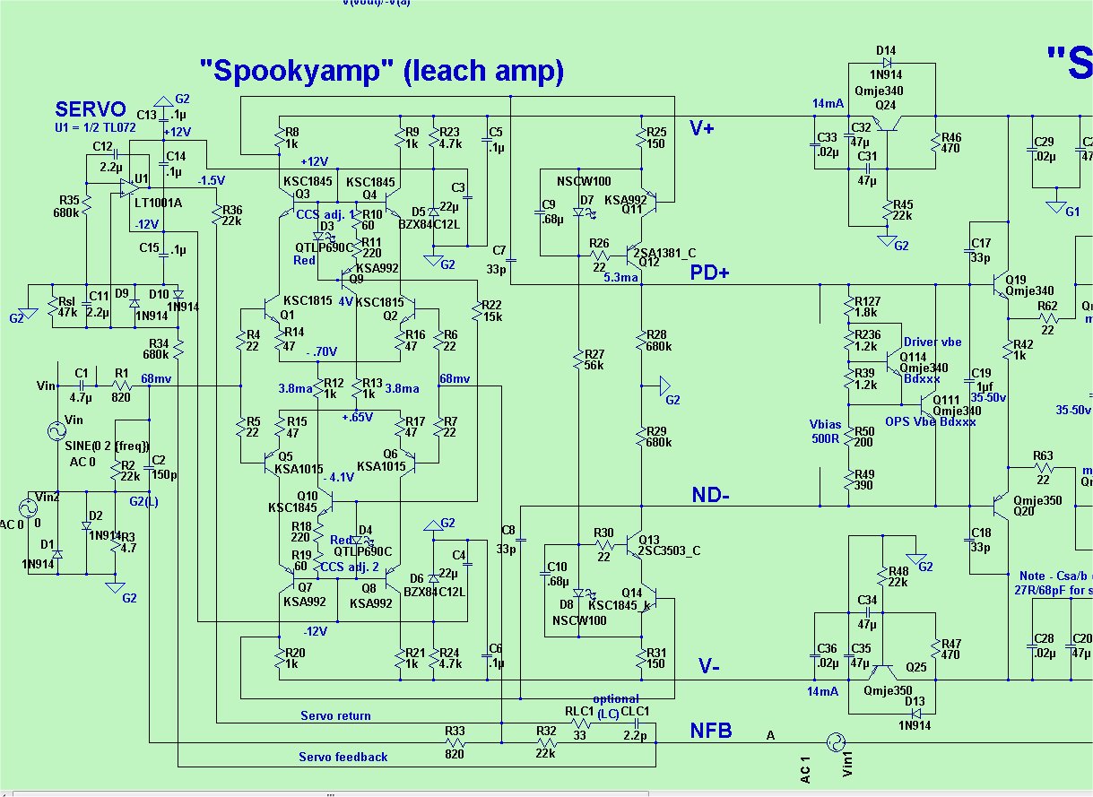

(below 1) is a leach with hawksford VAS , CCS's , and a 2 device Vbe EF3
- no diodes to burn - 1mv thermal stability. (outputs as drivers !!)
(below 2) is the 5 pair / 400w leach.
I only have 2 pair outputs now (need mica). Does .002% 20k 200w.
It does sound good at 100w ( 2 pair is 100w @ 8R - 5 pair 250w).
If you want your 2 pair setup to "do the watts" , Semelab has the
outputs - http://products.semelab-tt.com/pdf/bipolar/MG6330 MG6330-R.pdf
Those would be drop in replacements , and you would really be 200 8R/300 4R.
Equals about 4 pair typical fairchild/ON semi current ratings .
OS

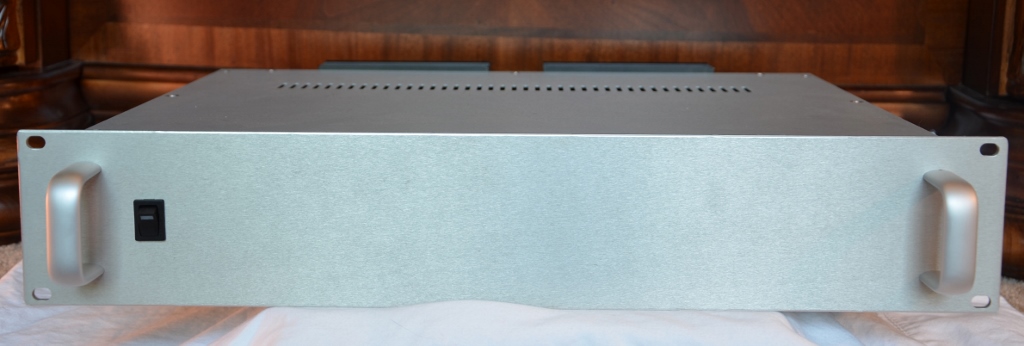

- I've written a complete guide to building your own Leach Amp 200Wx2 in 2U rack mount
