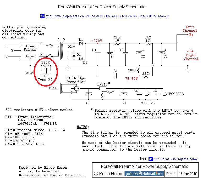

Greetings, Friends. Hope the turkey was good. I was looking at schematics over at DiyAudioProjects.com and found Bruce Heran's DIY ECC802S (12AU7 / ECC82) Tube SRPP Preamp with a nicely drawn Power Supply schematic with an interesting detail I've been missing:
Where the Earth wire is clearly connected directly to the chassis for safety, the b+ ground is connected to the chassis through a resistor/capacitor in parallel, a 0.1uF Type X2 cap designed for this purpose and a 150R 1/2W Metal Film Resistor. In a linked text, Heran goes on to elaborate on his grounding scheme and directs the reader to connect both the power supply's ground and the signal returns to the chassis, at a single point, through this filter network. Connecting those grounds directly to the chassis would create ground loops, but the filter network blocks noise from entering the circuit while allowing the safety features of the Earth wire to function. Up til now I've been connecting all grounds directly to the chassis and now must determine how best to re-wire some projects to eliminate this direct connection and hopefully excise some noisy demons that have been vexing me.
Which leads me to the phono preamp. How should the ground wire from a 1200 mk2 turntable be connected to the phono preamp? Does it connect to the Chassis/Earth or should it connect to the lifted/isolated ground network in the preamp?
What about the heaters? If heaters should be referenced to Ground, should it be the Chassis/Earth or the isolated Ground? I usually reference the heater circuit to a power tube's cathode anyway.

The turntable ground wire goes directly to the preamp chassis.
Heaters are referenced to the audio ground, not the chassis.

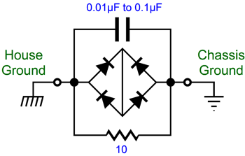

High current diodes (one in each direction) can go in parallel with the resistor/capacitor to the chassis.
This shows a 35A diode block being used.
Reactions: NIXIE62 and dubadub
It's important to remember that any isolating elements between signal ground and chassis/PE ground must be able to survive a worst-case fault, likely B+ level to chassis, long enough to open the fuse, and be low enough impedance to ensure the fuse opens reliably.
The proposed 150R of unknown wattage rating may not do this, and shouldn't be trusted. Large back-to-back diodes may not be code or UL, but are our best choice. The small (typically 10R) resistor in parallel is just there to overcome small residual leakages, keeping the normal, non-fault, voltage across the diodes near zero. It can be small wattage without danger.

Therefor normally 10 Ohm 2W is chosen (when the Graetz bridge is omitted). It also helps to use the correct terms and to have some carved in stone rules.
A metal casing/chassis is always connected directly to PE. Audio GND (secondary side of PSU) can be referenced to PE by means of the resistor/cap combination. An error from the past is to use chassis as GND but the casing/chassis should not be part of the audio circuit.
What is house in this image? As in house earth? If so, it is wrong as chassis must always be directly connected to earth. Every other gnd connecting to chassis is lifted as in the picture.
Check the schematic you posted again: the author uses a voltage divider from B+ to elevate the heaters above cathode. That way no noise from the heaters will modulate the cathode potential and show up on the anode.
