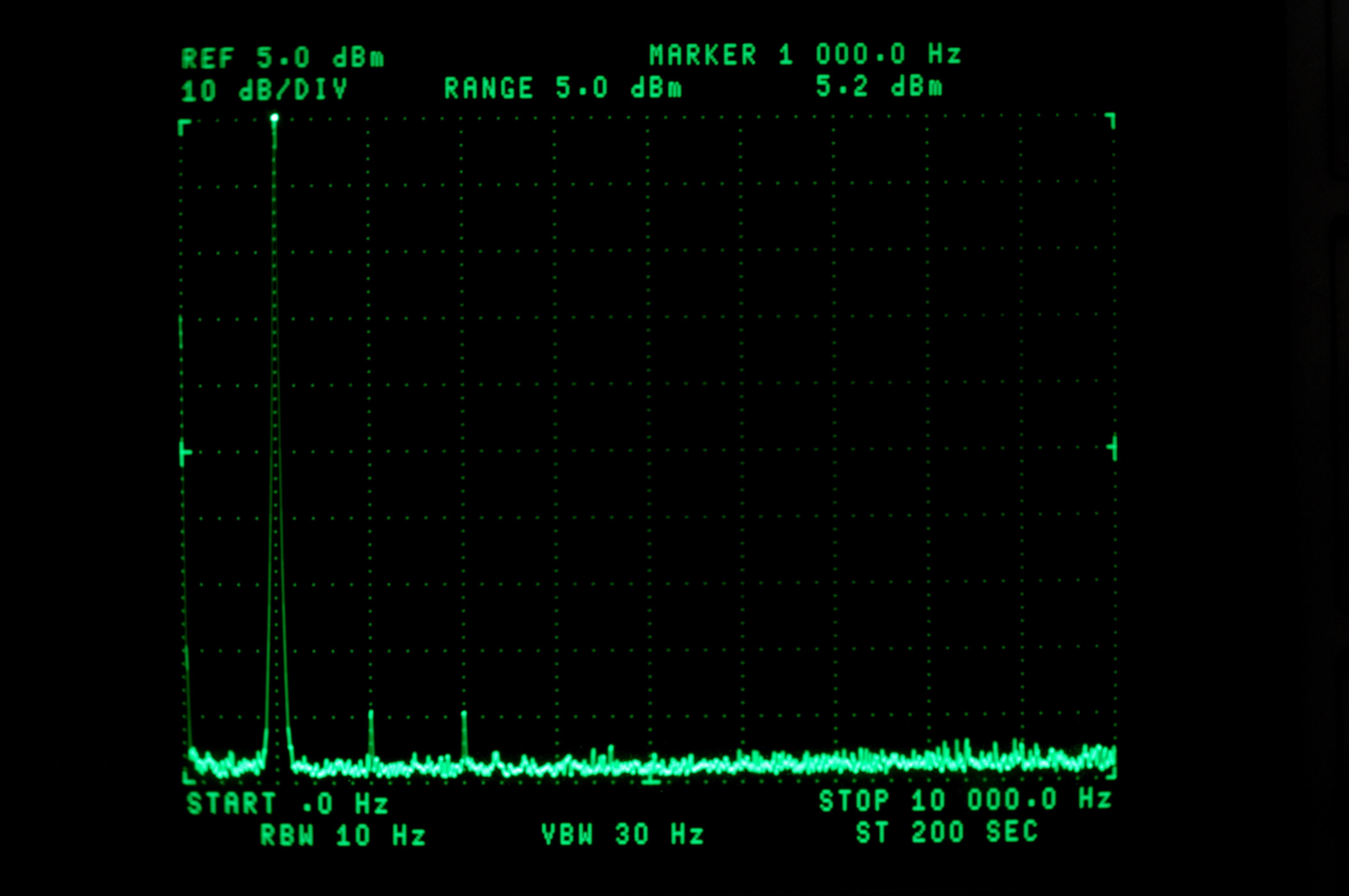

Anyway, this quality of reproduction thing had me wondering. Previously I've used Audacity to play 1KHz tones for testing amps using my MacBook Air, which was pretty good. I wondered what sort of THD performance I could get playing a prerecorded tone on my iMac via an airport express over our home wifi network.
I started by creating a 30 minute long 85% volume 1KHz tone at 44.1Ksps using Audacity. I exported this as a 16 bit AIFF (apple lossless) file, and simply double clicked on the file in finder to get iTunes to play it. I turned the actual speakers off and played via an airport express at full volume plugged directly into the 1MOhm input on my HP3585B spectrum analyser.
The plots attached show the result.

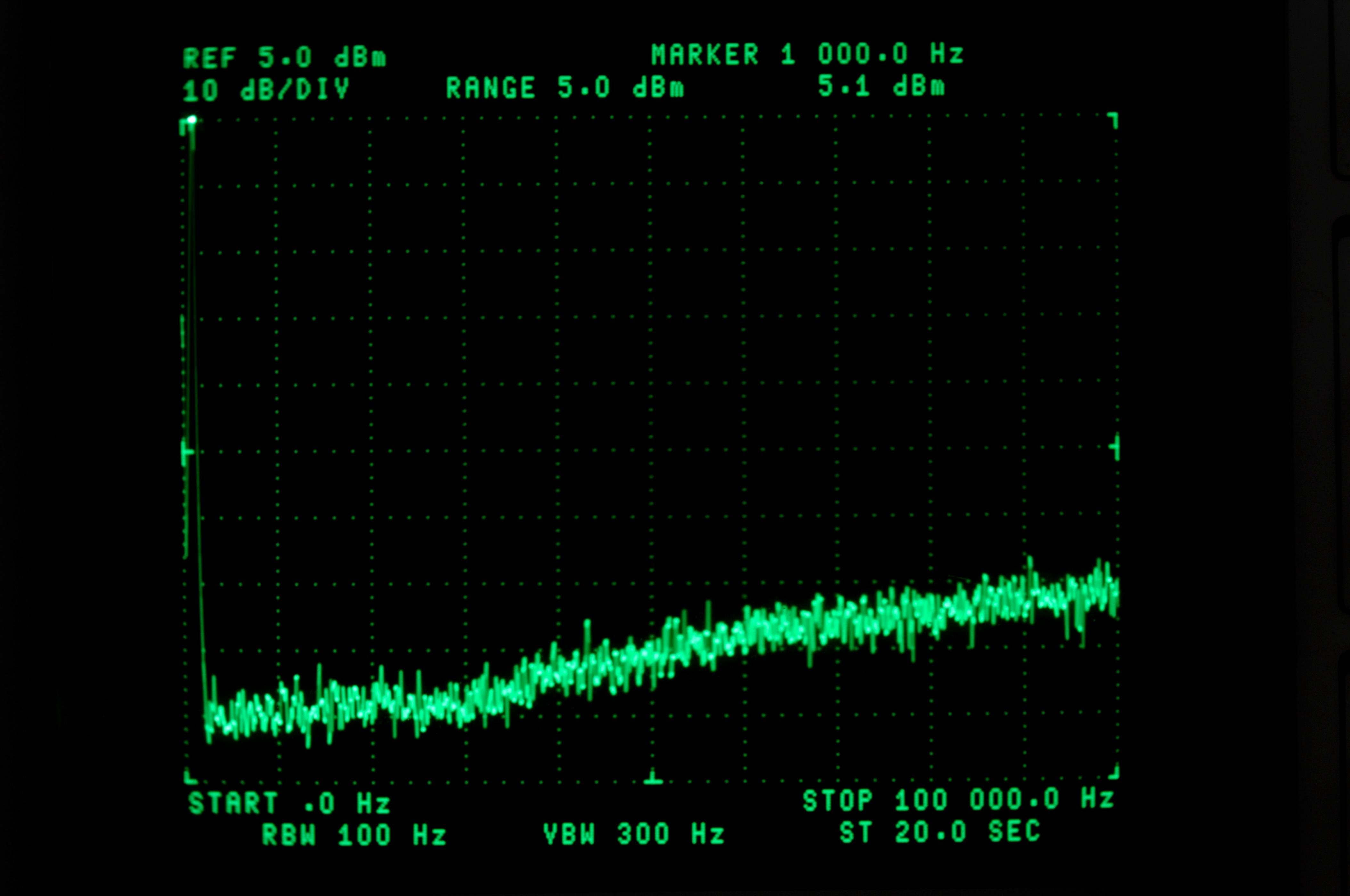

First is DC to 100KHz, showing the 5dBm 1KHz sine wave and not much else. SINAD here is around 90dB up to 30KHz, limited more by the resolution bandwidth I was using for the plot.
Next I wound the span down to DC to 10KHz, with 10KHz resolution bandwidth. SNR is ~97dB, as one would expect from 16 bit samples. There's some distortion at H2 and H3, but this is typical for my spec-an.

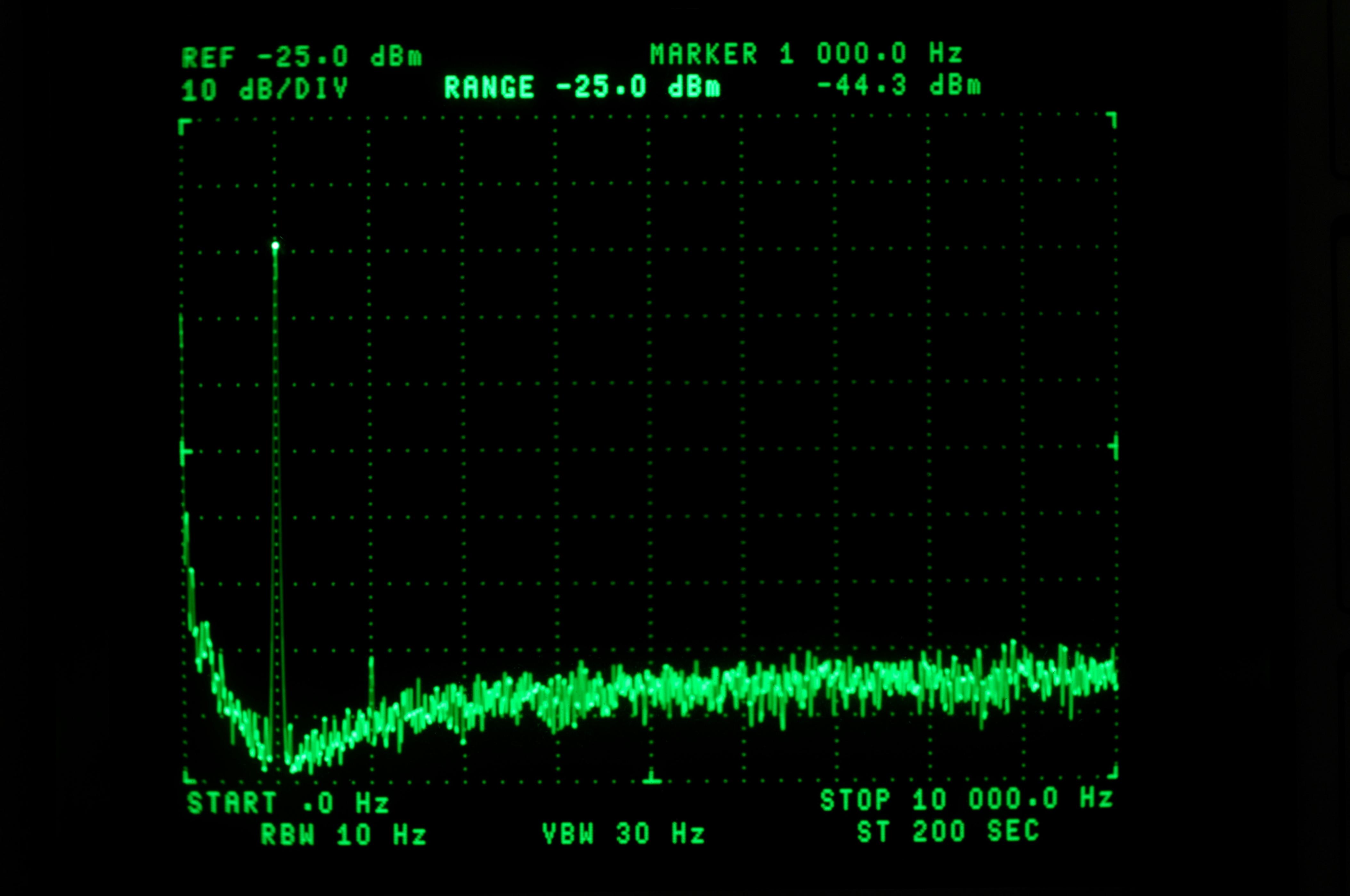

Last plot is with a 1KHz passive notch in circuit. This attenuates the fundamental by ~50dB, H2 by 9.6dB, H3 by 5.8dB, and H4 by 4.1dB. Our fundamental now measures -45dBm. H2 measures -106dBm, and H3 and onwards say -110dBm or better.
So I make H2 in reality -96dBc, H3 onwards ~-105dBm. I'd say that was reasonably good.
