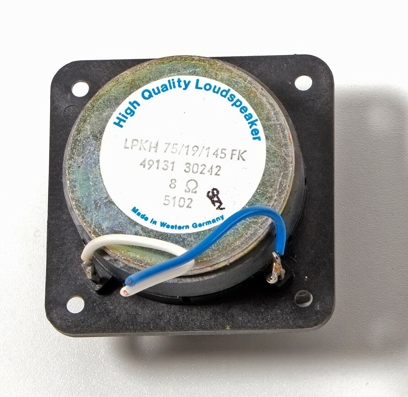

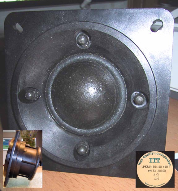

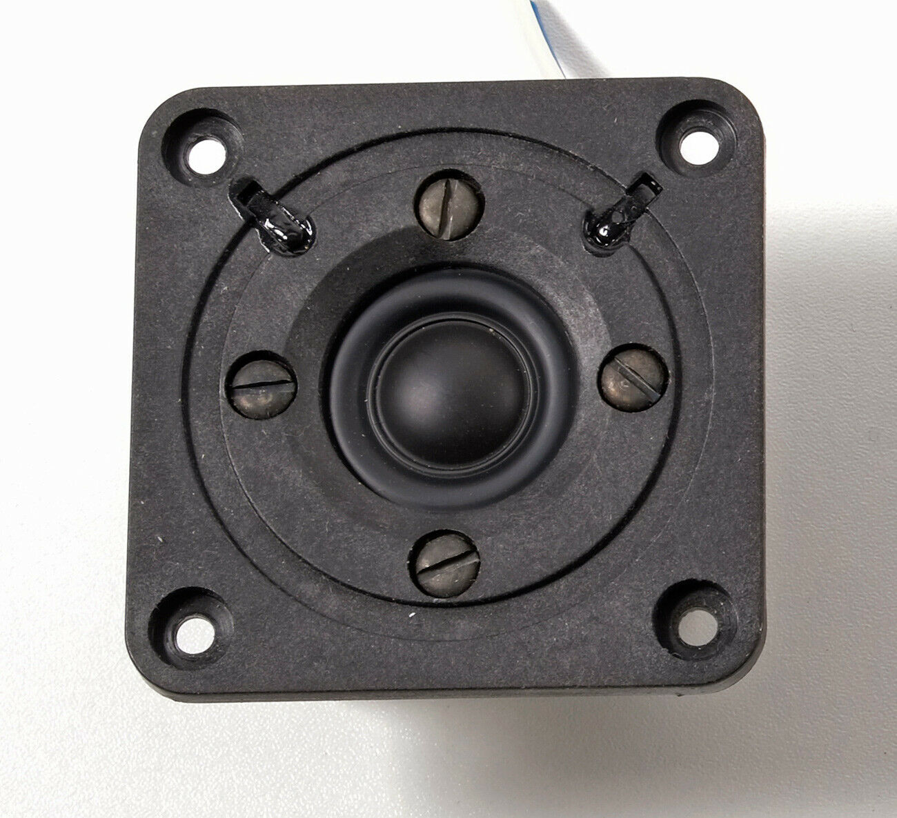

Hi Cloth Ears,
here's some picture from the ITT Midrange.
I bought mine in 1979 (about 35$ CAN ).
Those midrange has been used in B & O loudspeaker and maybe in some 3 way Revox Studio Monitor (I'm not totally sure)
Even today they sound fine.
I don't have the spec anymore.
But they should cover from 2Khz to 5Khz.

OK. I checked out the speakers and Martin Colloms book and they're definitely the same speaker. A 50mm fabric dome "double suspension" midrange (courtesy "SEL/ITT"). From the back of other ITT cone midranges and tweeters in the same shop (there's quite a few of them), they were manufactured in West Germany - and they have only the "ITT" on the back with no mention of SEL. They are a closed chamber design (I'd guess about .4-.6litre), but the chamber is held on by 4 bolts that you undo through the faceplate.
Michelf, do you know the designation of the speakers that you have? And I could not see the picture that you posted - any chance of posting it again?
Christopher - thanks, you picked it in one (being the driver in Colloms book - page 188 in the 4th edition).

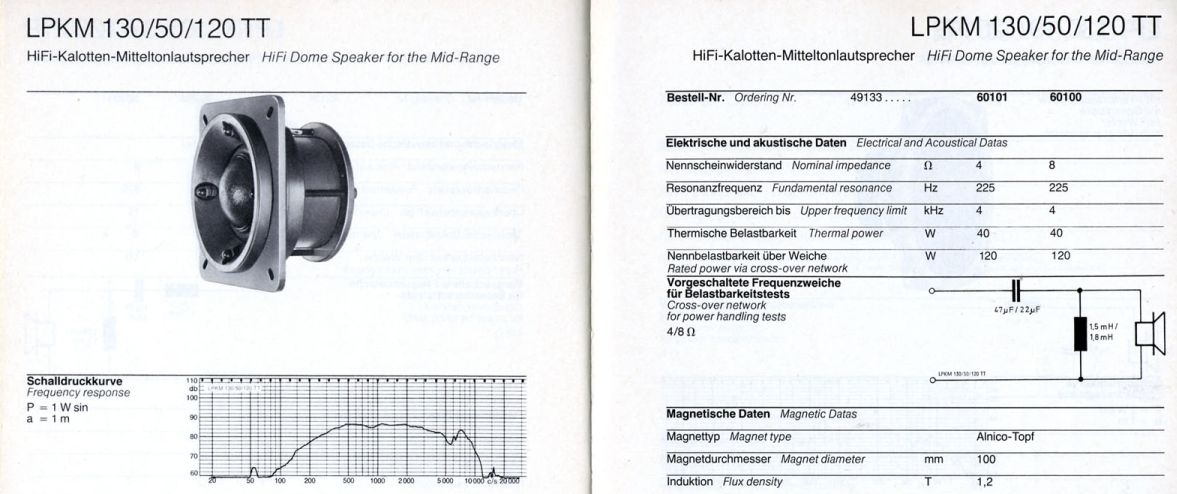

Check this link
http://www.caninialtoparlanti.it/images/mid-ITT.jpg
This ITT Midrange was the replacement of the ITT midrange pictures that I posted.
The parameters may not be the same but they probably close.

I didn't get back to you last year, michelf, but this is exactly the speaker I have and the specifications were exactly what I needed. I didn't want to start designing with them without first knowing the original specs and ratings (it's all very well measuring the the output response - but if they're only rated for 10 W and you want them for 100W... you get the picture🙂
So, it might be late, but thank you, merci beaucoup!

These is an old ITT model .If i remember it has a resonance frequency 220 hz and was perhaps the best mid in 70s.The later model was with double ferrite magnet.Attention it must be used with cross between 400 to 2000 hz because of the low frequency resonance.It was used by many constructors as Audiolab ,saba,in england by stuart engineer,and in other companies in nord Europe.
