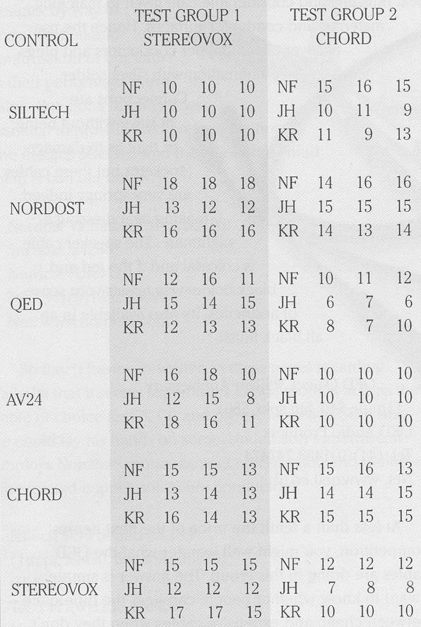

Finally a Hi-Fi glossy did a blind listening test on cables. Following cables sets (both interlink and speaker) were tested (set price in UKP, multiply roughly by 2 to get US $, in brackets):
Nordost (UKP 6500), Siltech (UKP 7700), Stereovox (UKP 10300), Audience (UKP 2000), Chord (UKP 1650) and QED (UKP 120).
Blind test, three listeners, using 3 separate pieces of music each trial.
They did a clever setup: the first cable set was by definition rated 10 points, so each following one had to be rated more or less than 10, better or worse, as to preference rather than specific attributes. A neat way to assess preferences without going into the numbers fight.
Sounds pretty well thought out and logical, right? Wait till you see the results and what they did with it...
Below are the results in raw data. Now, some of you will tell me this is copyrighted material. I know. I looked up this issue, and it appears that it is accepted practice to quote some limited parts from an article with the sole purpose to facilitate discussing the issue and with full acknowledgment of rights, and without any commercial purpose. So here goes:
The table below is from Hi-Fi+ magazine, UK, Issue 34, page 22. Copyright Hi-Fi+.
What do you think of this? Hint: look at the 1st group score of the Siltech (approx US $ 15.000) and the QED (aprox US $ 240). What would you do as the editor of the magazine?
Jan Didden

OK, here's the deal.
Recognizing that the first trial results fly in the face of established "belief", they decided that
" Well, the Siltech cables and the Hovland electronics obviously don't get along". Sooo, we delete the results of the first trial for the Siltech, we take the 2nd trial results for the Siltech and copy those into the 1st results table so that we get the same number of results ...
You will also note that the Nordost finished high. That makes them happy, because it is " ...an empathic justification for our faith in its abilities"
They really continue to expose their prejudice that enabled them the fraud so apparent in the first part when they say "Equally apparent (and reassuring) is the audible gap between the expensive cables and the budget QED". Well, the gap wasn't apparent until they "fixed" it!
I mean, how can anybody in his right mind take these guys serious anymore?

Stuart,
I don't think they are amateurs, the way the set up the test seems quite professional. And since they did such a good job, I am allowed to accept their results, no? They published them, so they must stand behind them. And the results say that in the first trial ALL cables, including the lowly $250 QED , were preferred over the $15.000+ Siltechs, by all listeners with all music. Doesn't that tell me anything about cables?
But there is more:
"[the Stereovox did poor wrt their prices] "Yet having listened to them in isolation I'd consider them worthy of higher marks", and goes on a search for arguments.
There, in one fell swoop the guy invalidates his own carefull blind test and exposes his nakedness. Amateurs? This is an insult to any half-intelligent reader!

Dave, you obviously read the article. What do you think of the reasoning why JH did such a lousy job on the QED (best in one series, worst in another series), while being quite consistent with the others? They couldn't use the "equipment (in)compatibilty" thing again, they used that already for the Siltech.
So they throw this one on testing stress, isn't it?
Now if that is the case, why is it that it only influenced the QED test and not the others?? Because in the other tests he confirmed their beliefs. They even say so much a few times!
Laughable if it wasn't so sad.
Jan Didden

Hi Jan,
No I did not read the article, I just looked at the scores on your attachment.
In answer to your question:
I think Jekyll Hughes was probably so mortified that he scored the QED so highly in test 1 that he went out of his way to balance up the ratings in test 2 and thereby retain the reverance we all have for his platinum/gold/titanium/beryllium composite ears.
