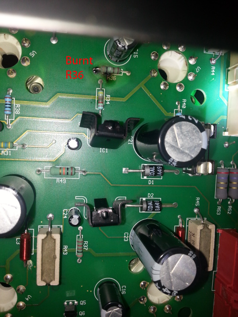

I had smoke coming out of the right side of a Mcintosh MC2000 amplifier.
No tube flashes and the left channel continue to play with both the blue meters all lighted (but not moving).
After the amp cooled downed, I opened it up and saw that resistor R36 has burnt (visible burnt marks, supposed to be 30.1kohm but it now measures 202kohms). The output stage fuse is ok.
I am wondering if there are tube schematic experts here who can help me figure out what other components that I may need to replace in addition to the burnt resistors? There are 2 npn transistors and I am thinking about the 2 output KT88 tubes.
Many thanks for your help
Marcus

Yes, you're on the right track. Check the output tubes and both transistors, and the C12 and C15 capacitors.
You can use the diode test function on a dvm if necessary. Make sure the base-emitter and base collector junctions are good on both.

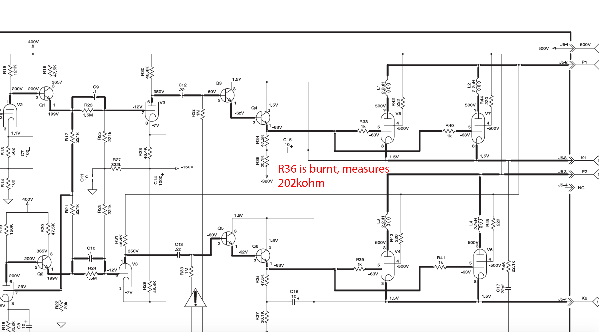

Hi , I agree and would also check the 320 and 60 volt sources. A power supply fault, particularly in the -60 supply could cause the problems.
Yes, and having the full schematic would help.

Q3 and Q4 are emitter followers used as buffers driving the Kt88s..The 31k resistor that burned and C15 is probably all that has to be replaced if the unit still plays..If the unit is not playing,you need to check for collector to emitter shorts or collector to base shorts on Q3 and Q4.

R34 is burnt also. look closely, it is dark in the middle. you had a tube arc. throw that tube away, check the transistor and replace the resistors and you should be fine.
Thanks again. I will replace R36, R34, C12, C15 and the 2 transistors. I may replace the 2 KT88s too. I didn't see the tube arc and they were fairly new SEDs.

Replace the tube(s)! In most cases a problem with one of the output tubes will be responsible for the damage you have seen.
Do check the transistors as well.

I just tested the transistors. Q3 is shorted. Q4 measures ok.
R34 is burnt visually but measures ok. To be on the safe side, I would replace all the 2 transistors and the 2 resistors.
It is hard to probe C12 and C15. So I will test them when I figure out how to remove the PCB board.
I didn't see the tubes arc-ed, so I guess I will have to replace both of the KT88...It's a pity since they were fairly new.

It isn't unusual for new output tubes to arc a few times. Is there any warranty? Do you have another more robust amp you could install them in, to burn them in?
Probably not a bad idea just to purchase them burned in and matched, a number of vendors offer this service. Greatly reduces infant mortality and the resultant collateral damage as well as providing well matched pairs or quads.
You guys are right! There is a bad output tube. The local tube seller I brought the tubes from tested them; one of them is bad. I wasn't able to find a single SED Winged C to replace the bad one though. They are hard to find.
