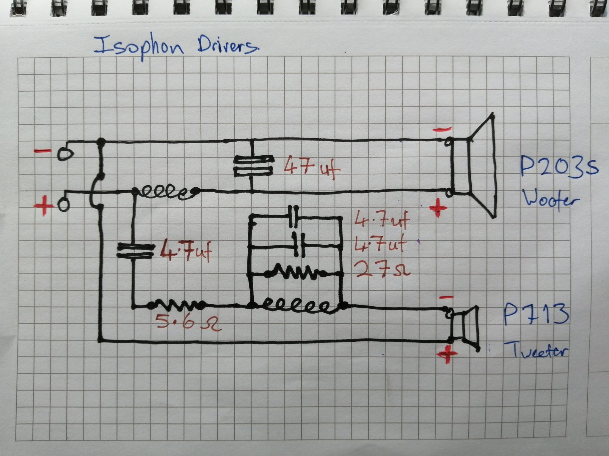

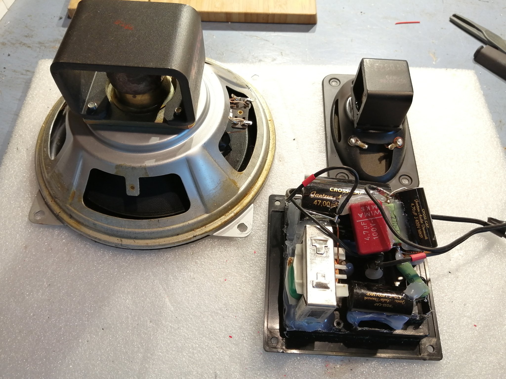

I got a pair of speakers years ago that consisted of Isophon drivers (P203s and P713), Mission cabinets, and a modern crossover that was made using the original inductors and all new resistors and caps. I'm making some new baffles for the drivers that will be placed in vintage cabinets.

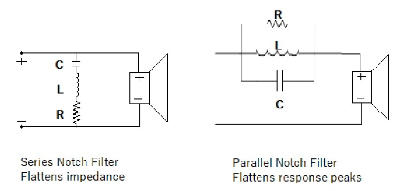

However I have no experience with crossovers, and having drawn out the crossover circuit (inductor values unknown) I'm wondering if it was based on an old crossover circuit or is it a basketcase design. I can't find any 2 way designs that use this tweeter network. Is it a midrange filter?

It would be worthwhile experimenting with the +/- tweeter wiring in order to determine what sounds best to you in the new cabinet.
I reckon that the value of the 4.7 uF capacitor that precedes the 5.6 ohm attenuating resistor could usefully be increased to better integrate the "tweeter" with the "woofer" - something else to consider experimenting with when your new cabinets are complete.

Cheers I'll try that out. Think I have some 10uf polys but that might be too much(?) or some electrolytics in series for testing.

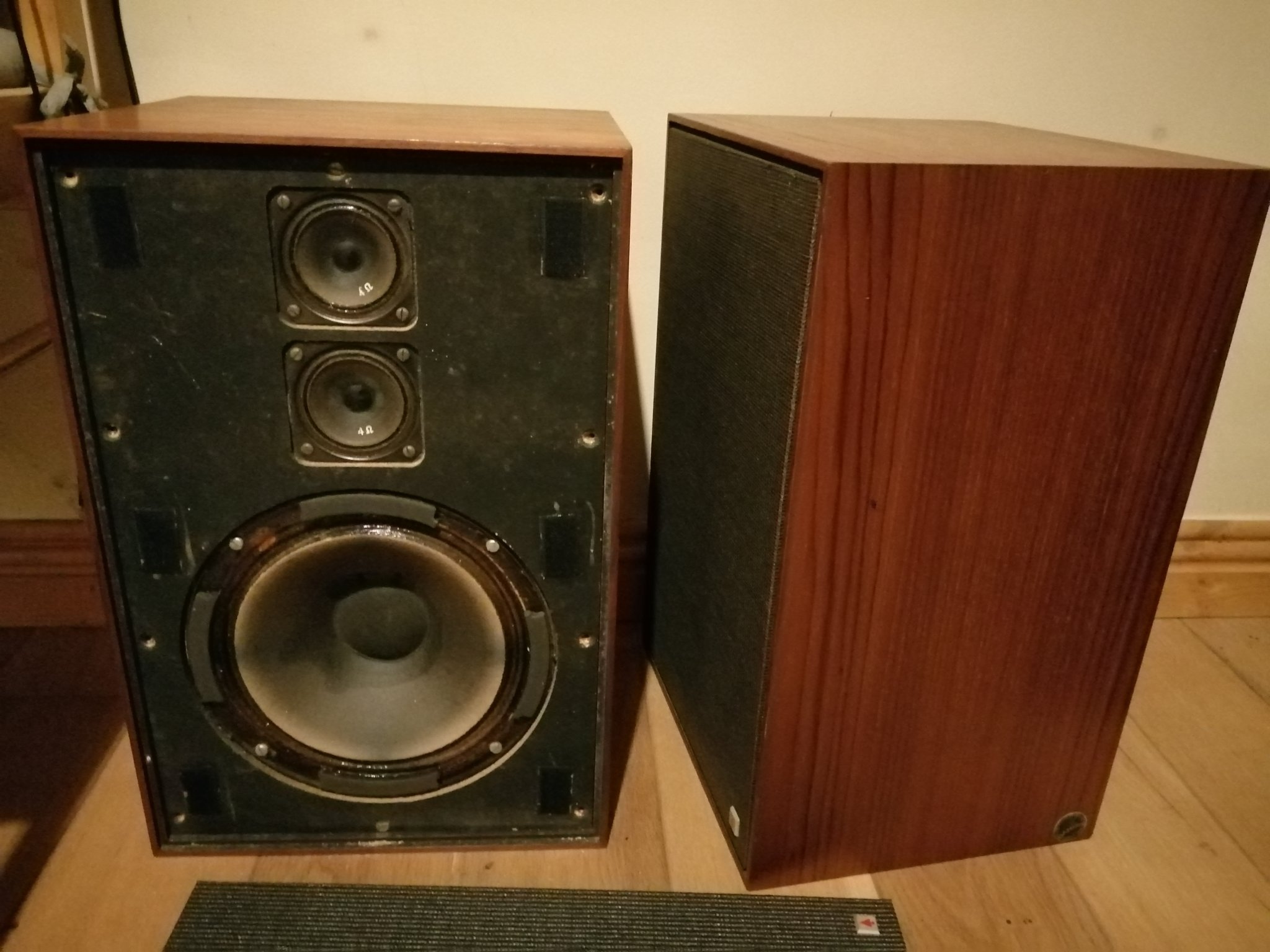

The 'donor' cabinets below are Bush L520 made by Rank in Denmark. Also alnico drivers.
The front baffles are screw on, so they can be restored back to original.
The Isophon woofer has been installed on the Mission cabs from the outside, but seems designed to be fit from the inside.
Haven't decided on that yet for the new baffles - is difference between depth of woofer and tweeter an important factor?
With the current 4.7 uF cap the 4 ohm tweeter will operate effectively above a high frequency of around 8,500 Hz.
Using 10 uF would change that to around 4,000 Hz. Extending the tweeter's operating range may be beneficial and the tweeter can handle it.
As I say, worth experimenting. Let your ears decide.
It can affect the acoustic phase relationship between woofer and tweeter and that's why it's worth experimenting with the tweeter electrical polarity when you've decided on your new baffle arrangement.
However, I wouldn't worry too much about depth difference in your application.
P.S. Will the open back tweeter be mounted in its own internal sealed enclosure to ensure its cone is not subject to the back pressure produced by the woofer?
If you are using the original XO, it isn't because of the shallow filters (6 and 12db). The XO is indeed designed for behind the baffle mount drivers but they sound more detailed mounted from the front. The downside is that the FR will probably be worse and the dispersion will be better.
Ah ok of course, it's just a simple high-pass filter, not effecting the notch filter. 8,500 Hz seems quite high and might explain how it sounds.

If you're going to change components in a bandstop filter it may pay to measure that they are still centred on the response feature they are suppressing.
Been meaning to get a measurement microphone, this might justify it!

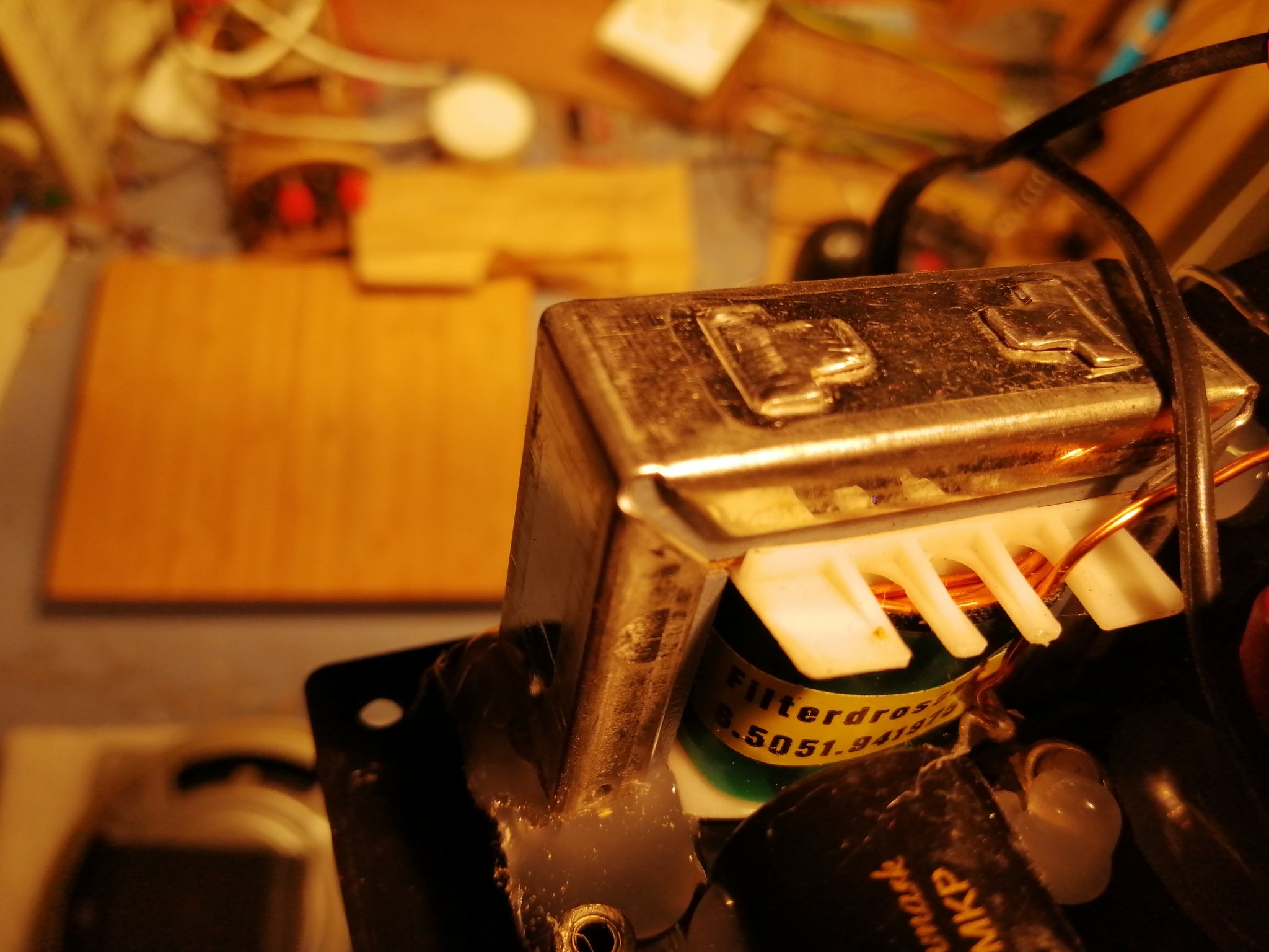

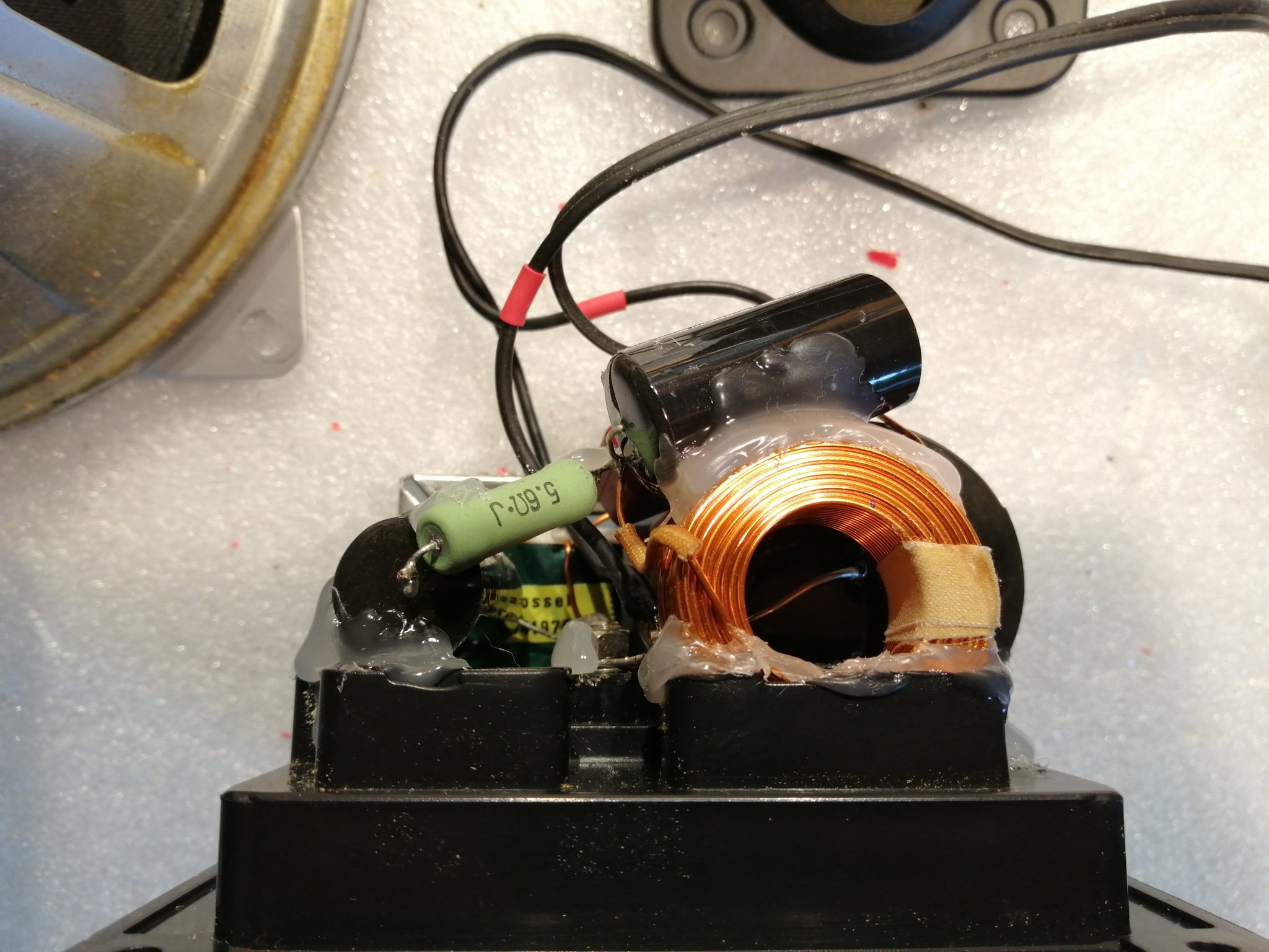

I doubt 2 parallel caps were used originally, it may well have been a slightly different value than the current 9.4uf (4.7 x 2).

They're a fascinating brand, the old catalogues are a joy. I have come across a few crossovers but with quite different drivers and mostly 3-way. I'm now fairly confident the current crossover is a copy of original.
