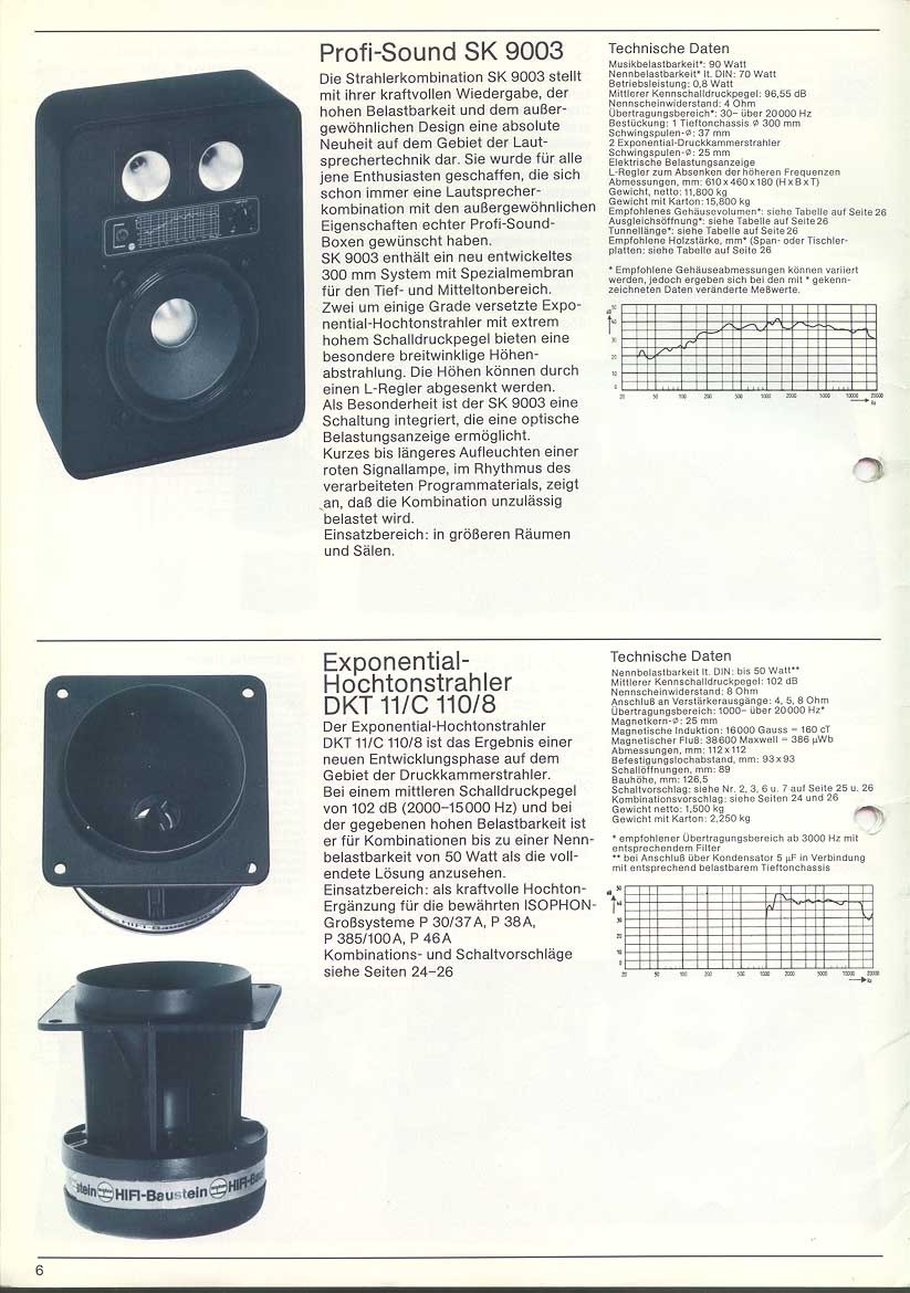

A friend is offering me a box of Isophon DKT-110 speakers. Not much info on the internet. Does anyone kow anything about these speakers?

I looked it up, Dave.
It's the old Isophon KK8 or KK10 1" plastic tweeter with a bullet horn added. A good tweeter in its day.
Takes it up to about 100dB loudness with a honk around 5kHz.
You use a regular sort of 3.5kHz filter AFAIK. But no idea if some equalisation is needed.
