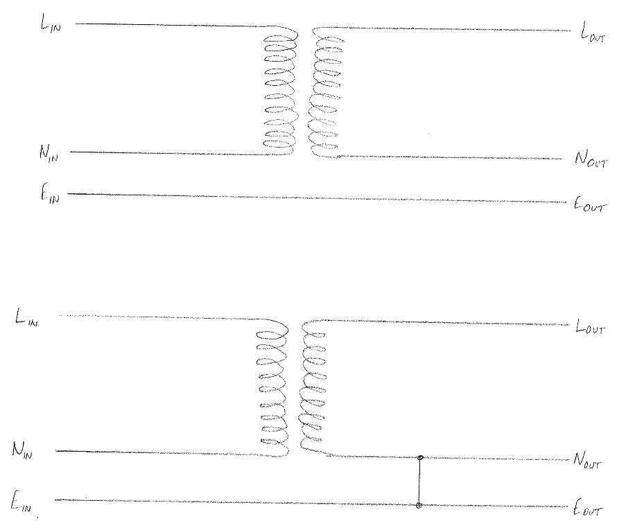

I've purchased a 230V 1000VA isolation transformer. This has a single primary and a single secondary.
See the attached pic.... Should I connect the secondary neutral to ground?

Hello sharpi, Is the chassis of the component(s) you are plugging into the iso tranny connected to the earth conductor? If so, then connecting the secondary of the iso tranny neutral would be unnecessary. If the component(s) do not have the chassis connected to earth, it would be wise to do so, for your own and others safety. One of the purposes of an isolation transformer is to create a balanced power signal to the component you are powering. This tends to help reduce hum problems. The iso tranny also helps filter out high frequency signals on the AC lines, due to the intrinsic low pass behaviour of a transformer. If you connect one of the legs of the secondary of the transformer to earth, you may actually induce noise into the AC power going into your component(s). Hope this helps.
Peace,
Dave
Typically in isolation transformers the GND connects to GND. The secondary of the transformer is left floating.
This is safe, because as the name implies, the isolation transformer isolates the power from the mains, in other words the secondary winding is at a zero voltage potential to ground.
Connecting the GND to the secondary actually defeats most of the purpose of an isolation transformer.
I installed the isolation transformer with neither secondary connected to ground.
The transformers in both my preamp and power amp have started to buzz - not dramatically, but louder than when connected directly to the mains.
The isolation transformer is a 1000VA (and remains cool during use) so I don't think the problem is a lack of current...
Any ideas?
Problem solved!
The transformer was not truly 1:1, so my kit was getting 254VAC when the mains was sitting at 242VAC. The high voltage was causing the buzzing.
I swapped primary and secondary windings to make a step down (rather than step up) transformer. Now my kit is getting 230VAC and transformer hum is lower than when the kit is connected directly to the mains.

is there any point in connecting the appliance earth (after the isolation transformer) to main earth?
If the supply is isolated what purpose does earthing the chassis serve?
it looks like a good place to break any earth loops.
Valid point. Code in certain areas requires the ground connection after an isolation transformer to be wired. I'm not sure what the intent is, perhaps to offer protection in the even of a double fault, or perhaps in case an appliance gets energized by an external source that is not isolated.

Chassis earthing is used in non-double insulated enclosures to prevent 'extraneous' conductive parts from becoming live.
Double-wound isolation transformers are used where there is an increased risk of electric shock so removing the supplied equipment from your mains supply and providing an extra degree of protection.
A very good example of a double-wound isolation transformer and what they are primarily designed for is a shaver socket outlet used in bathrooms near a sink. You have extraneous conductive parts (taps and pipework) and also water.
In this instance the double-wound isolation transformer would minimise the electric shock as you are electrically isolated from the mains supply and thus unlikey to recieve the full fault potential of the mains supply which will go into the KiloAmps range.
The maximum fault potential likely can be ascertained from the Supply Voltage and the Loop Impedance.
