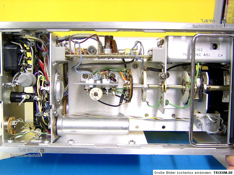

I have successfully used a method I borrowed from Hewlett Packard to isolate low level vacuum tubes from mechanical vibration. Please study the pictire below of an HP 3400A voltmeter. Here a nuvistor is mounted on a small circuit board. This board is sandwiched with soft foam rubber in a channel at each end. A small piece of aluminum (or plastic) with a through hole socket attached can be supported with foam rubber in an aluminum (or plastic) U channel. Simply size things to your needs. And use fine flexible wire to make your connections. This is assuming one is handy with tools and fabricating small parts. The only down side is that in twenty years you'll probably have to replace the foam.
