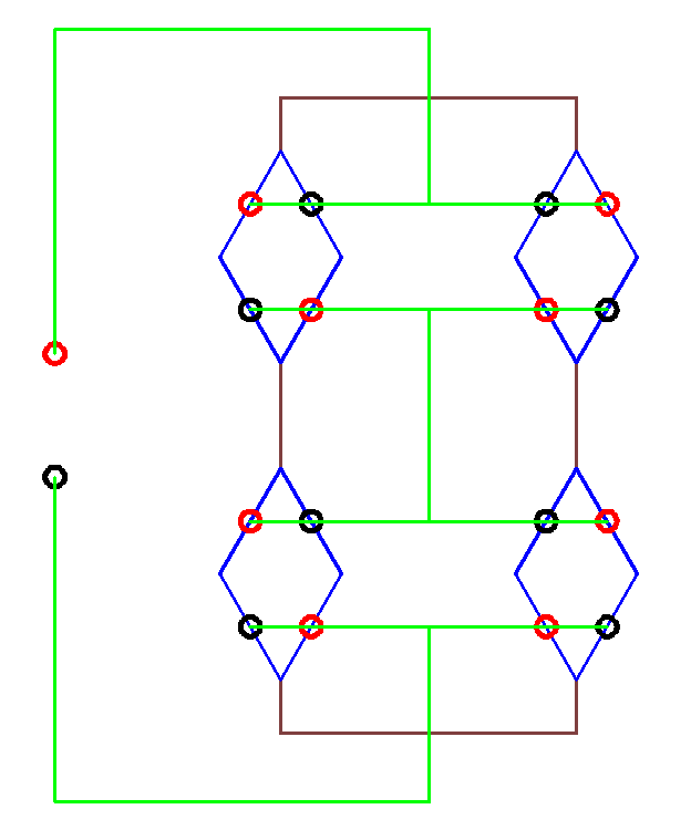

Have a ton of dayton bass drivers that need to be used. Hence option to go isobaric
Driver spec is 8 ohm, 85db.
For each cabinet, if I side mount two clamshell per side (4 groups, 8 bass drivers per cab) what sensitivity wd I get? Wd imagine parallel twice and series once to bring it to 4ohm.
Came up with that too but not sure.. Wd first parallel keep sensitivity the same as single driver? Then theres baffle step loss to consider
Indeed. 😉 Sensitivity is usually for half space.Then theres baffle step
So if each clamshell is considered to be the same sensitivity as 1 driver, 0dB (also half efficiency but let's not go there). Then the top half here will be +6dB (half space). Then with half the drive Voltage it's additionally -6dB. After this, add the bottom half.
Which makes +6dB half space. At low frequencies that's 0dB.
You'll also have a box twice the volume of a single driver, and four times (+12dB) the excursion.
