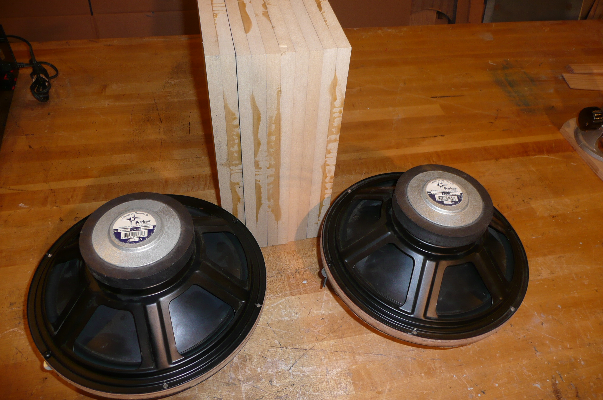

I started gluing up 2 - 15” square boards (1 ½”), will cut them, and glue up/laminate stacks as needed. This is a 2 sheet MDF and glue project ~ $60 bucks total.

I made a clamshell (1 pair) once, it was okay, but ended up building 2 sets; I might ~ that looks like a better plan than I had.

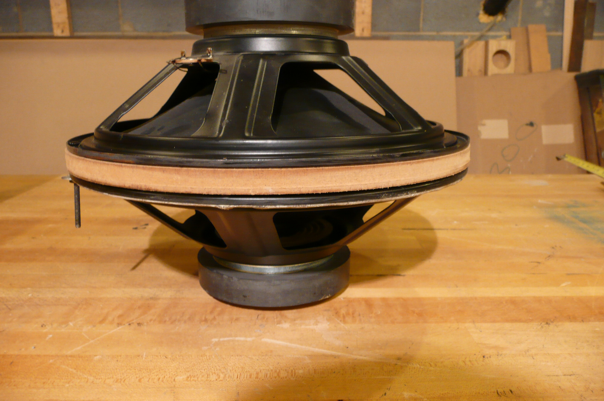

My first problem is that the drivers I want to clamshell don't really have a gasket for mounting their faces to a baffle-board; they're meant to front-load with a gasket behind the lip.

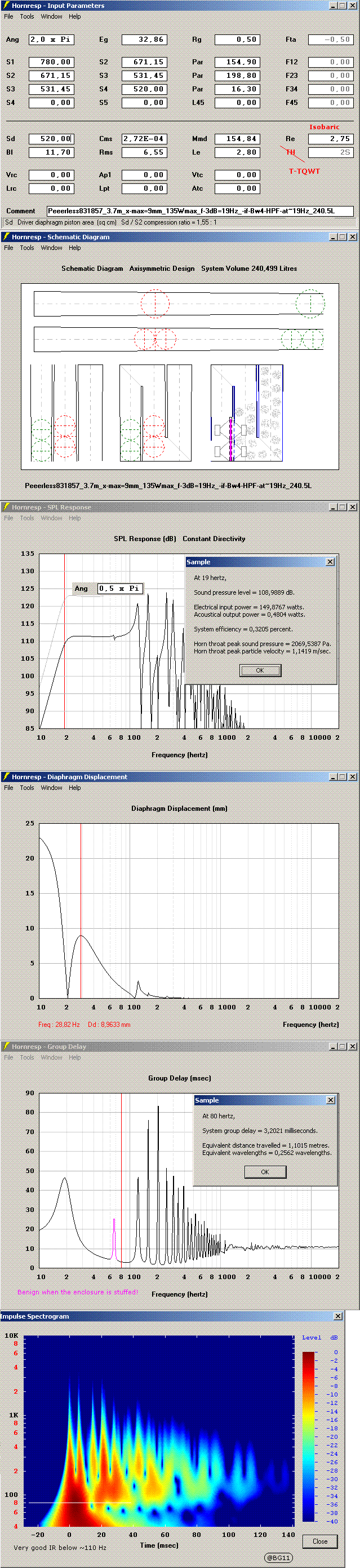

OK, then net Vb = the trisobaric driver's Fs doubling in a sealed cab is theoretically the most mechanical/acoustical compliance balanced or ~48.64 L/20 Hz based on the posted specs. Again, due to the long vent required, an inverse TQWT layout is the way to go.

Oh btw, you can make wood “washers” 1/2” x 1/2” rings to clamshell drivers together, see pic

Maybe I’ve been trying too hard, I could build a ½ size sealed box (e.g. 40L) and only use two. To keep the size down, may just go back to clamshell. That’s like a one day project. Good Idea (-; (-;

2 Clam-shelled, no port sealed does maximize the isobaric advantages. 40 liter = 1.4 cu ft. What's the system Q with that volume? A lower Q of a bigger box will give you more gradual roll-off below resonance. At really low frequencies the ported system makes nothing, 0, and the sealed makes a little. Or you can say that a billion times nothing is nothing, so the low-Q sealed box is not flat but has more than a billion times more output at 5 hz if you want to make stats lie with a seed of truth.

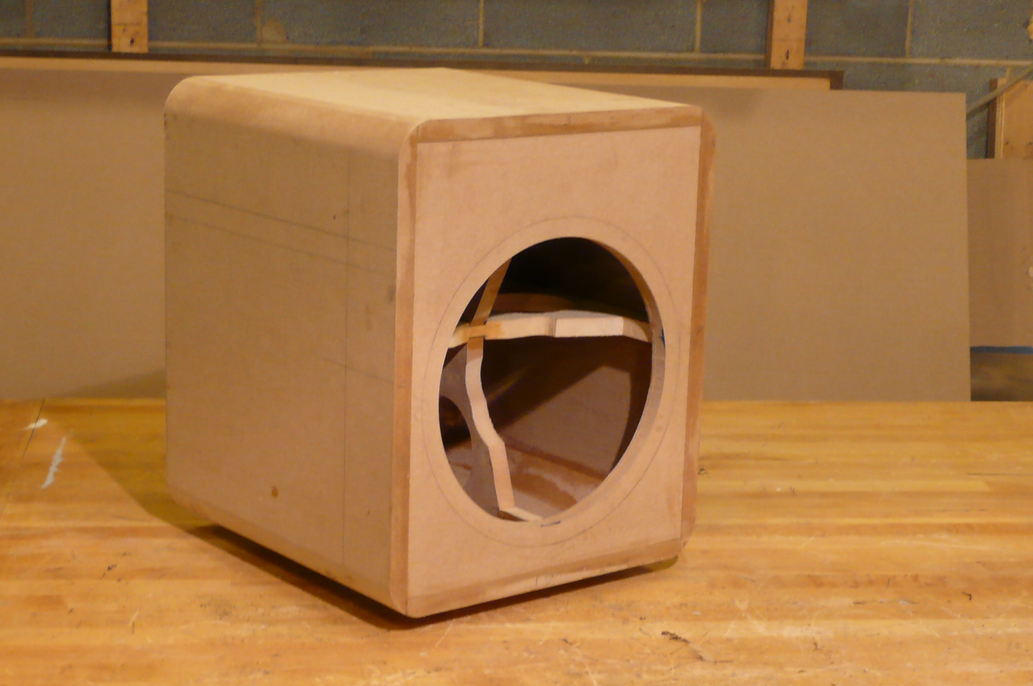

Looks nice! Ever hear of Klenk's tub and tile epoxy, and Klenk's epoxy thinner? Just and idea...
I like the braces, really good job. A bit like a matrix-braced box. But with the mutiple thinner braces of a traditional matrix bracing the braces can resonate sympathetically and couple that to the outside like a sounding board, so traditional matrix braces need to be sprayed with undercoating or bedliner and then stuffed completely.
Good job putting holes in the braces too, especially with the driver a bit off-center! You're making me wish I could just buy 10 of those boxes.
A normal person would mount a class-D plate amp right on each box. I prefer more independent components.
Boxes are really nice, my compliments. Of course, grilles would be a problem over the clamshell.
The first time I used the braces with holes method, it looks cool. I did see a drawback, they do make additional parallel surfaces (more places for reverberation). I do have a full can of rubber spray – will do.
One thought I had instead of braces: simply glue/screw large scrap wood pieces to the inside of the box, super easy, would thicken the walls, also would pass the knuckle test.
OR simply wrap it with a second layer, for a 1 ½” thick box.
