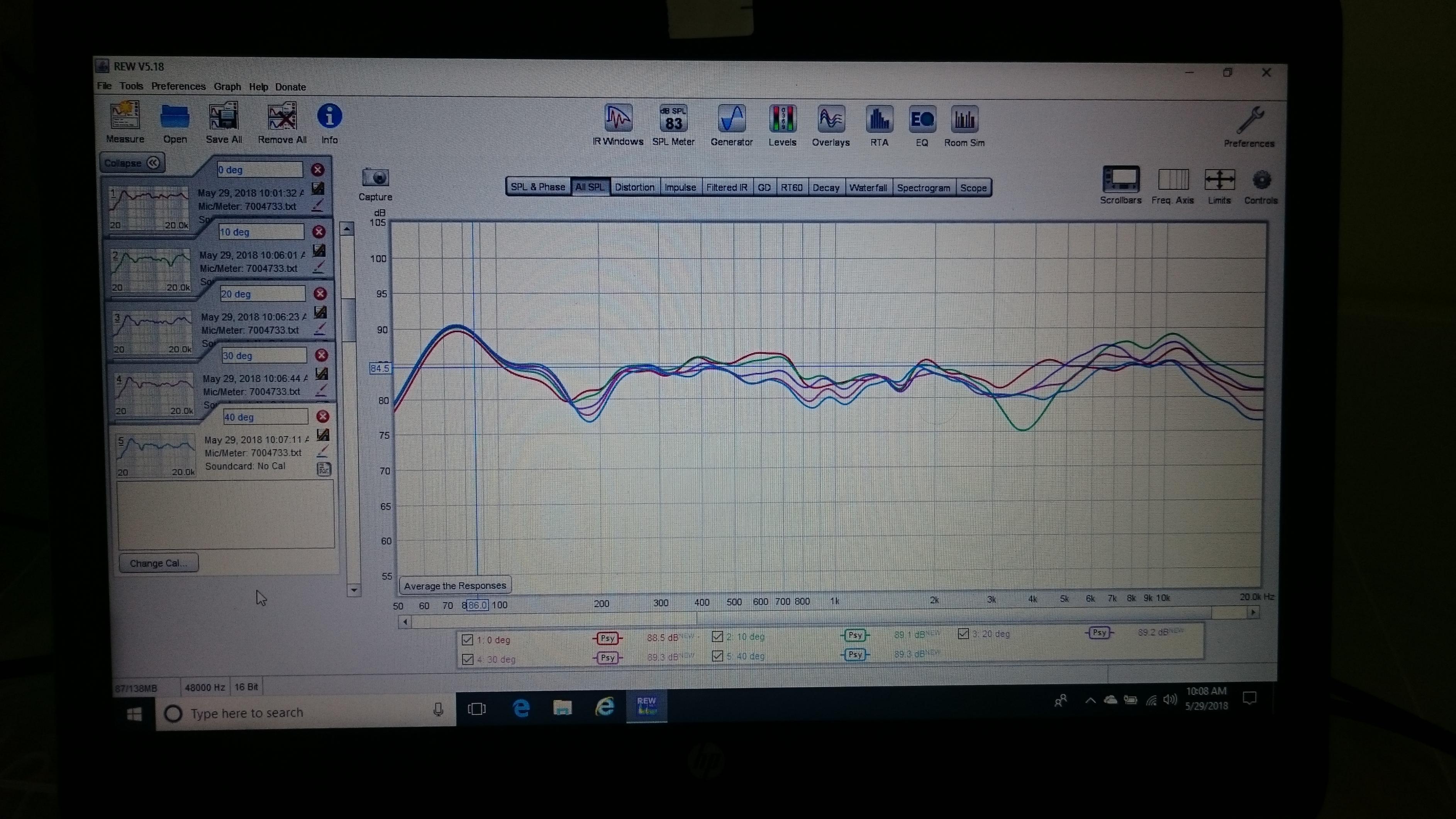

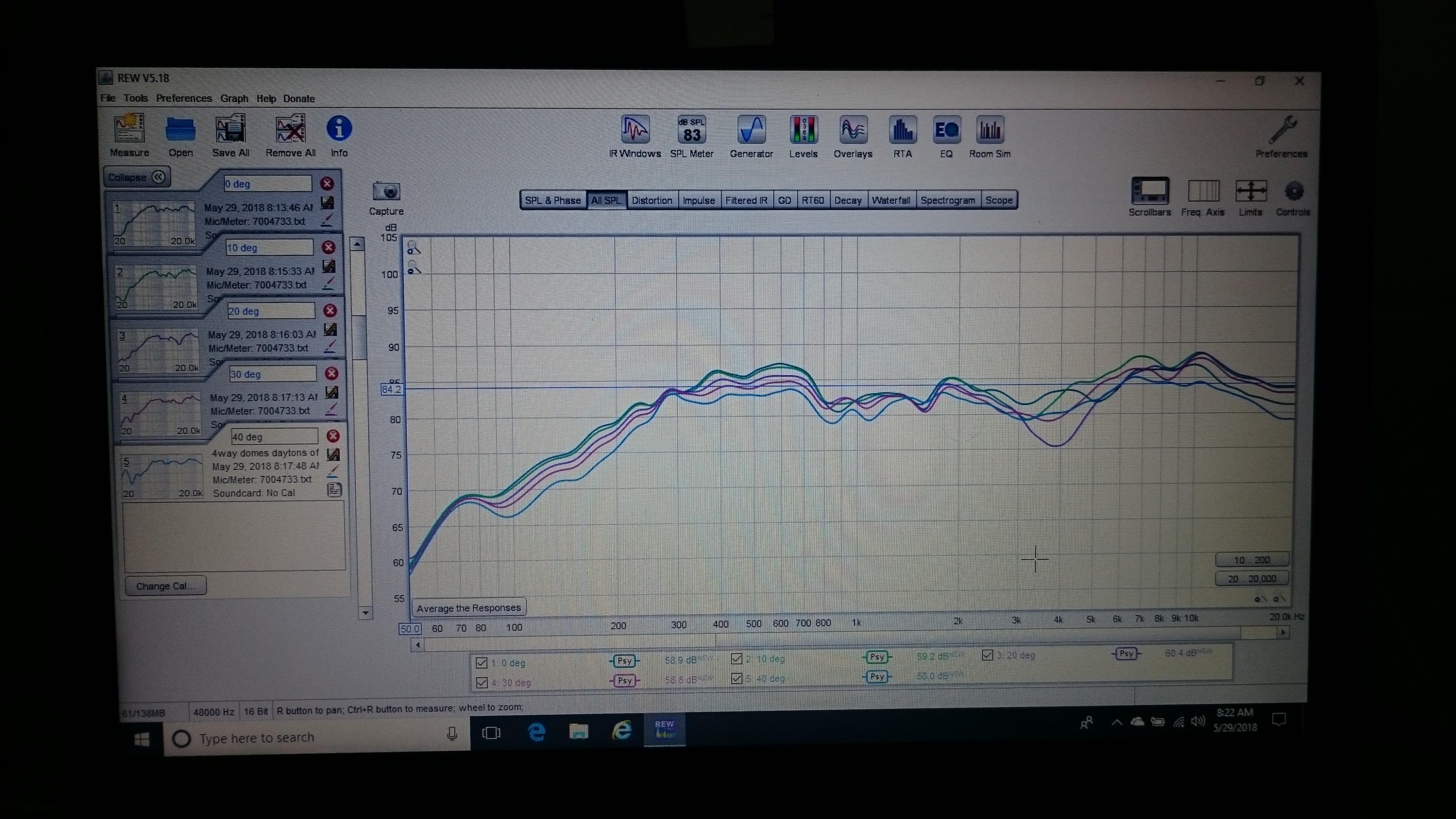

Hi dave, sorry for not replying sooner. I was hoping to find old holm files when i was optimizing crossover. They are probably gone with old dead laptop.
Anyway, crossover frequencies are 900Hz and 4000Hz. The usuall. I have read your comment about half-wave distance in many threads. Not sure if its applicable. First, my on and of axis measurements do not show any such thing. Second, many hiend commercial speakers clearly do not follow that rule. That itself does not make them right, but measurements by stereophile do not show they have of axis problem either.
So today i remeasured little 3way bookshelf. Without the sub. Right there on the shelf. Looks ok to me. Sounds great actually.
Here is complete with the sub. Looks ok to me, no of axis problem, contrary to what you expected.
Minor dip i see ~4000, perhaps due to horizontal placement of the domes. But this has nothing to do with isobaric you objected to. Yes, placement is not ideal.
