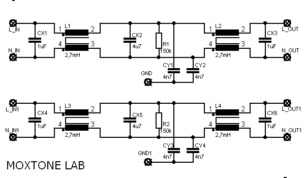

Thanks for the replies. Here is a picture :
The input dc resistance is ~1 ohm and the earth reads open circuit to either/both input (and chassis) so it isn't a centre tap. Static shield seems more likely but I'm not sure...
Croatian site looks interesting - I was thinking of using a filter (LCLC) on the output and just some small value caps on the input but I don't know if this would achieve my aims ?

Thanks for the help guys. A screen is good news and it can also serve as a star earth.
I already have filters on the individual gear and interconnects, and the power and pre-amps also have their iso trans but still the crackles and noise can come through. I've tried using a surge suppressor normally used for PC supplies but that still lets the odd one through too. I'm hoping a big iso trans will free the other trans of DC and reduce buzz (already inaudible but I can feel it through the case), and adding a filter will clean up the supply.
I'll have a closer look at the parts I've got and do a schematic so you can see what I'm planning. I think putting the filter on the input side is a better idea to avoid losses on the output.

That's what I thought - so can you explain your previous message that I can't tie the shield to earth ? Surely I must tie it to earth (because I must tie it to the chassis and of course the chassis is earthed) and best practice is to create a star earth - one centralised point for all earth connections - so why not use the shield connection point on the trans as the star earth ?
Your star earth implied, by my interpretation, an audio reference point required by all amplifiers to work properly as a pieces of Audio Equipment.
The Safety Earth and the PE and the chassis connection to the third wire are all solely to do with Safety. They have nothing to do with Audio signal processing.
This confusion all comes from the common use of the word "ground" for many quite different parts of the circuit. I interpreted your reference to earth as a beginners' error in mis-naming ground.
