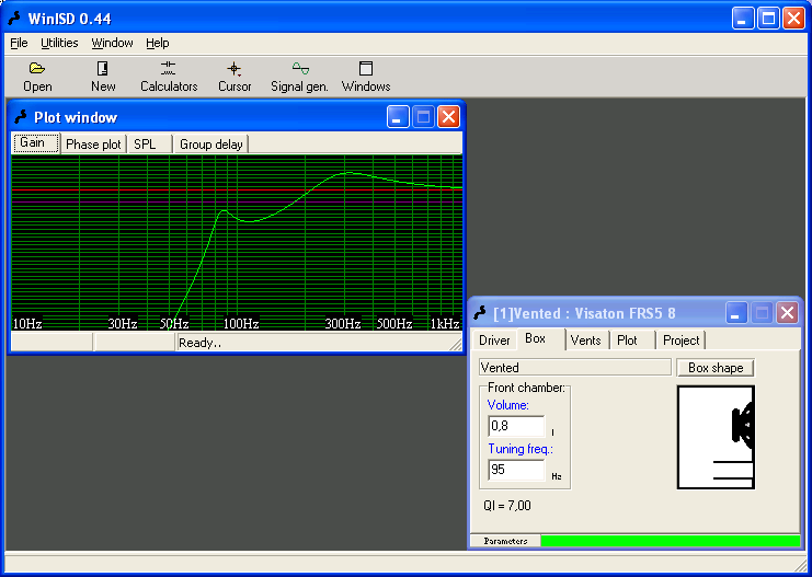

I'm building a pair of very small, portable speakers.
The driver units are Visaton FRS 5 8ohm.
http://www.visaton.com/english/artikel/art_257_1_3.html
Frequency and impedance response:
http://www.visaton.com/english/bildgross/257_afrequenzgang.html
Doesn't look bad at all...
But simulated on WinISD, I can't get much better than this.
There's always a big peak at around 300hz, no matter what volume or tuning freq. I choose.
WinISD chooses an 8.5L enclosure (?!), too big, but the peak is there.
Is WinISD fooled by the high(ish) FS of this driver - 250hz?
Or is Visaton telling us the Snow White story?😕

the driver has got a very high Qts and that makes it impossible to get a even near flat response in a BR.
What a lot of people do with the FRS8 for example (also high Qts) is to take a sealed box (~1l) and use a series cap too flatten out the peak.

Hello Carlos
I do not think you can get a flat response with a Qts 1,28 in a bas reflex enclosure. a leak closed box or open baffle may work.
Remco

joensd said:What a lot of people do with the FRS8 for example (also high Qts) is to take a sealed box (~1l) and use a series cap too flatten out the peak.
Yes, the series cap is an option, but I would loose even more bass...😀
grrr said:I do not think you can get a flat response with a Qts 1,28 in a bas reflex enclosure. a leak closed box or open baffle may work.
I didn't think about the open baffle option, because I wanted a small speaker.
May give it a try.
What dimentions would you use for such a small driver?
Btw, after running-in for some days, these drivers sound quite good in the midband, and not bad at all in the treble, very extended.
Simulation for a 1,2L (default WinISD calc) sealed box.
The peak follows me around.
Bill Fitzpatrick said:Wrong speakers for your intended application.
I'm starting to figure that out...
At 8€ a piece, well...
Gonna try some open baffles, it's easy and I have the MDF...
It's a slow day, you know...😀

That´s what one would think in the first moment.Yes, the series cap is an option, but I would loose even more bass...
BUT a high pass at the right XO-frequency will effectively boost the bass.
Quite "trendy" at the moment in german DIY-magazines:
Sealed subwoofers with series cap(s).
greets
All I can come up with at the moment.
Plugged in some numbers in boxsim which is a nice,free and small loudspeaker sim written by a Visaton-forum-member and so includes measured responses from Visaton.
Volume is 1,2L, sealed with 120uF high-pass cap although I´d just throw some different electrolyts at the speaker and listen.

That's much better, thanks.
But it rolls-off at 200hz... my point in using the small bass-reflex enclosure was to extend the output a little lower to 80~90hz...
Aham...
I've cut two pieces of 10mm MDF, at 14.5*18cm.
Two round holes, stick the drivers in...
I'm surprized.😱
No strange effects, very natural sounding, there's even some "bass".
Midband and treble are very good.
Treble is very extended, unlike most fullranges. This is an advantage of such a small driver.
Gets me thinkin' if this driver wouldn't go really well in a two-way speaker, crossed low (like 500hz).
A mix of open-baffle and sealed woofer.
PS: oh, and they image like hell.
