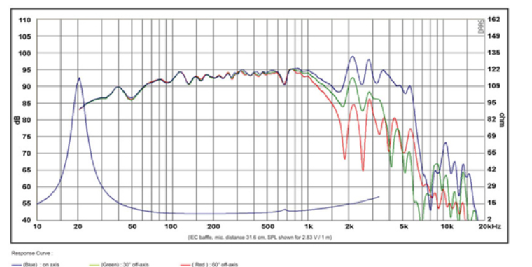

am i reading this right?! the impedance scale looks way up there, peaking at 120 ohms? If so I would assume some type of compensation is needed? Guidance is appreciated.
Oh thats right I did use DATS to measure the impedance. I will look back at my records. But that is high right?? would you think there would need to be some compensation??
The higher the peak, the lower the mechanical losses - that's good!
You probably drive the speaker with a voltage source/amp, so the impedance will have no effect on the FR.
That's all quite usual. What do you expect to happen?
