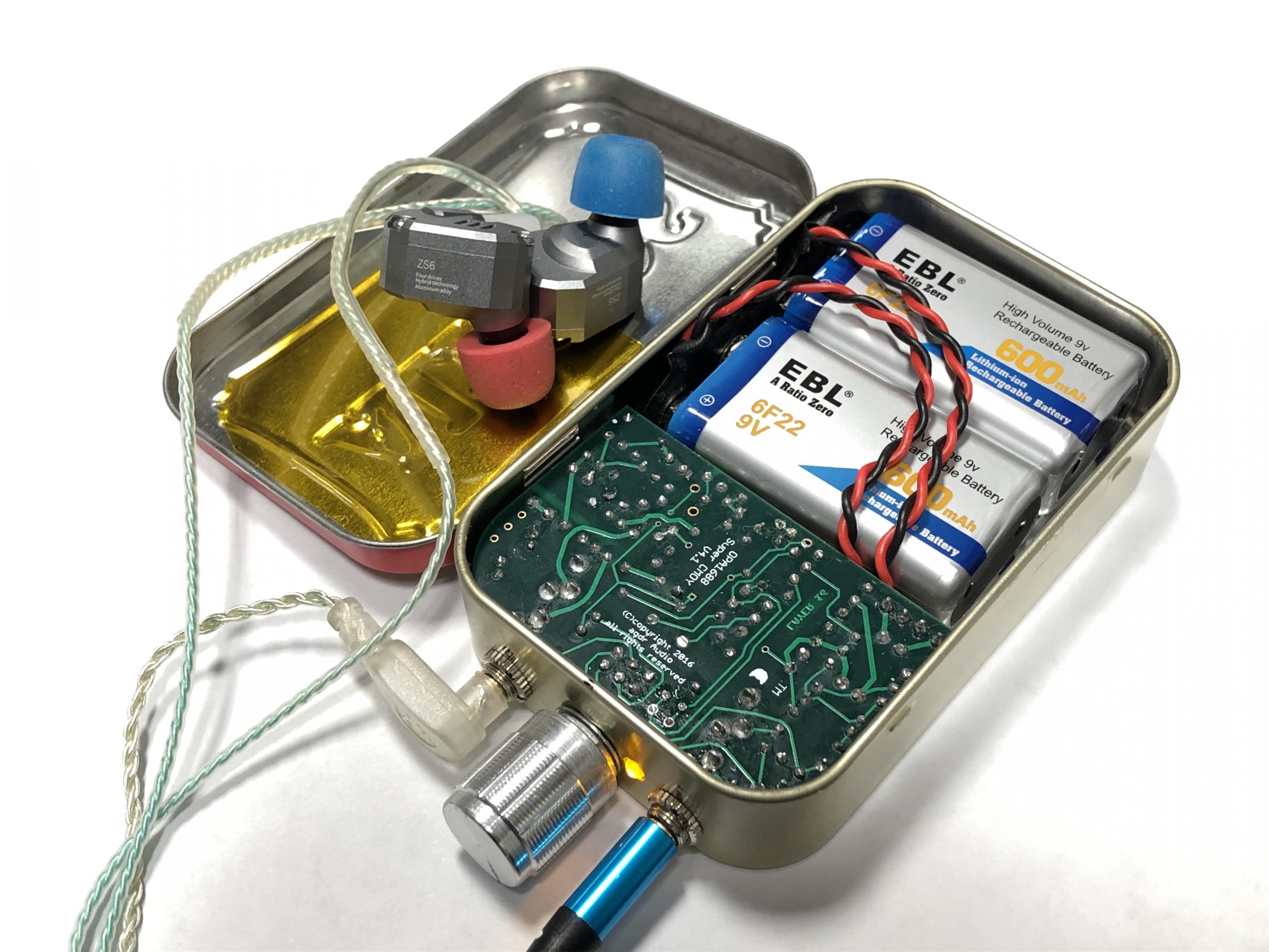

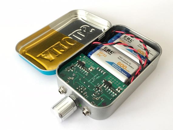

You may see a family resemblance between my Class A pocket amp and Agdr’s Super 1688 CMOY - the board footprint, 3.5mm jacks and volume pot are the same and Agdr was kind enough to provide me the Eagle file.
When I have trips where I need the battery to last 12hrs, the 1688 Super CMOY works nicely. Here it is driving my ZS6 quad driver (2 dynamic and 2 BA’s) earphones.
Here is my Pocket Class A:
And attachment below is Agdr’s that I built.
