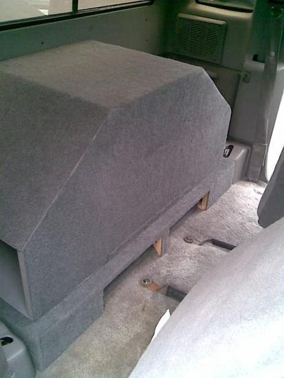

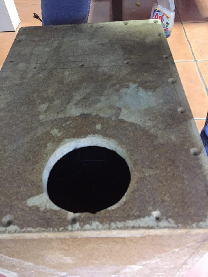

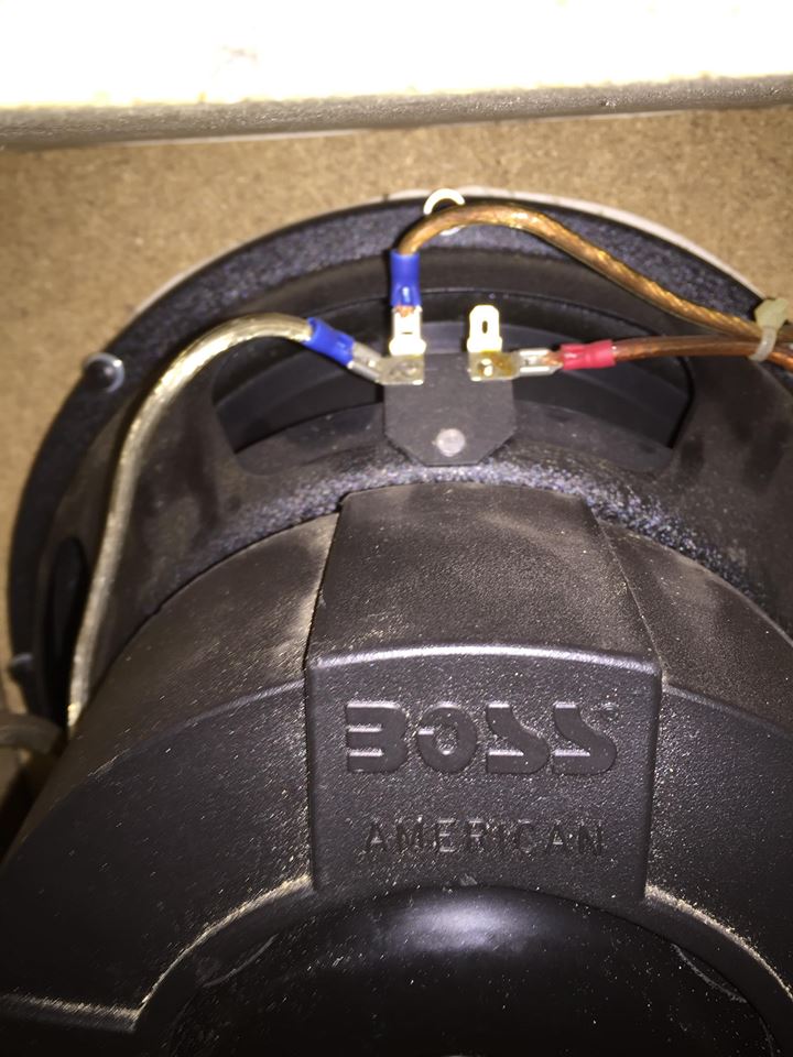

Hello guys, i've got this old sub.Its strange that front part of subwoofer is closed and the back one have hole.I've put some images so u can see how that actually look like.I am confused, i googled for a while, i've never found something like this.Is this wrong?

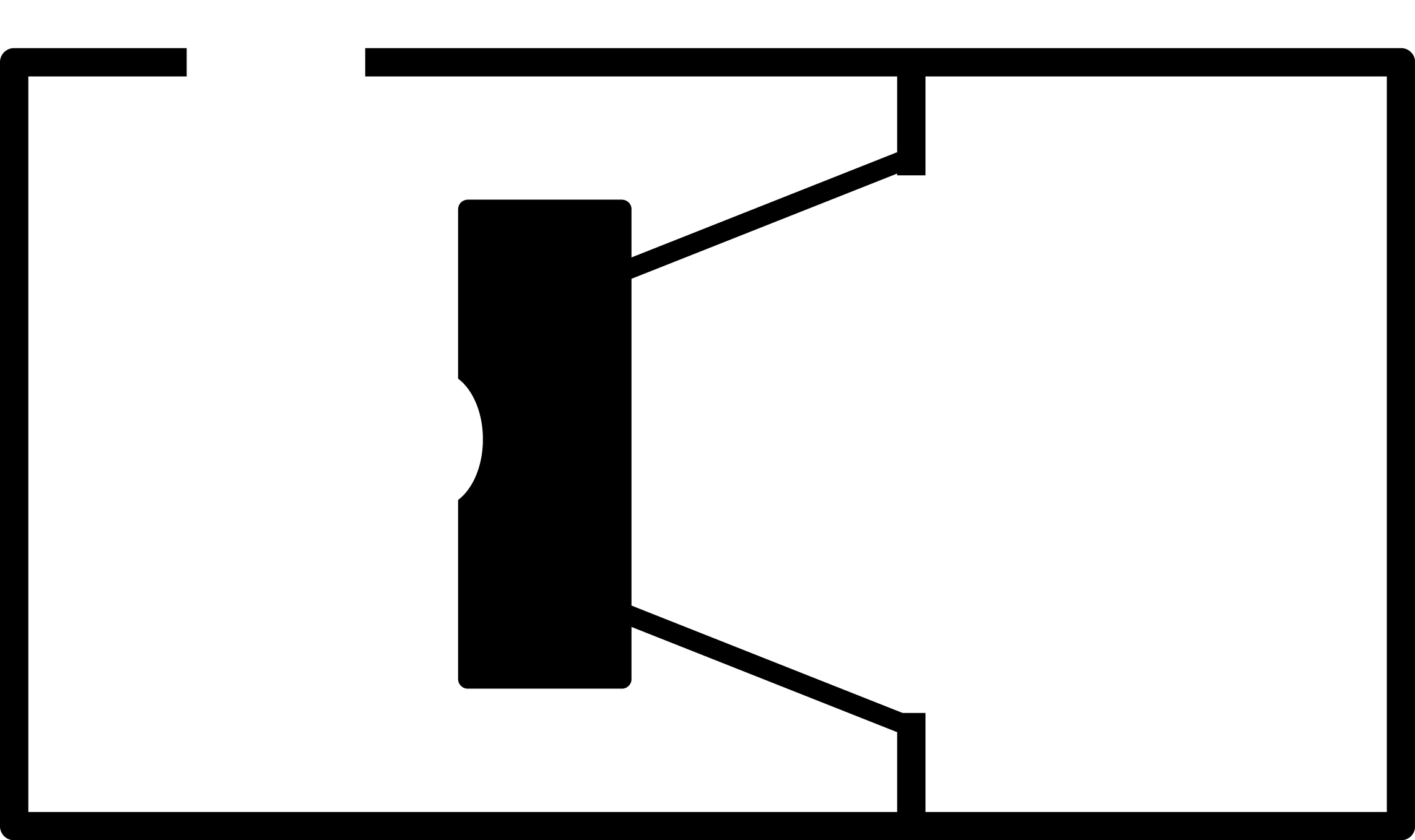

Yes, this is completely possible to do. It´s one kind of the bandpass box. Yet it will most likely be wrongly tuned and inefficient. I would rebuild it...

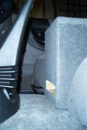

probably who made it prefer to use rear vented in order to improve heat trasnfer and reduce power compression in some way.
You could do reverse engineering to simulate what you have in hands

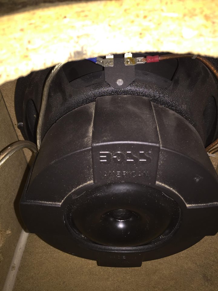

Could you provide some more data? Box chamber volumes, port dimensions, Thiele-Small parameters of the woofer.
probably who made it prefer to use rear vented in order to improve heat transfer and reduce power compression in some way.

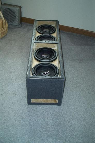

Exactly! I always build my BP4's this way. How do you expect a vented voice coil to get cool air in a closed box???

I wasn't on my phone when I posted those pictures. My work laptop does not have those pictures to upload, hence using the link function to Google Photos. I'm on my phone now. Here are those same pictures.
