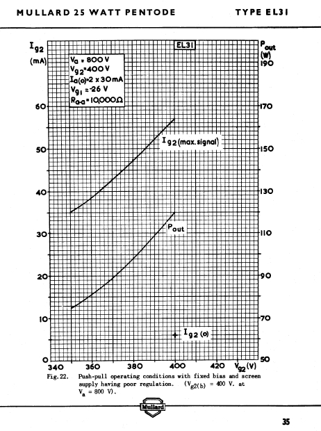

The steel collar type EL34 was the early type, and used to POP the glass just above the collar, with a clean break, leaving what appeared like a small whisky glass over.
They moved to the bakelite base very quickly to get rid of this problem, while never resolving the melting G2, and quickly discouraging people from ever implementing the 800V anode voltage actually listed, designed to get a short but sweet 100W before the inevitable blow up came.
Try running a pair at 100W (easy + reliable on any GEC valve, even ancient KT8C or 807), and you will see instantly what I mean.
The screen starts to glow red quite fast, then white, then come the collapse with a firework display followed by disaster.

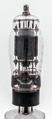

I have to assume this is why nobody ever tried to push its predecessor the EL31 claimed to make 120W at 800V....showing a real scary 22W screen dissipation figure at full power....
To boldly go where everyone knows will be disaster...eh?
The EL37/CV586 was basically the (EL31 no TC) EL34 with the big glass, (like the KT66) and are almost exactly identical inc the same 11mA/V but no top cap, so derated in use, and the old "pinch" type seal.
Cheap is not always cheerful, but hey that's what mass production is all about, isn't it, and does wonders for sales? 🙄
