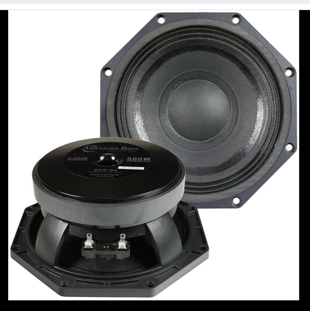

B&C spring terminals
(Generic photo on sales site!).
