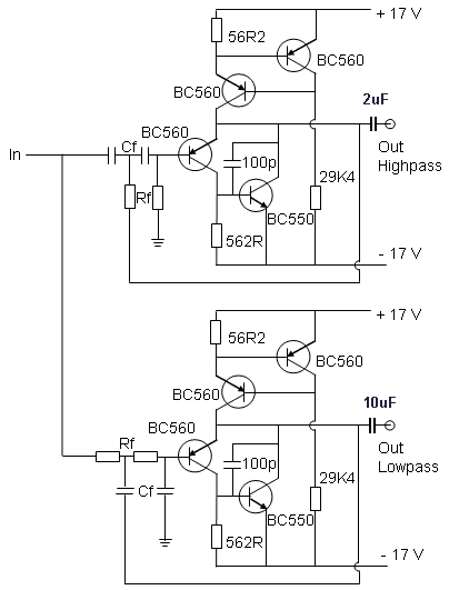

I have seen lots of threads about active crossovers here. They all use opamps, I want to try descrete components if possible. I found the attached diagram in an old HIFI magazine and I want to have opinions on this.
it is a 12dB/octave, why go for more if the speakers can handle it.
The Cf and Rf components have to be calculated according to the formula Fc=1/2*pi*square root 2*R*C.
Any comments??

Line level crossover filters are invariably based on the Sallen & Key topology that you've shown. You only get nice simple equations if the amplifier within the loop has lots of gain. the circuit you've shown should have quite a bit of gain, so it's rather like an op-amp in that respect - it just doesn't have the DC stability conferred by a differential pair input stage.
A very popular configuration is the 24dB/oct Linkwitz-Riley crossover, which is made of a cascade of two 12dB/oct Butterworth filters. The reason it's so popular is that it's insensitive to the fact that the two drivers are not coincident.
Finally, all Sallen & Key filters have increased distortion within the pass band compared to that same amplifier configured for the same gain but without filtering. In other words, you want a nice low-distortion amplifier before you wrap Sallen & Key around it.

EC8010 said:Line level crossover filters are invariably based on the Sallen & Key topology that you've shown. You only get nice simple equations if the amplifier within the loop has lots of gain. the circuit you've shown should have quite a bit of gain, so it's rather like an op-amp in that respect - it just doesn't have the DC stability conferred by a differential pair input stage.
The DC offset is blocked by the caps at the output of both high pass and low pass sections

Sallen & Key wrote the original paper on how to make filters with CR networks and amplifiers, rather than LC networks. The circuit you showed is a Sallen & Key filter. Unfortunately, it increases the distortion produced by the amplifier compared to that amplifier without Sallen & Key around it.

My personal experience is that lower order crossovers, no matter whether active or passive, analog or digital, sound better. Which is a reason to select drivers that don't need steep slopes.
Anyway, probably a matter of taste...
klitgt, did you have a look at Nelson Pass' active crossover or the (similar) MOX? They do use opamps, but discrete ones...
The discrete opamps in the attachment are so primitive, that thay simply won't work correctly I think. Especially this 'open collector' operation makes little sense.Any comments??

Why is everbody talking about opamp, while this guy designed a, what looks like a good, discrete buffer?
the circuit attached in the first post should just work fine, or am I missing simething?

What I want to use the filter for is a bi-amp system for "bookshelf" size speakers assisted by subwoofers with a cross-over frquency of 100 Hz. The small speakers are able to go down to 60Hz, therefore I do not believe it is necessary with steper slopes than 12dB/octave.
