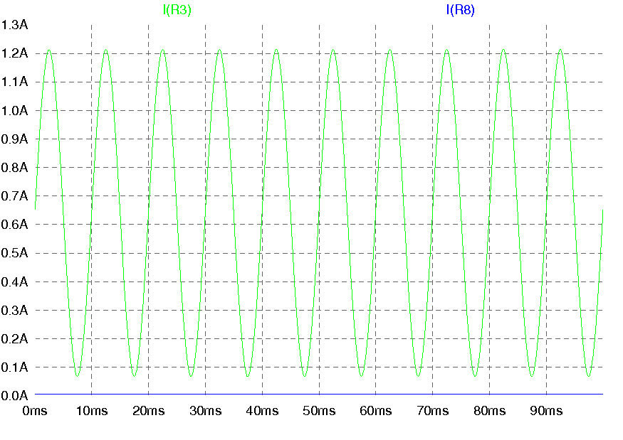

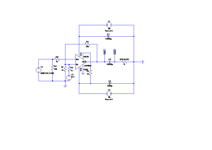

I left the neg. rail for the mute circuit. In a single supply config pin 7 can't be connected to 0V. it is set between pos. rail and neg. rail with a voltage divider of some kind. Because I move the ground towards 0V the mute doesn't work. Use a low current transformer with the same voltage as the positive Rail.
As extra bonus the output signal will not clip if it does crossover.
The output must run in class B and you need to prevent it from going into Class A at low currents, if that makes any sense. Ci can prevent the DC current returning though the feedback resistors.
why do you believe in the Spice LM3886 macromodel - do you know what's inside?
try again with a discrete transistor power amp sim - one of Bob's examples for instance - look at the output Q individually for Class B operation at amps
I used LTspice with the LM3886 model by teemuk 21032007 ver.1b.
It has a working mute circuit which is important for this simulation.

confirming a bad Spice model

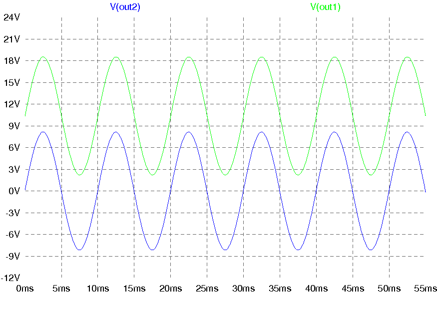

I think you could try this with any Class AB opamp or solid state amp with feedback. By adding neg. offset to the neg. differential input the output goes positive to remove the offset though the feedback loop. Both the positive and negative input show only the input signal as it should be.
I am also still sceptical of this working for real. But theoretically it can.
not as you draw it - there has to be DC current flow from the output to bias a CLASS AB chip amp into SE Class A - your circuit doesn't have such a DC path, or current - the Spice model is just wrong

The feedback loop has not sufficient DC current to prevent Class A operation. Depending on the offset voltage and feedback current a 80R to 100R resistor was needed in the simulations to achieve this.
Have you a better model. It doesn't have to be for a LM3886. Anything without a mute circuit would make things easier.
just use most any Class AB discrete amp modeled in Spice - there are many - I've posted a few in Bob Cordell's Feedback and Book threads, many others exist
the audioamp.asc included in LTSpice' educational examples files is especially poor, but would show the output Q currents, respond to a external current source
