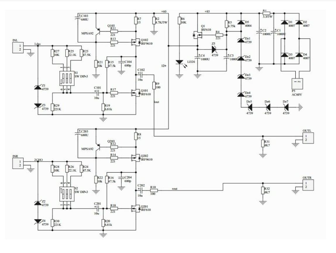

Hi All
I stumbled across the attached schematic - is it a Pass preamp -if so which one?
Thanks in advance

Dennis - You appear to correct ..
have looked up the Aleph L linestage - and that's pretty much it

I don't think Nelson ever used an enormous slugg-em-in-the-nuts capacitor like C103 (680 uF!) in any of his constant current source designs.
The low frequency rolloff introduced by C102+R31, is at an uncharacteristically high frequency. Usually NP picks BIG output capacitors giving a rolloff below 0.5 Hz. 10uF at the output? Not his style.
Finally the PNP is a cheesy Motorola jellybean part? That's not Nelson's style; he normally uses Toshiba or Zetex BJTs. I'd expect to see something like 2SA970BL or ZTX795A.
