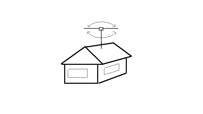

Produce a dipole... two aluminium tubes insulated into the middle
each aluminium tube will be 1 pole...so, two wires will go to your receiver...use 75 ohms coaxial cable...with inner conductor and shield... the aluminium length can be half wave length each one, or even 1/4 wavelength each one.
To obtain the correct dimension divide 300 (ligth speed) by your prefered frequency in Megahertz.... for instance 100 megahertz as your prefered FM station.
To this frequency your wavelength is 300/100 = 3 meters.
So... you can build a dipole (two poles insulated into the middle) with 1.5 meters each half side tube (full wave dipole aerial)...or you can use 75 centimeters to each tube (half wave)..... distance between then must be around 5 milimeters to avoid capacitances between electrodes.
You can try your dipole into Vertical position or Horizontal position, a good idea is to be in your roof, above your ceiling, into your home top...or attached into a post or a tree.. the coaxial cable will bring signal for your receiver.... try vertical and horizontal and search for best signal.... if vertical nothing to do...but if you decide by horizontal you have to turn you antenna trying to increase the signal strength measured into your receiver S Meter (units of reception strength.... units "S" ).
The better reception (and transmition too) happens into the perpendicular.... 90 degrées created from the aerial line....so.... the vertical one has all 360 degrees of reception, because the 90 degrees point is all the way around... this does not happens with the horizontal that has maximum and null point (the direction when you think your aerial as a gun barrel.... this is minimum reception).
