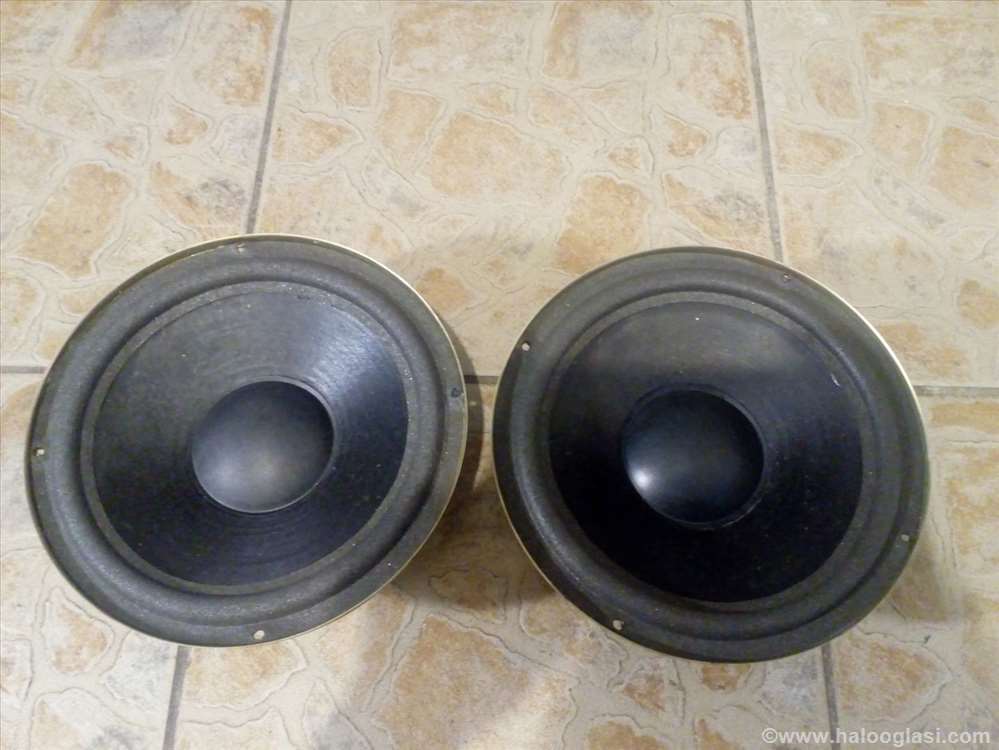

Hi All.
With lack of thought, I disassembled a number of Speaker drivers without noting their orientation to the Loudspeaker cabinets.
Is there a correct side up, or a convention when fitting Woofers?
The Jamo drivers in two of the photos will shortly be refoamed.
I recall a particular tutorial on refoaming speakers.
After removing the dust caps the importance of using shims to centre the voice coil was stressed.
With vintage speakers, he also taught that wherever possible the original dust caps are kept.
These were marked with pencil to also ensure original orientation when later re glued.
He also taught the use of 2 shims at the 6 o'clock position to counter the effect of gravity on the cone assembly.
For this, and possibly other considerations, I thought I'd check with you guys before getting on with the refoam.
thanks

Thanks Mark.
So, with your advice, I'll aim to orient the drivers with the electrical terminals upwards closer to the crossover location.
I'll mark them with a 12 o'clock position for future orientation and double shim at the 6 o'clock position (taught by a speaker guy with 40 years specialising in speaker repairs.

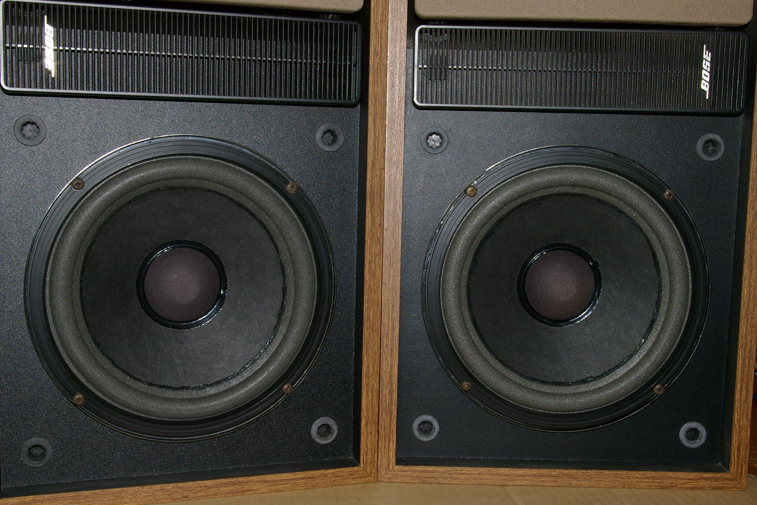

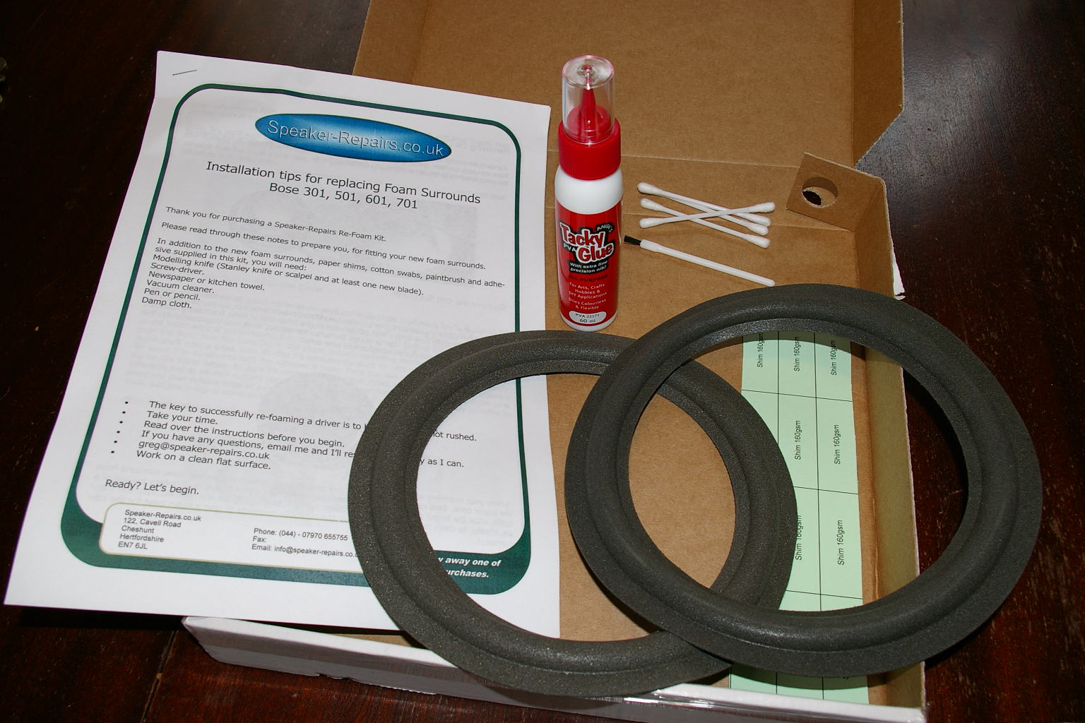

I have sucessfully refoamed a pair of Bose 301 drivers without having to resort to using shims, and hence not having to remove the dust caps.After removing the dust caps the importance of using shims to centre the voice coil was stressed.
The rear suspensions (spiders) of the Bose drivers were particularly supportive of the cone and provided a self-centering action. I realise that this may not be the case with other drivers.

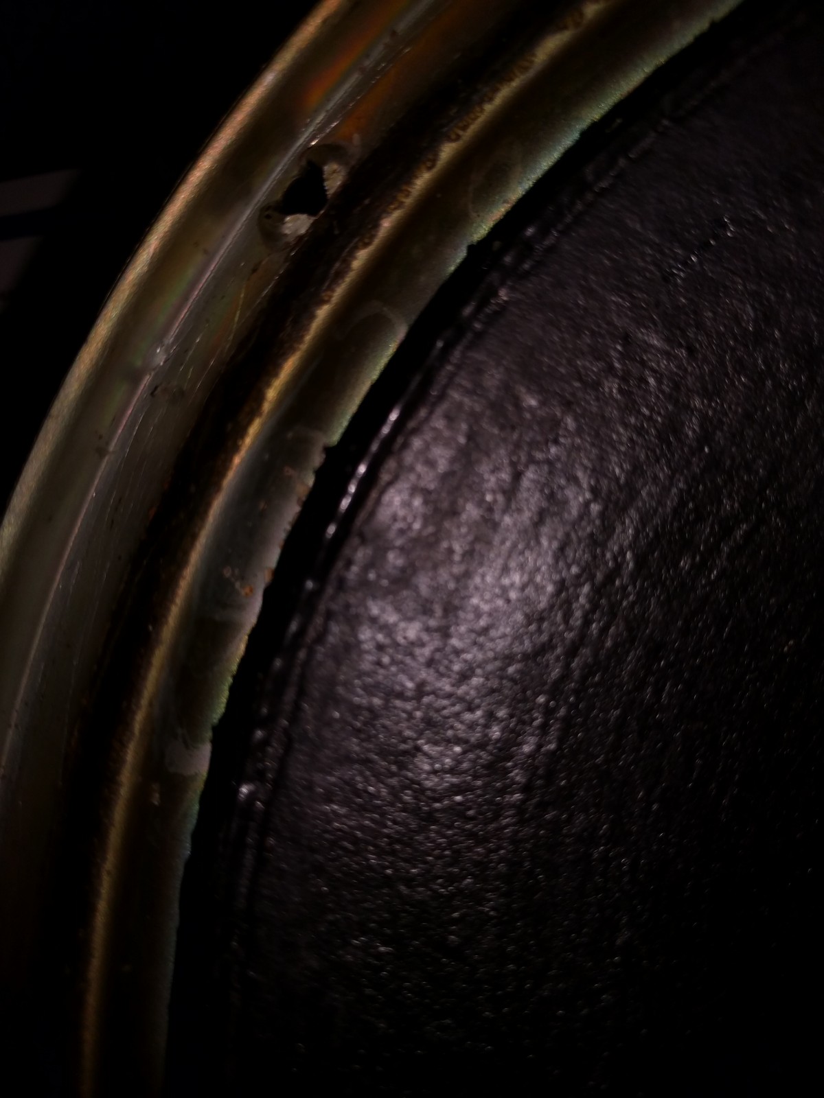

Had a go at gluing the new foam on the Jamo's.
The glue wasn't adhering to the edge of the cone.
Tried twice, but it appears an earlier owner has coated the paper cone.
The cone appears extra glossy along the edge, which had been covered by the deteriorated foam.
Too glossy for the glue to adhere.
I suspect I'll need to try sandpapering the edge.
Maybe start with a 180 grit and hope I don't make a mess????

Even if previous owner recoated cone, there should be none of the evil stuff where you removed the rotten foam edge 😕The glue wasn't adhering to the edge of the cone.
Kow did you remove it?
Sanding the remains? Carefully scratching them with a very sharp knife?
Soaking it in acetone and wiping the gooey paste away?
I suggest doing the soaking and wiping a couple times, least harmful tocone fibers and will remove both old adhesive, "coating", rotten foam and your last applied adhesive.
Just do it carefully, wet paper is weak.
As of adhesive, it must be thickish proffessional carpentry grade PVA; some home/school use type is more watered down than cheap tavern beer.
It may be too aggressive and remove too much paper.I suspect I'll need to try sandpapering the edge.

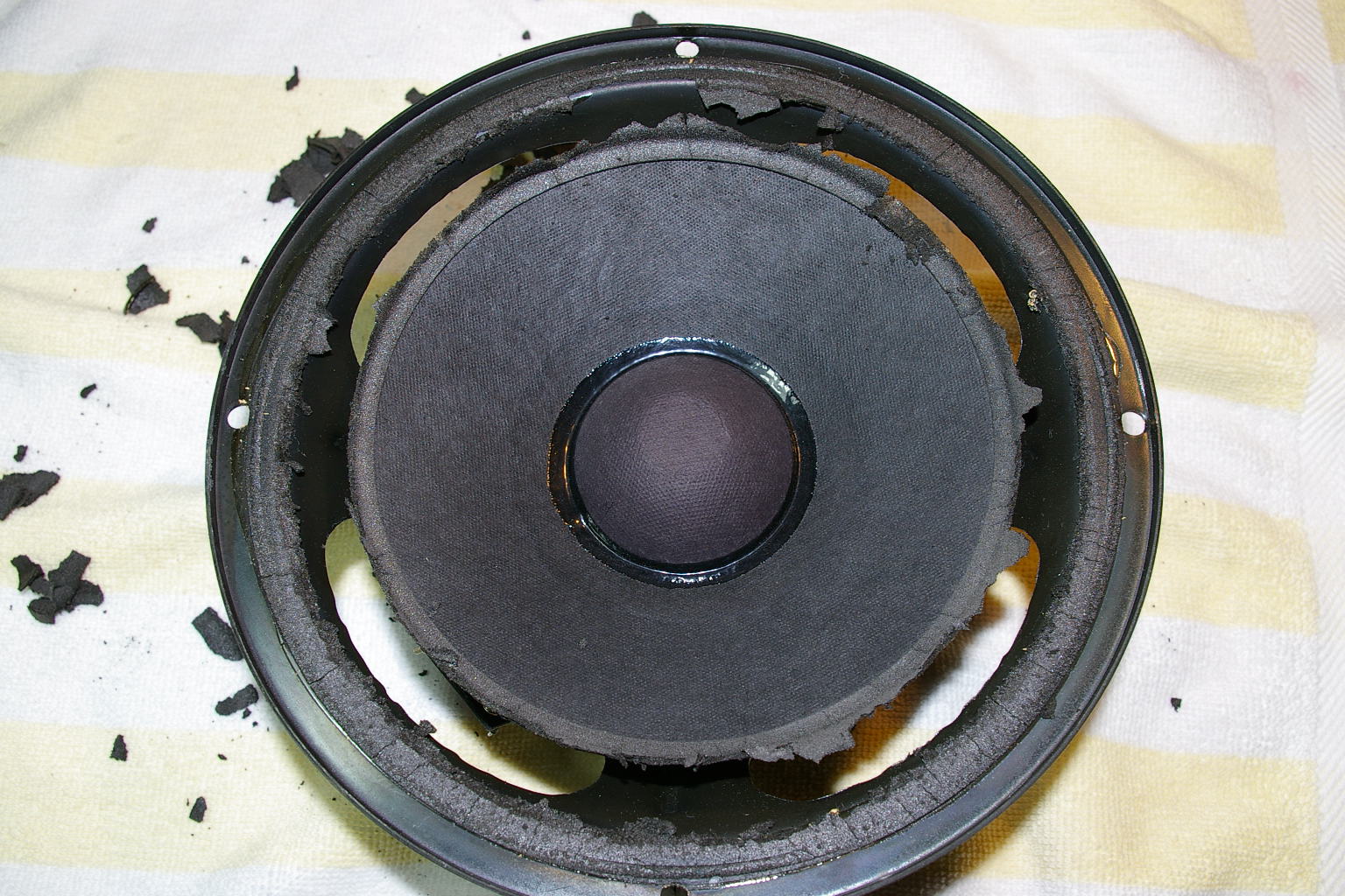

The original foam was considerably perished and powdered very easily.
I used a stanley blade and mostly used the blunt edge to scrape any bits off the cone.
The cone appeared extra glossy where it had been covered by the old foam.
Very smooth & glossy, almost like a black painted finish.
Maybe 300 grit gently just to scuff the surface and remove the impervious gloss.
Can't you name them, Cliff?I have 2 different glue preparations.
1. Crafterschoice Tacky Craft Glue (super tacky)
2. No Name preparation sold specifically as a loudspeaker foam glue.
Not knowing what the composition of the cone is, I suggest you carefully use a fine grit simply to roughen the circumference of the cone then coat it with a thin layer of your tacky glue. Allow that layer to dry then repeat as necessary.
My hope is that will provide a stable, compatible base onto which to glue the foam surround.
