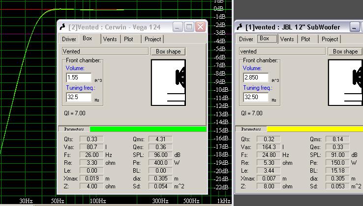

that should be fine..i sorta gotta a similar setup myself
if the vega 12's that you're referring to are the vega 124's..
then u should be fine..
i got 2 jbl 12gg01's sub's underneath my desk pounding quite well....
and as u see by the attached pic... the 12gg01's and the 124's
in winisd pretty much have similar responses....
vega 12s
yes the 124 Single voice coil
i emailed cerwin vega,and they said that ''u may have good results''
lol its abit risky but its the best speaker around .
well il have an awesome car sub anyway for sure!
