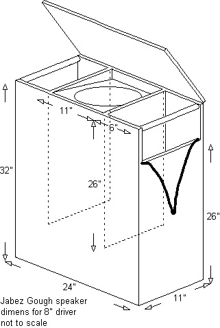

It could probably be seen as resembling any number of enclosures. Certainly there is the potential for many resonances. Perhaps the diffuse sound helps to incorporate these into something useful and good to listen to.
i don't have an OS for hornresp, but you can see the pipe's first section is ~775 sq.cm. 2nd section ~580 sq.cm. The dual exits are close to the driver and the lid effectively adds a bit of length to the path. It's an attractive looking cabinet being reminiscent of phonograph from its day.
With a 66cm x 2 path length, the 1/4wave frequency is 64Hz, so you could call this a TL. But closer to a straight wall double expansion BLH.
im in doubt looking it as a transmission line, because the tube sectional area is much bigger than the cone area....its not common in TL as i have seen...it make sense?

It’s a resonant aero-acoustic device that’s for sure. Calling it a TL vs a back loaded horn etc doesn’t change fact that it will have a resonant frequency around 60Hz based upon the path length. When I model this is Akabak it’s all a “waveguide” element, the building block for TLs or horns or waveguides. But I would say it’s closer to a BLH.

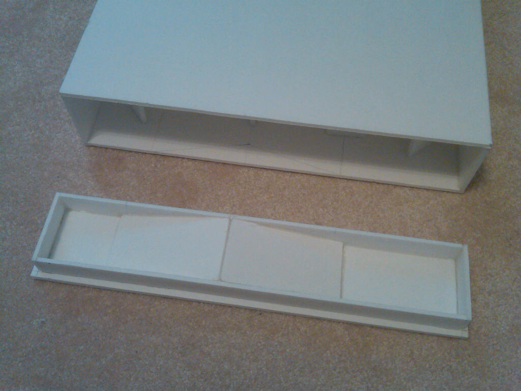

It also reminded me of my Flat BIB or FIB speaker which is a BLH with two exits up.
Here is the bottom piece:
Assembled from the front:
The Karlson slots will reduce the effective pathlength and bass extension will be lower. For the frequencies involved here I don't think the issue is needing a K aperture on the bass BLH output. The K aperture has more to do with acting as an acoustic lens from 300Hz to 1kHz range.
