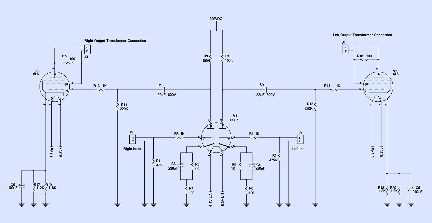

1st pic is supposedly the Crack (OTL)

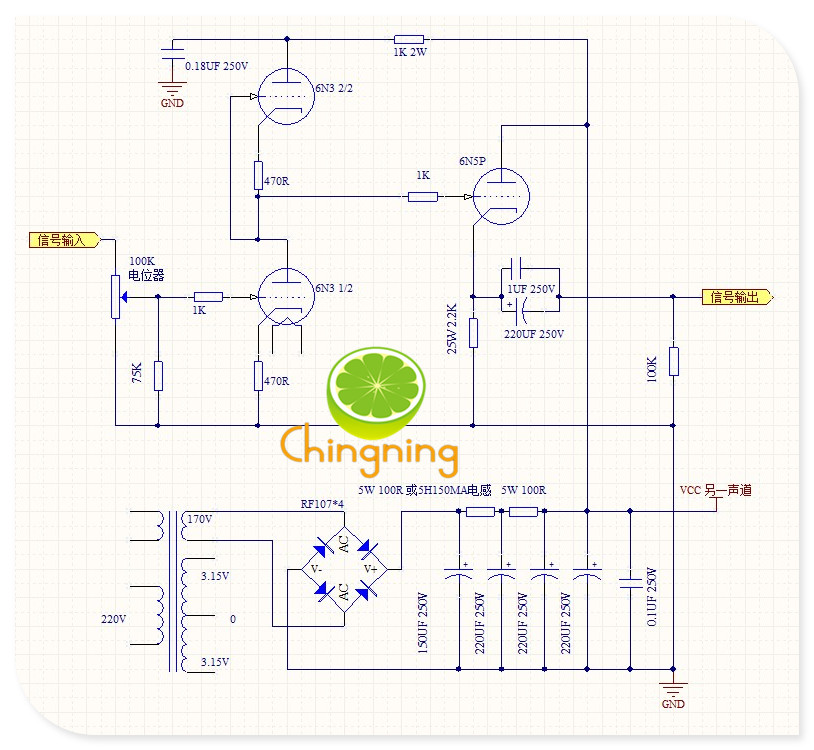

2nd is one of the few generic amps I could find on Aliexpress which has a transformer and comes with a schematic

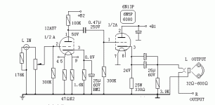

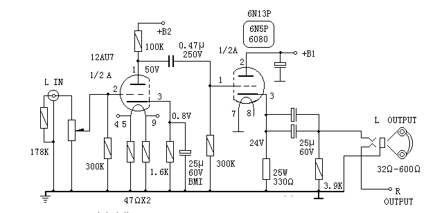

3rd looks similar and uses the same tubes but I don't see the transformer

I can't comment on the quality of the various kits.
But you have to factor what else is included in the price.
When you buy the bottlehead kit you know exactly what you will get. A known product, known schematics, known parts and the backup support of the bottlehead forum etc if you have issues.
If you buy the Ali Express kit, you get unknown parts, probably schematic only with no build instructions and most likely little or no after sales service/support if you have issues.
You might get lucky and end up with a quality product at a discounted price. But you might also get counterfeit parts, parts that don't match the schematic, circuit board issues etc.
The Ali Express kit is a calculated risk. If you are a confident builder and you think you can deal with whatever comes it could be a great buy.
If you are less confident then the certainty and support of the Bottlehead is probably worth the extra money to make sure you get a quality result.

No way the 1st pic is the Crack. Wrong tubes to start with. The Crack is extremely similar to the Van Waarde of headwize: A Single-Ended OTL Amplifier for Dynamic Headphones. – HeadWize Memorial
The 2nd has a different input stage but is rather similar for the output. The 3rd has a more similar input stage (with too much gain though with the cathode bypass cap, absent on the crack) but the biasing of the output is different (in my view it makes more sense actually). Still it should be the closest.
Edit: and all the above by Sadface is true.

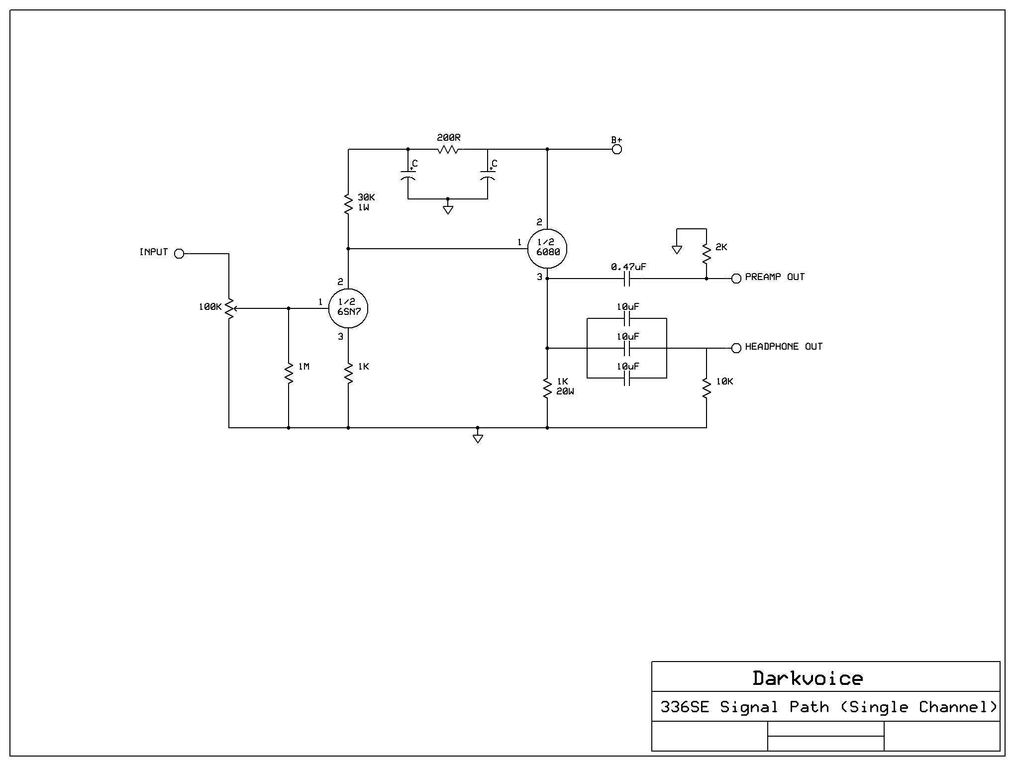

The only amp on aliexpress which has OTL in its name is the DarkVoice, but it comes with no schematic and no circuit pic...
In reality you can find schematics for the Darkvoice from some "modders"...the circuit is very basic with the power tube thrown almost to its limits (very low cathode resistor). How does it sound I don't know anyway...

It measures terribly according to this review.

Having built half a dozen Cracks, and had a Darkvoice across my workbench i can assure you there is no comparison between them.
The Darkvoice sufferered from a lot of hum from the heater circuit, ended up converting the 6SN7 heater to DC to fix it. The operating point of the tubes is questionable, they run far too hot, as is the rest of the circuit design. The HV power supply for example has a ludacris amount of capacitance, something like 3300uf at 250v which is completely unnecessary. Dont waste your money unless you are prepared to fix its problems.

keep in mind that I see complaints about hum issues so you may have to change the heating of the smaller tube to DC to get it silenced. And someone already suggested that the cathode resistor may have to be increased a little as that output tube is running hot.
And don't plug in your <32 ohm headphones, this is meant for high impedance headphones.
