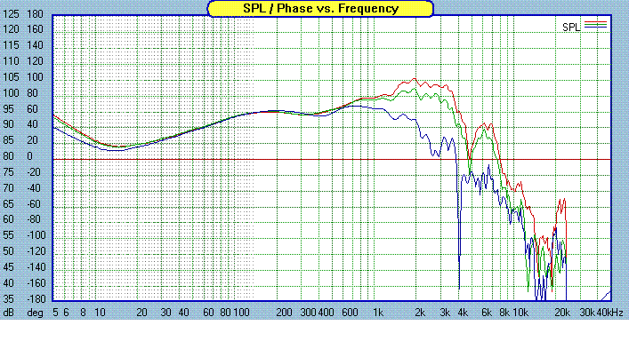

Here is measurement 0-20-40 degrees of th15x:
http://sites.google.com/site/drivervault/driver-measurements/15/ae-speakers-td15x/frequency-response

Thanks for the links to the measurements! I may be reading the graphs wrongly, but the TD15x does not seem to have less beaming than the B&C 15" driver also reported. Please correct me, if I'm wrong, though.

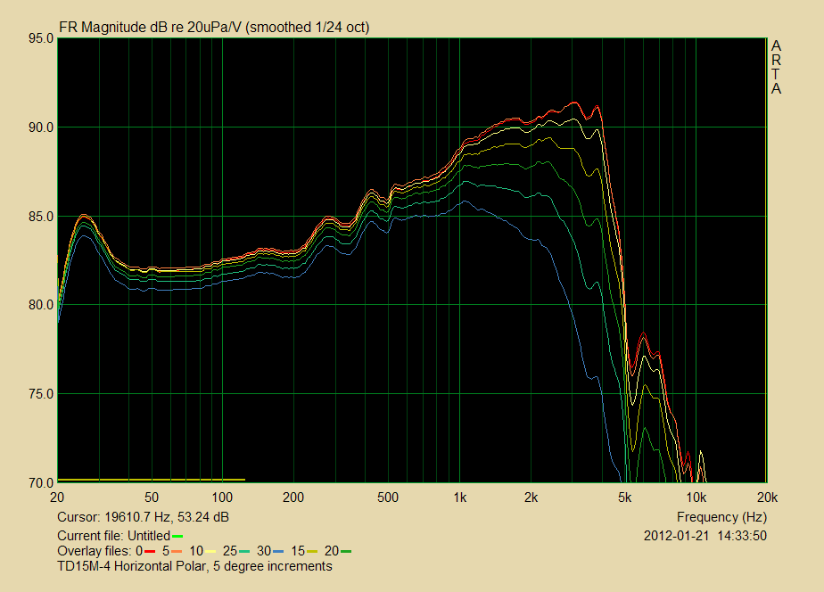

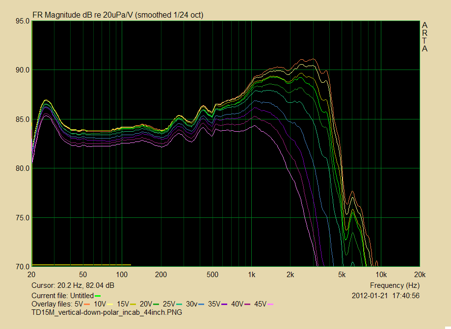

The TD15M has a different cone profile than the others, which mostly affects the (beam-ey) HF extension it achieves up to 4kHz+, but I think it also changes dispersion a bit. Here's a measurement for you. It is still a work in progress so I am not confident about the exact frequency response, but I am pretty confident about the >1kHz dispersion shown. This is on a 28" baffle, rotated around the center axis of the baffle at fixed mic distance:
And this is vertical (heading off the bottom of the same baffle, which should effectively work something like a 36" baffle, not that this should make much difference at these angles and frequencies). More importantly, this is 44" distance, while the first is 33". Ignore the bright green line:
By the way, it is worth noting that while I'm still working on my measurement technique, there does appear to be a very real rise of about 5-9dB on-axis to reach the 98dB figure, so useable efficiency is going to be more mid-to-lower 90s. If I turn out to be wrong about this, sorry for the slander, but I'm pretty sure it's real.
