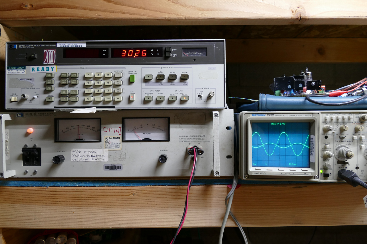

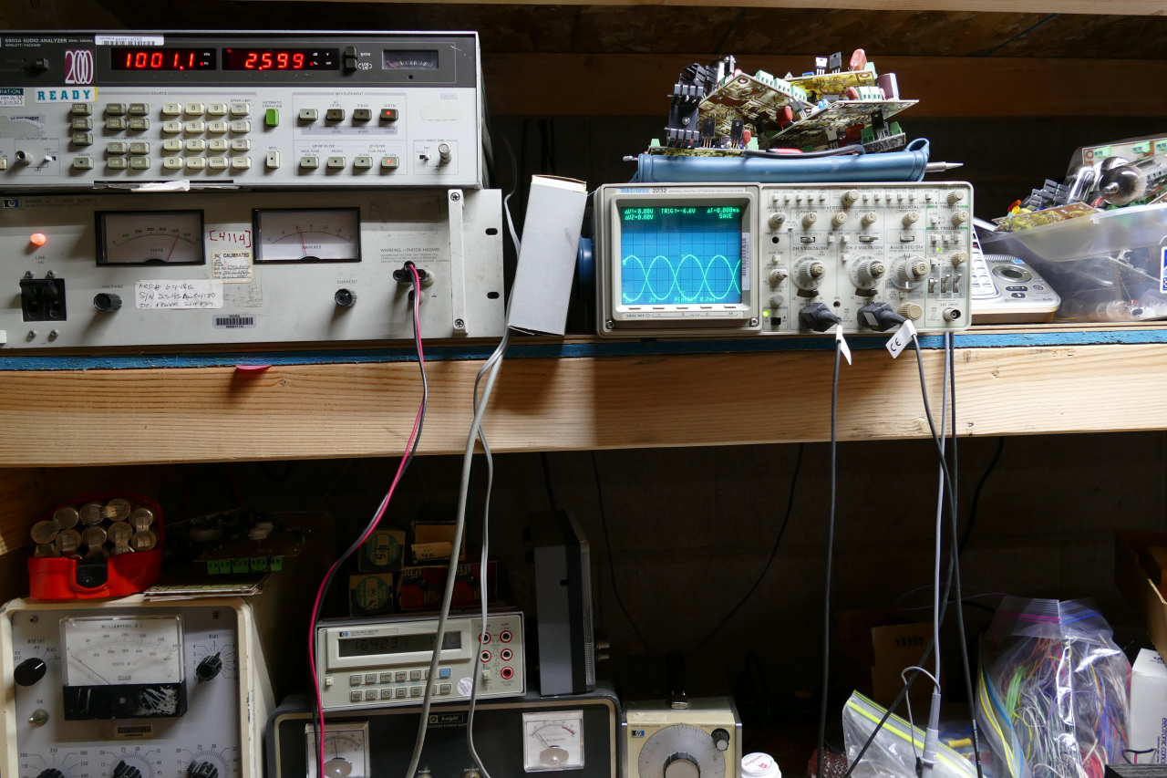

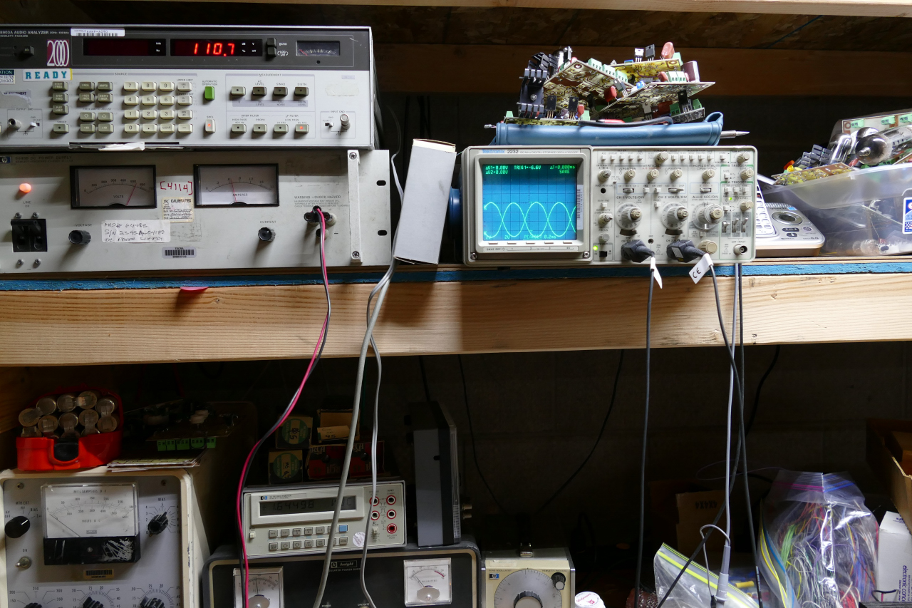

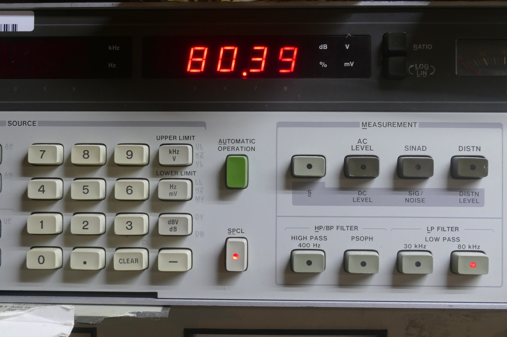

I spent quite some time twisting knobs on a pair of Sylvania 50C5's and a pair of GE 50B5's. These did best at 340 volts on the plate with a 6600 ohm load. The screen voltage was 150 and idle current was 15 mA for an idle dissipation of 5.1 watts. Of course I'm over the 5.5 watt spec before I make 1 watt...….but wait, there's more. How much more?
Remember my arbitrary 10 watt per tube plate spec......I never reached it. The 1.2 watt G2 spec is the limiting factor.
The GE 50B5's make 30 watts per pair at 1.18 watts on G2, and 8.8 watts in the plate for a plate efficiency of 63% and a THD of 2.36.
The Sylvania 50C5's make 27 watts per pair at the 3% THD limit where the G2 dissipation is 1.19 watts and the plates are eating 9.2 watts for a plate efficiency of 60%....not so wimpy.

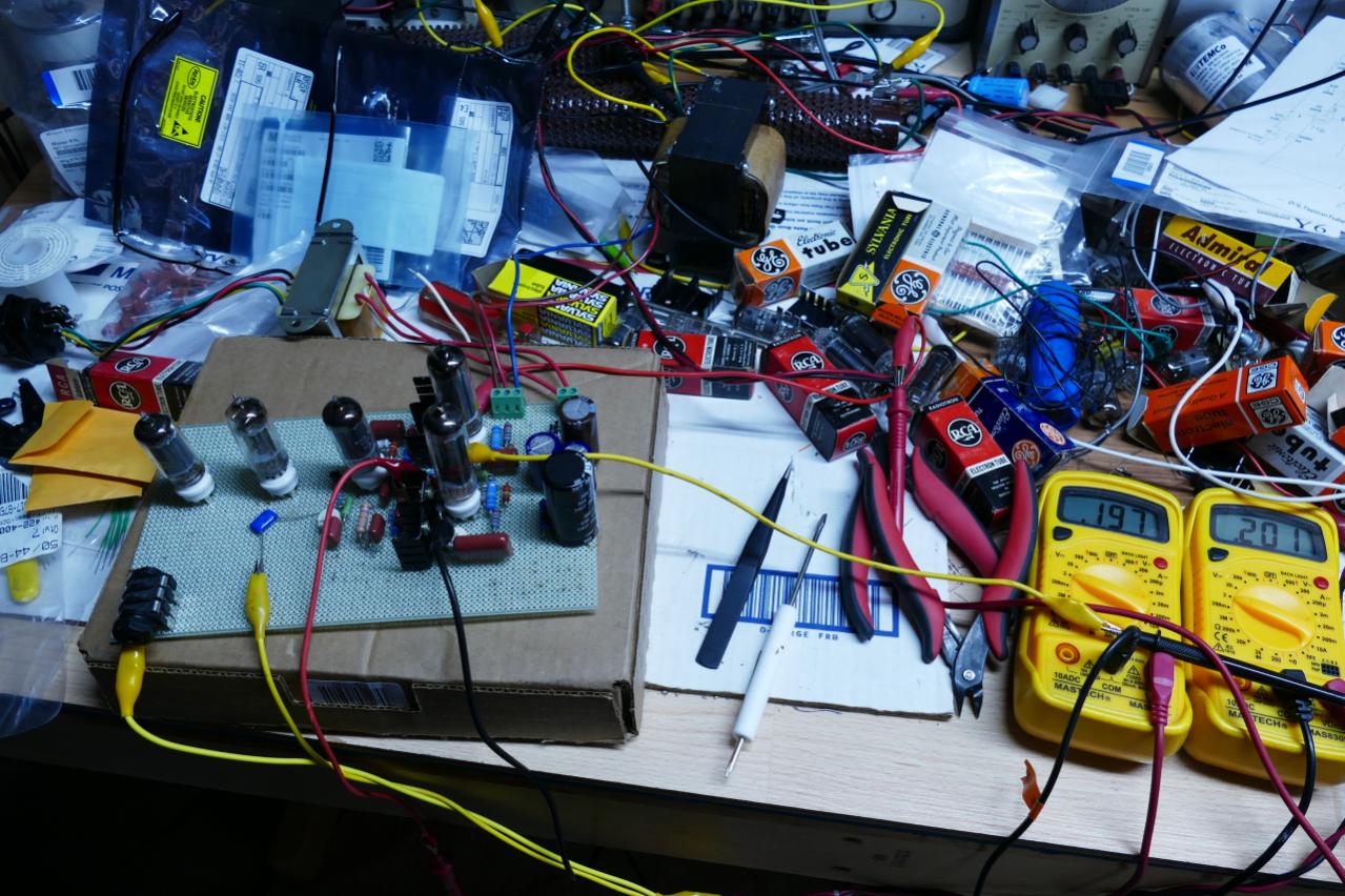

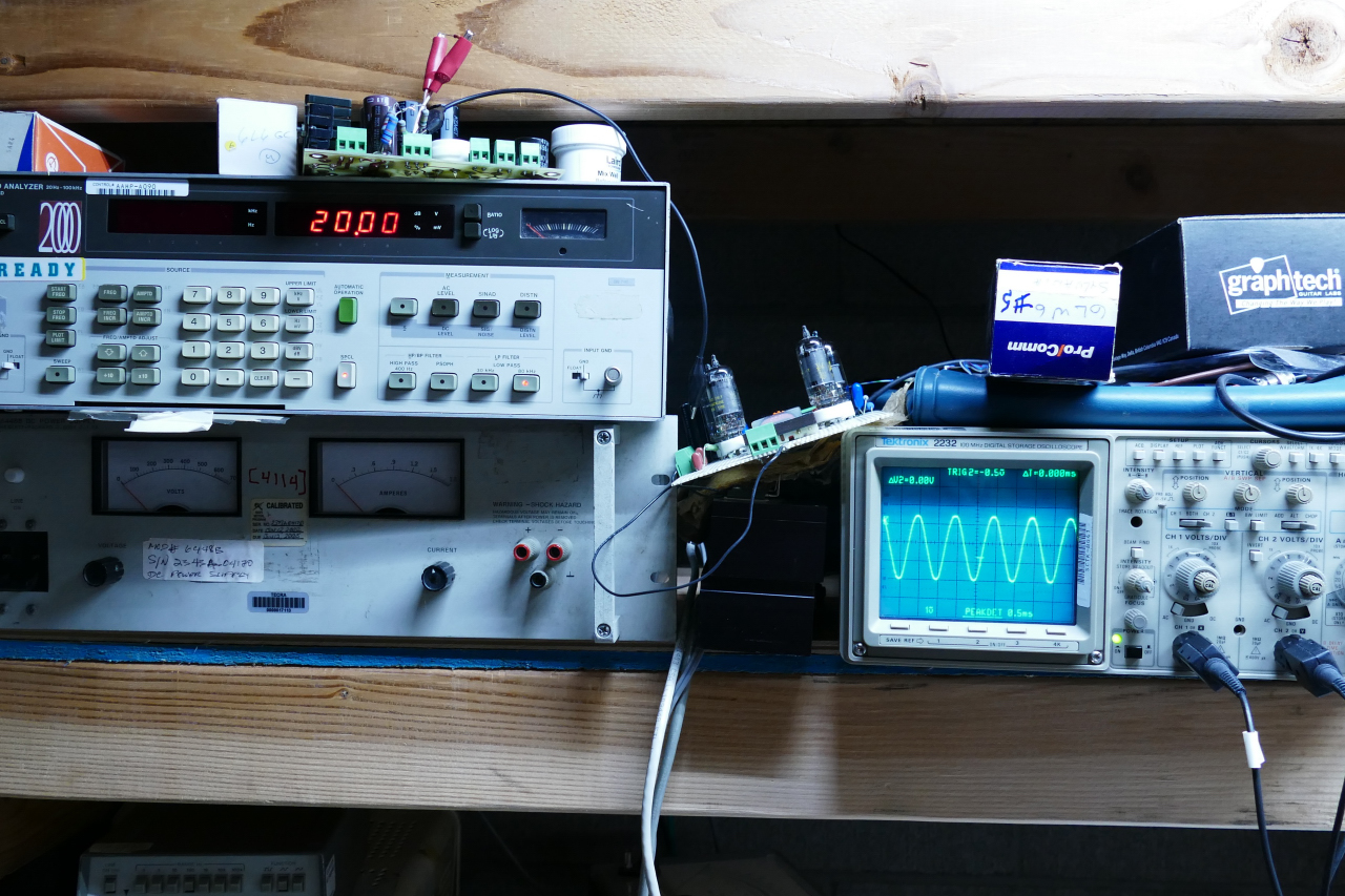

So what happens in real life. This picture is a test board that will eventually be a 20 watt guitar amp running a pair of 50B5's (cheaper and more common than 50C5's). I have abused it with a guitar at full crank with no issues, and I set it at 20 watts into an 8 ohm load and left it running over night. The next morning it was still running making 20.02 watts.

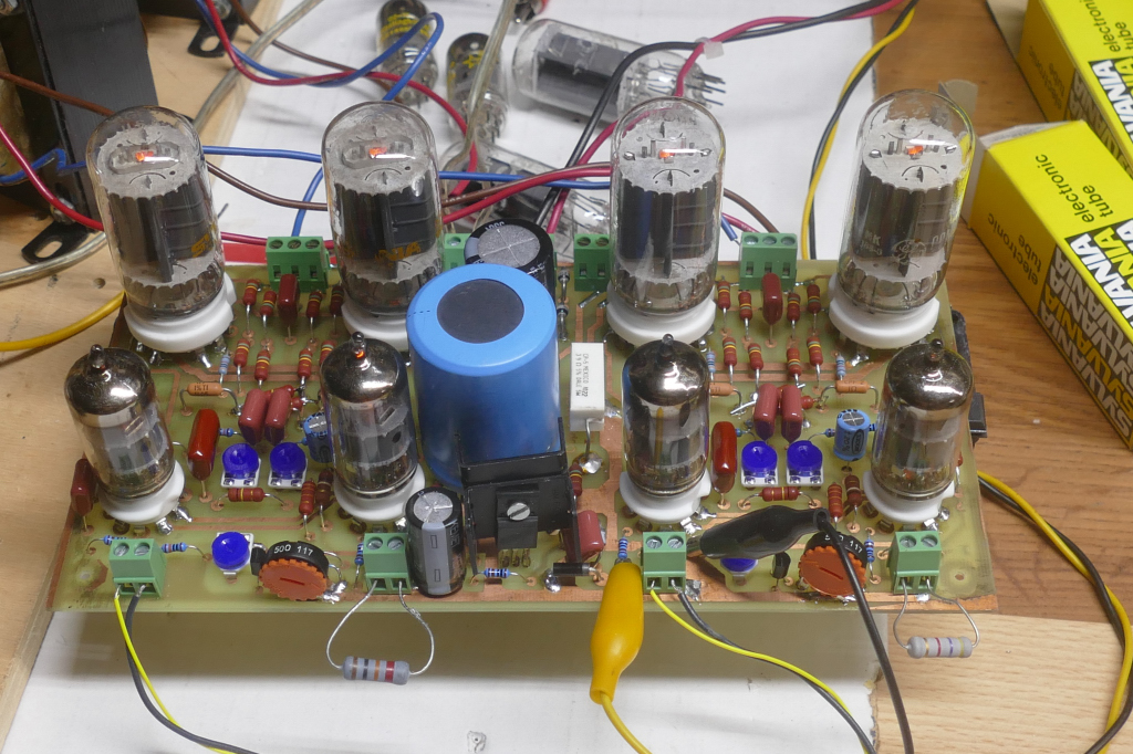

So, if you want maximum Gm for a particular purpose, use a 6EH5. Want maximum power output, use a 6CU5. I have no actually tested a 6EH5 or a 50EH5, but other high Gm tubes have not equaled the 50C5 or its octal and 9 pin equivalents. The little 6W6 will do nearly 40 watts per pair, but that's a different story.

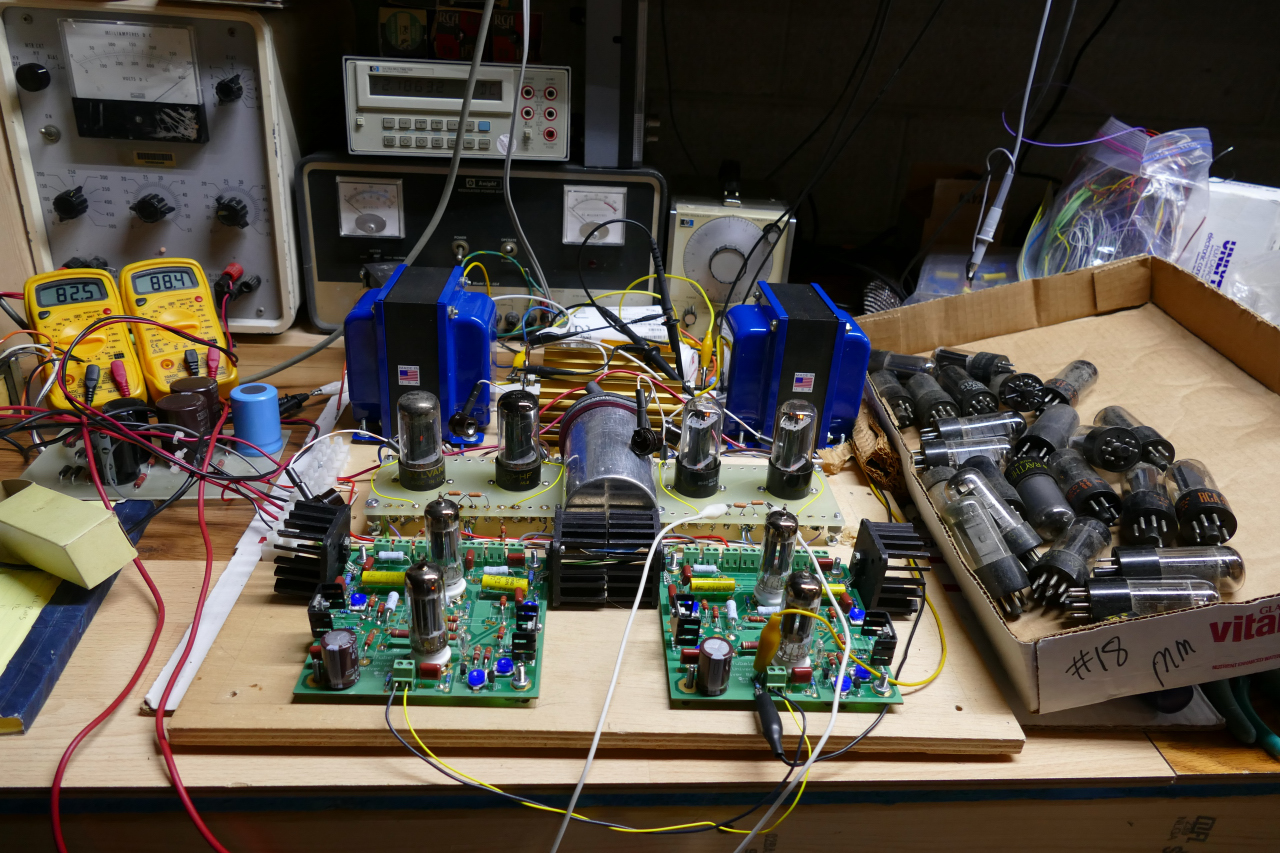

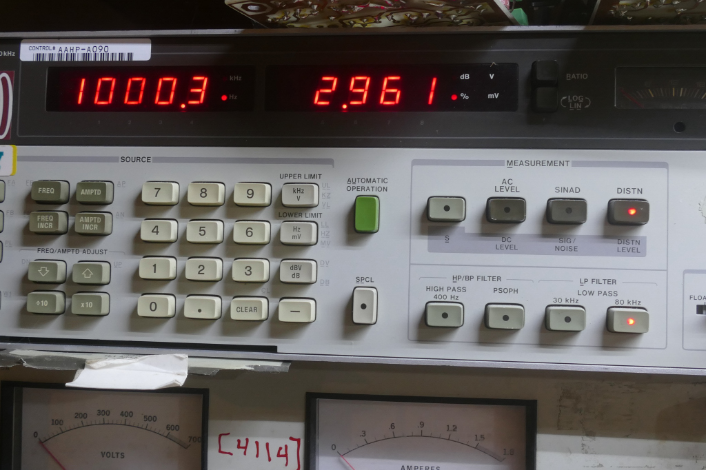

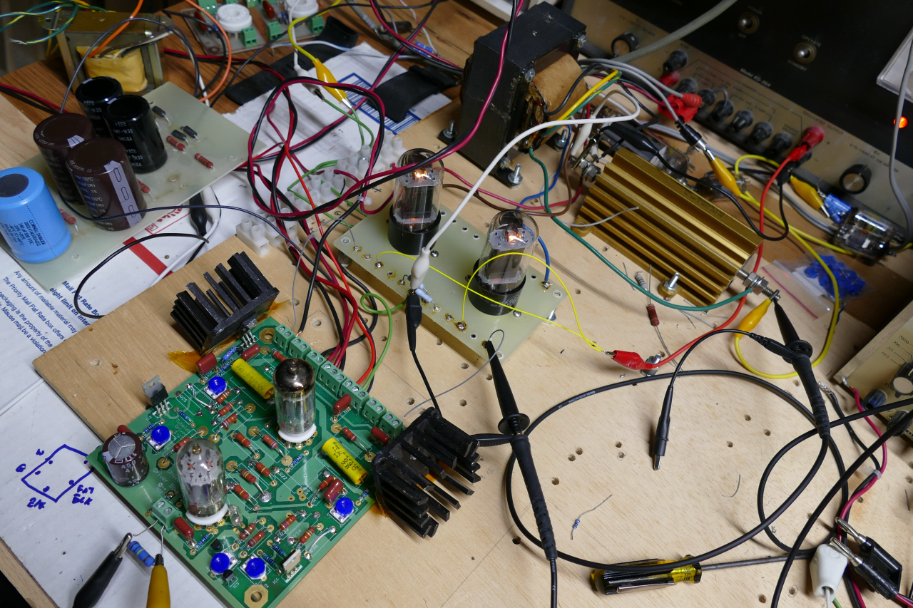

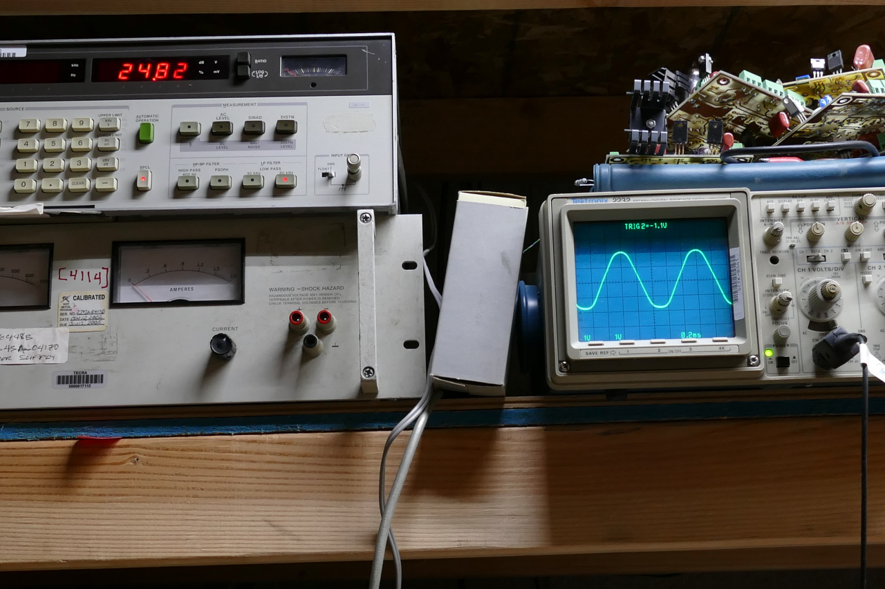

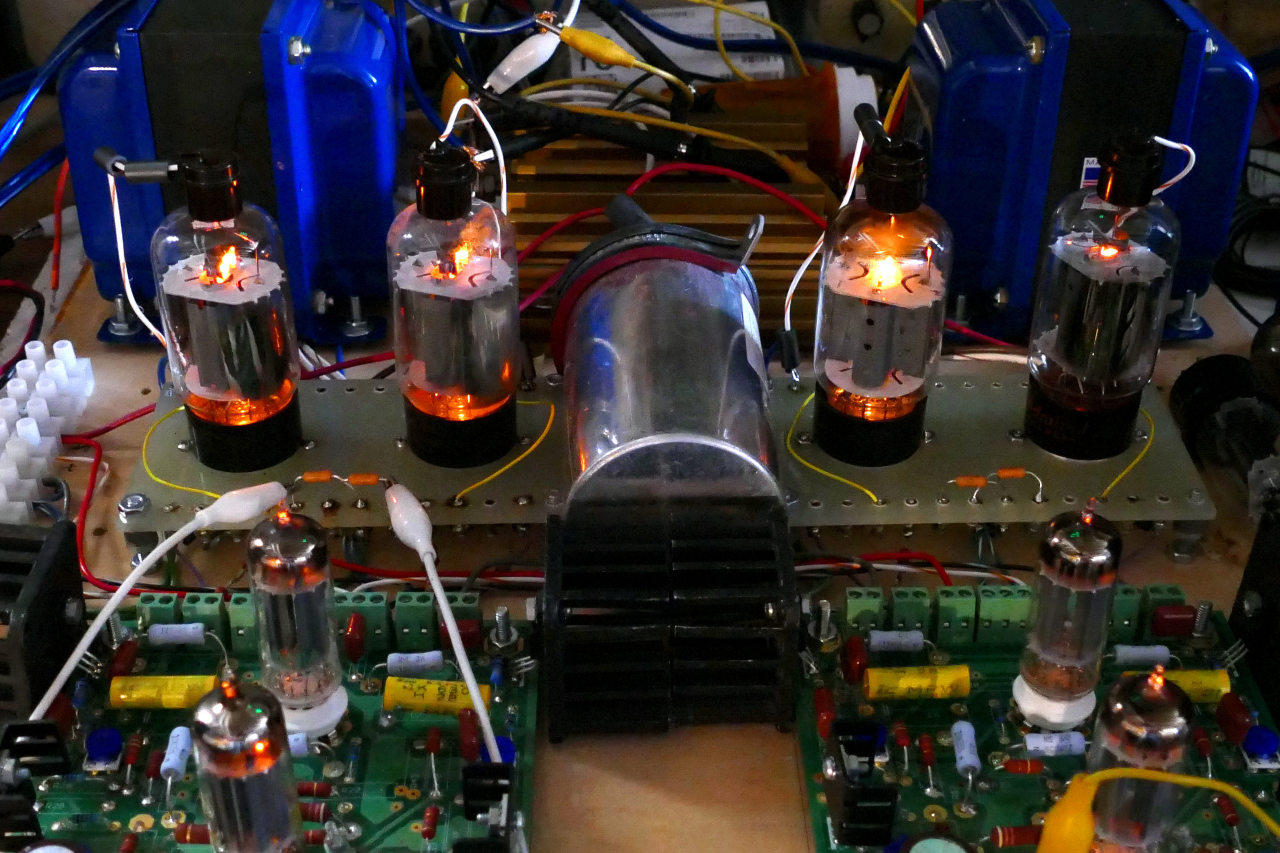

Here are some pictures of a pair of 25L6GT's cranking out 30 watts at a rather benign 300 volts of B+ into a 3300 ohm load. I later figured out that I got more power with more voltage and a higher load impedance.
I also wired two pair of 6W6GT's up in triode mode and squeezed 25 watts per channel out of them. The red glowing spot in the middle of the leftmost tube in the dark picture is an artifact of the camera since it is looking through the little window in the plate directly at the cathode. The plate is not glowing.
The 6W6GT, 12L6, 12W6, 25L6, 25W6, 50L6 and 6DG6GT are all the same tube except for the heater voltage. The 35L6 is a different tube with a wimpy cathode and the 6L6 is a bigger audio tube.

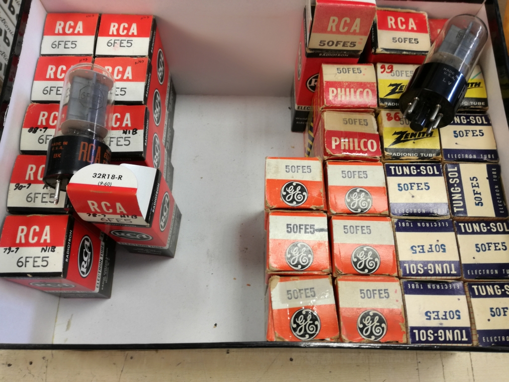

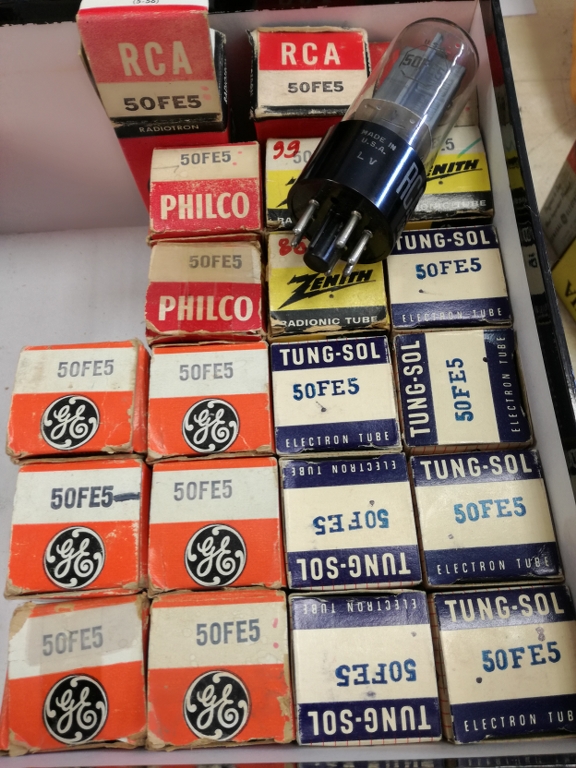

The 7695-noval is a 50FE5-octal successor with 50V / 0.15A heating (such as the 7695-noval, 6FE5-octal successor with 6.3V / 1.2A heating) with almost identical published manufacturer data. With 50FE5 tubes I have positive experiences in working with low voltage amplifiers, so although I have a smaller stock of 7695 tubes, it is a very useful fact (thanks to the smoking-amp) that they are very similar to 12GE5 / 12JN6 (6JN5 / 6JN6).

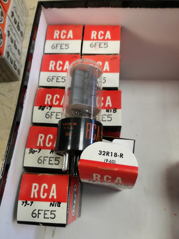

I have never seen a 6FE5 or a 50FE5. I have the data sheet, so I must have found a reason to look for it at some point. They don't seem too common here.
A 6GF5 would likely be very close
Now that's a tube I have explored for almost 60 years.
The 6GE5 IS a 6DQ6 in a 12 pin Compactron bottle. The 6GF5 is a 6GE5 with it's plate fins trimmed so that it will fit in a skinny Compactron bottle. All three seen together here. I have found three different constructions of 6GF5 all with a different height. All can make big power, 80 WPC. Real big for a "9 watt" tube. The fat boy 6DQ6 and 6GE5's can make 100 to 110 WPC in a convertional circuit like Pete Milletts Engineers amp. The last 3 pictures show a set of 17DQ6's pushing the meter to 110 watts at 2.5% THD.

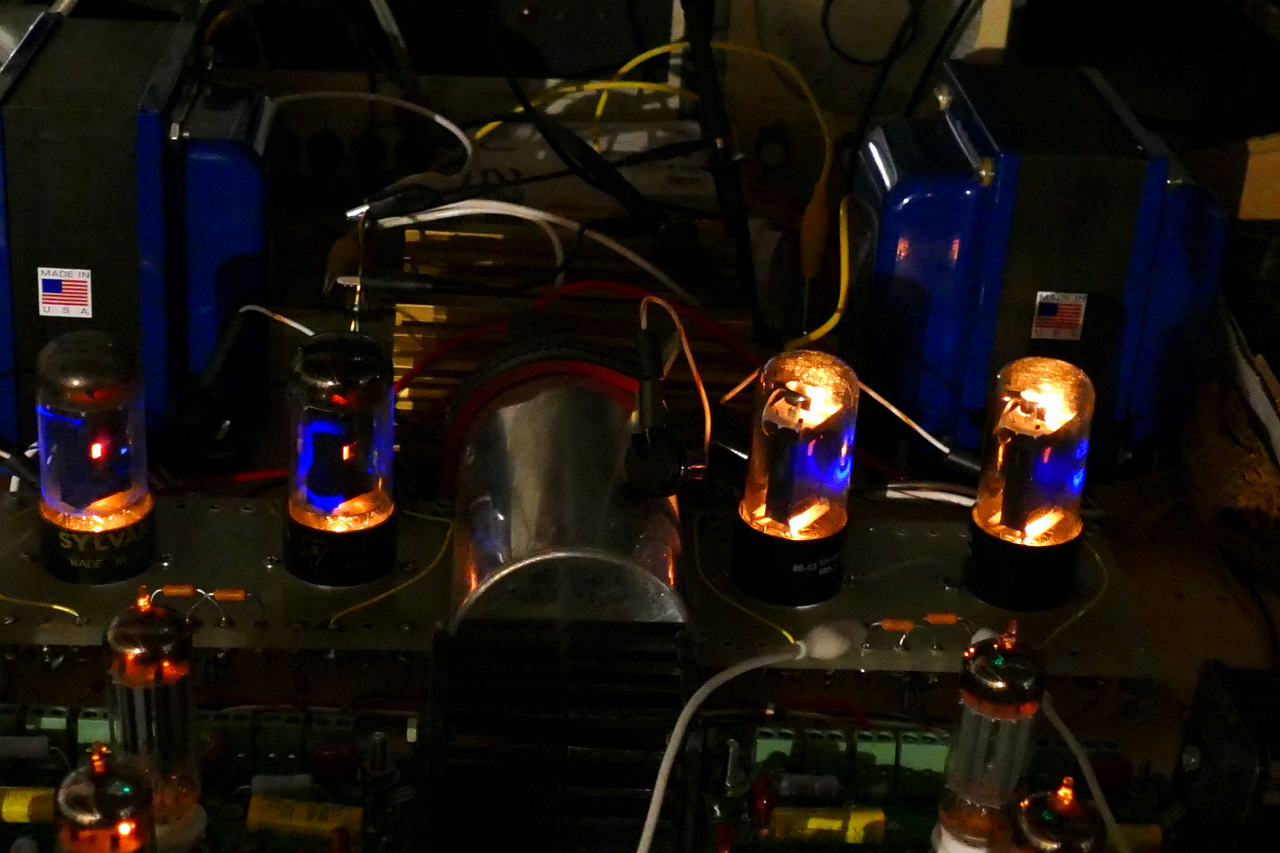

Fast forward to 2018 and we have 4 X 6GF5's and 4 X 6KT6 ($8 worth of tubes) cranking out 80 WPC at 3% THD.
The output stage used here is a unique design that I'm working on. It will be tested with some monster sweep tubes soon for BIGGER power. The phase inverter seen in this amp uses a similar design, but I'm not happy with it. I made a better design for the 50C5 guitar amp, and it is being scaled up for a bigger version.
