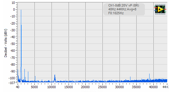

Hi all,
This FFT is also an excellent outcome reported to an amplifier
in class D.🙂
Yes, it might be good for class D, but -86 dB 2nd harmonic at 1 kHz is at best low end for class AB.
yes, this is not very good for audiophile performances but... see full spectrum please. this is a good commercial audio amplifier class D,300-400w(4R) with PSU on board. you can see FFT at 1KHz from annother amplifier, spectrum is full of harmonics. very clean output has to work very hard.
many harmonics affecting the upper audio frequencies to listen, the voice is as shrill.
I not see clean FFT of others Amp, as the A-B class.🙂

The fft which I put on this thread is produced by the instrument hardware (National Instruments) with on-board DSP big.
128K FFT (I can set up to 512K/point)
24bit AD / DA. up to 200Khz.
But at this point after seeing many datasheets on amplifiers (they all seem cool), I only believe in what I measure myself.
