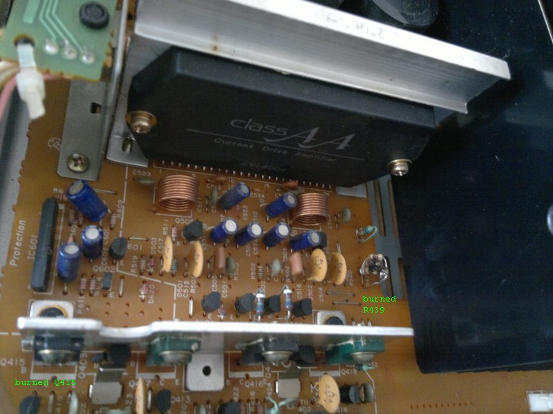

... or should I use its parts for example Krill🙄
I bought it failured, but visual mint😀
for now R436, 438 and T411 are burned,
I do not know if other parts are OK😕
Does anybody hear this amp and recommend its sound?
Please indicate what might be the purpose of burned parts?
sorry for inconvenience
R439 and Q415 are burned, this time R435 survived...

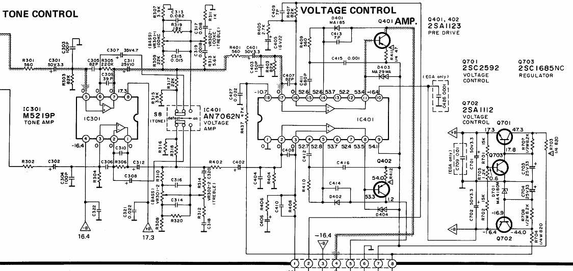

I found that AN7062 is broken
I ordered new one
and will inform if works after soldering.
(if anyone interested...?)
I ordered new one

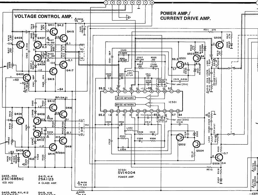

R436 burned with fireworks!
I am starting to thinking what amplifier to build inside V50...😕
The important thing is a power transformer, has lower and higher voltage taps - the preamp/voltage section might be powered with higher voltage, power section with lower...
Are the transistors in the voltage amp section ok? As r436 will blow if there is a fault in that area.
What voltage is at the emitter resistors there ?
Blowed: R436, R438, Q407, Q415,
I cannot measure the emmiter voltages now, the amp is packed and is waiting for a better times...😉

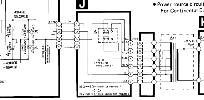

I would make one comment about the amplifier (and mine is rated 70W/channel/8 ohms). The transformer looks undersize for the job and would have to "duck" under load, since the rails are 58V. Lower rails are manually switched for 4 Ohm loads and this must have been a problem for unaware users.
Personally, I would not try to keep any parts of the power supply. It's clearly not rated for continuous RMS power output at the rating.

Tekko, I can't guarantee the same parts are involved but the transformer I refer to is an E-I type of no more than 140 VA, unframed and bolted through the chassis, like old valve types. It runs hot without load, is relatively noisy and does not inspire confidence.

Those Technics amps typically had about the same output power at 4 and 8 ohms, so the xfmr wouldn't be expected to be supersized. The sagging supply rails tend to keep the output stage transistors in their SOA and hence reliability up.
Repairing one of these units requires careful thought, patience and diligence - as with any complex DC-coupled amplifier, except that ICs don't exactly make things easier. Swapping out the obviously defective parts definitely will not do.
So Q407 and Q415 are dead... looks like this channel is latching up hard. Every single part in it should be checked. A lightbulb current limiter or variac in the power line is a good idea for power amp repairs in general.
If that big SVI hybrid should be dead, well... bad luck. I wouldn't just assume it though.

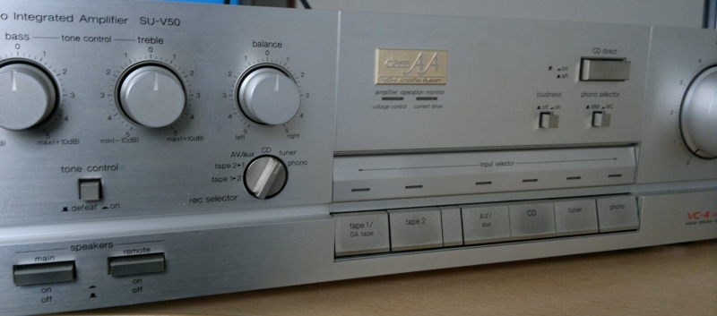

- is Technics SU-V50 worth repairing...
