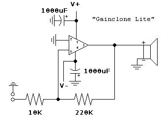

I built a pair of LM3875 "Gainclones" over 1 year ago based on the Thorsten schematic, and I have enjoyed it since day one. Just out of curiousity, I built a new channel up today...a stripped-down version. The schematic is below. Other than the cheapo 12-0-12 Radio Shack tranny and bridge, it only has 4 parts: 2X1000uf supply caps, a 220k resistor between pins 3 and 8, and a 10k resistor from 8 to input. No volume pot right now. All grounds meet at a "star" ground.
I didn't expect anything much, and a certainly didn't expect any stability. To my amazement, the "Gainclone Lite" has been running with CD music source for about 4 hours now with clean sound, NO noise, and 0.01mv DC offset.
I don't have access to a scope, but if this is any indication of stability--it's been running all this time without a heatsink! That's not intentional...I was just testing it initially, but it never really got that hot and the protection never kicked in. BTW, the chip is the LM3875TF, isolated package. I haven't really assessed the quality of the sound because it is currently hooked up to my test speakers (junk).
Is this just a fluke? I'm really enjoying the novelty of the minimalist approach, but this is almost TOO easy 😎 . Any input?

f4, my version is even simpler than yours: it doesn't have the two electrolytic caps (but I do have two in the power supply).
so mine has one chip and two resistors. (on a heatsink, 🙂). and it does run. Couldn't tell if it runs well or not. putting in two decoupling caps makes no difference but I do plan on having them there.

Hi fender4,
Let's see...
You are using the chip without a cooler and it doesn't get hot...
But I wouldn't assume that the reason is that it's not oscillating.
The reason is you're using a low voltage PSU and you're listening at low levels.
Just don't push it hard, or it will get hot.
But never near as hot as with a +/- 30~35V PSU.
With that PSU you should have around 10 watts RMS.

True, running relatively cool is a poor indicator of stability...there are many factors to consider with heat dissipation. I was pushing it "hard" in that I have no volume control, but if anything was being taxed it was the cheapo Radio Shack 12-0-12v tranny. It was warmer than the chip :bigeyes: . Things are much more civil now--the chip has a heatsink, and I'm using a passive pre for volume control. I just need to find a nice transformer.

Your suspicion is very valid...I meant to write 10mv, which is not that great. Since then, however, I have replaced the alligator clip leads with better wire and a tight layout. DC offset is now 7mv. Thanks for bringing that to my attention. 😎

You may be keen to learn that tight layout and better wire have absolutely no effect on offset. Warming up (or cooling down) the chip and changing the PS voltage, otoh, does. Either way 10mV is perfectly fine by me if you're not using Lowthers 🙂

I use a 500k multi turn trimmer between pin 7 and ground to corrct for offset.If the amp has been run in and normal operation temp. i just dial in the offset.I have found out that it will drift slightly but only about .001v.

I learn something new every day! I just assumed that the change in offset was due to the new layout, but after some reading, analog_sa is correct in that this probably didn't have any effect on the offset.

500k seams too high, you'll have difficulty in tuning for 0mv.
I use 50k multi-turn trimmers and can easily get 0.00 mv.
