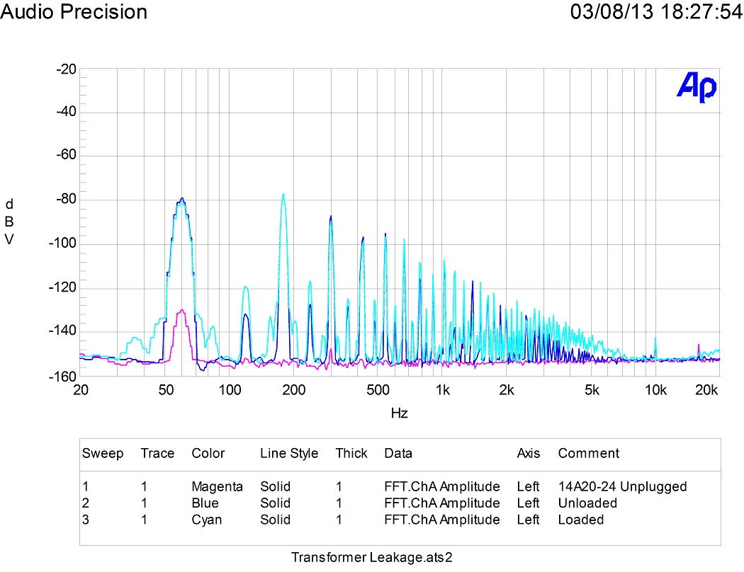

A good question. I did measure leakage flux for a bunch of transformers a few years back. If I find the data I'll post it. I did show it in the blowtorch thread for anyone crazy enought to try and find it there.
Attached are the measurements from a split core transformer (14A) and an over under (PC). Both Signal transformers. Note the mounting position differences! The PC version flux leakage has much better coupling into the test chassis on other measurements.
My read is that the less the flux coupling the more the leakage but it is directional.
Directional fits with the advice to experiment with rotating a transformer to see if the hum field effect on a nearby circuit can be minimised.
