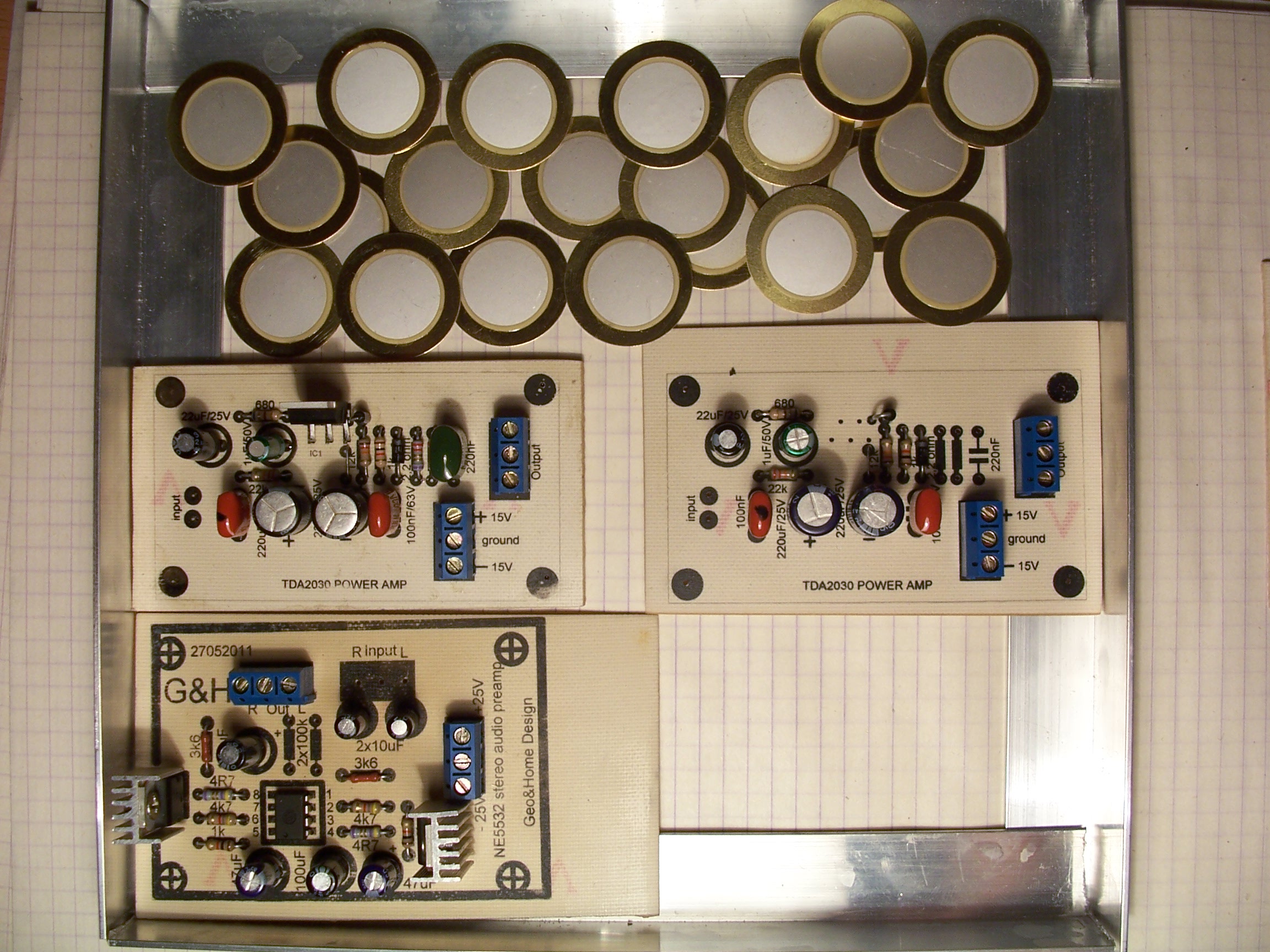

I also have a couple of 43KHz piezo tweeters. How are you going to power them and generate the signal?

In my case i want to power them with two TDA2030 based amplifiers, as you can see on the photo on my first post. That should gave me about 40W. Also i have builded an preamp with NE5532. The generator is based on NE555, i have one with fixed frequency on 44KHz, and another one with variable frequency. The most important, i dont know if these piezo's can vibrate on 44KHz. Also the container is very important, i think with variable oscillator is better to try because I can look for a resonance frequency of the water container.
If you have a good sound card You can generate the 44KHz using software like Cool Edit.
BTW, i still dont know what is the desired shape of the signal of 44KHz for sono cleaners, if it should be sine, or square?

I just find out the characteristics for piezo's i have.
Frequency 4,2KHz
Impedance 300 OHM's
Capacitance 24nF
From my experience they can produce much higher frequency. To get 8 OHM's i should connect 40 piezo's in parallel to the output of TDA2030.

The impedance at ultrasonic frequencies is not going to be 300 ohms! Working off resonance, the efficiency will be low. You need ultrasonic piezos to do this correctly.

Thanks, what should i looking for, as You said I need ultrasonic piezos, can you tell me more abt?
Thanks for the link, minimum order 25 peaces 🙂
I have already build a small cleaner with 7 piezo (4,2 KHz) and it works on the frequencies above 20 KHz, the shape of water container is round, and with 1cm of water it works ok, i have already cleaned some metal things.

Ultrasonic cleaner transducers run off high voltage sine wave.

Not so good when oscillator is an imprecise match to resonance of the transducer.
And that resonance can be very narrow...
Best bet is let the transducer be its own frequency reference.
Pretend its a clock crystal. See: Pierce Oscillator.

Maybe the variable oscilator could be a helpfull approach to reach the resonance frequency of an particular transducer.
