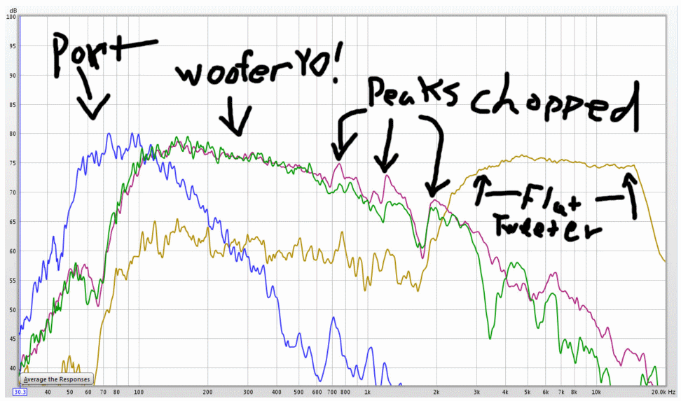

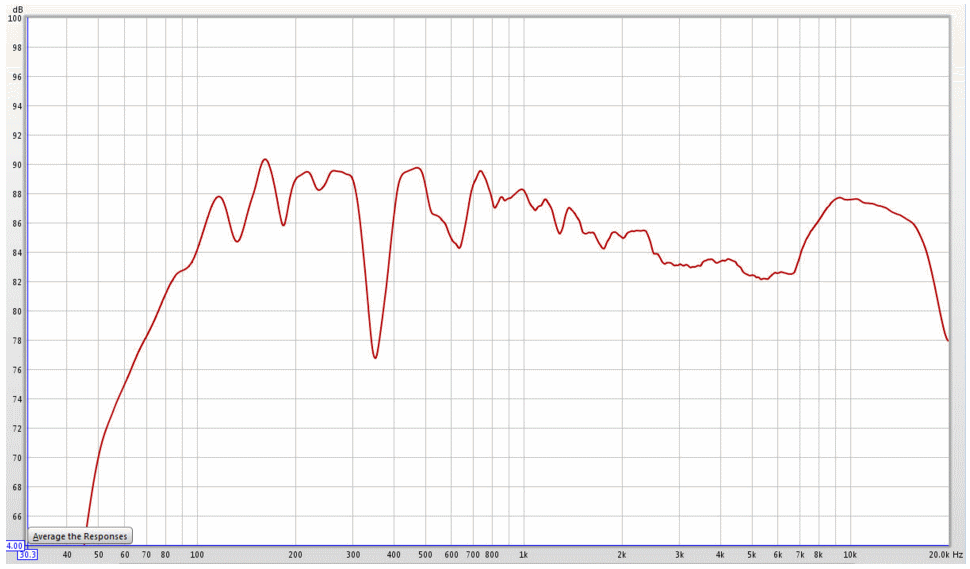

I hope it's alright to copy the plots from nonaudiophile website. If there are any copyright issues, I'll appreciate the moderators help to remove them.
In the first plot, the woofer and tweeter are crossing at about 2.2kHz acoustically.
In the 2nd plot, which is the summed response, a huge chunk of frequencies are missing from 2.2kHz to 7kHz. This indicates severe phase cancellations.
Hopefully, when the tweeter polarity is flipped, it will restore the missing frequencies.
Even then, I doubt they will cross optimally. Phase cancellations will still occur due to the difference in acoustic centers of the woofer and tweeter but the summed response should be much better than what is shown in the 2nd plot now.
Thank you, that was enlightening. So either this is Infinty's design choice, or the review copy is wired wrong.
In the review, the speaker sound like plenty of bass and treble but very little vocals. In fact, the vocals don't stand out at all.
If your speakers sound this way, chances are they left the factory like that. I don't think it's bad design on the part of Infinity. More like bad QC.
