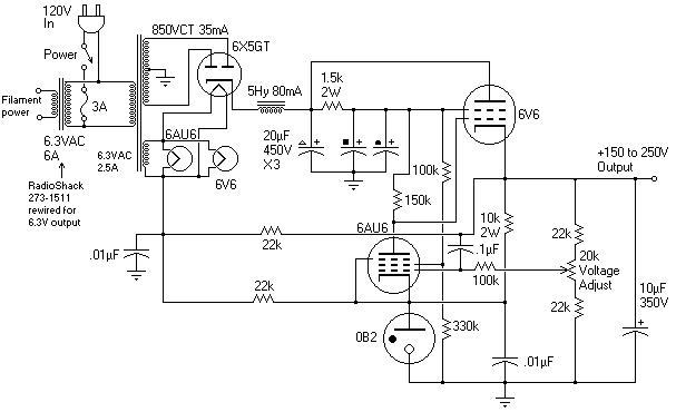

i couldn`t find the particular circuit you were refering to but would this fellow work?
Better to use a darlington HV BJT than a MOSFET, as the constant forward base voltage (1.2V or so) holds it square over the zener diode, as opposed to the pretty solid but still slightly squishy MOSFET transconductance characteristic. Or add an error amplifier to the MOSFET. Or do the exact same with tubes. 😀
(Something like attached)
Tim
